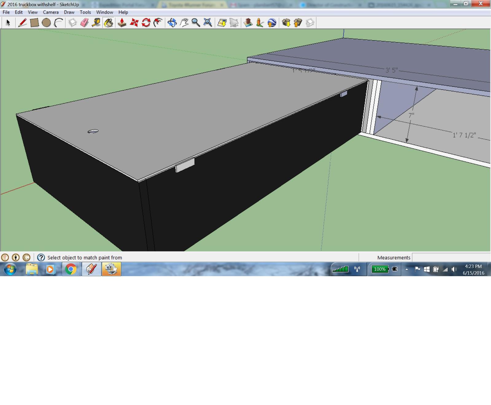

So, using your sketchup file (thanks again!), I modified it a bit to include a 'table top' for one of the drawers. When camping, I'm always wishing I had a tailgate or some flat surface to stand by and work / cook. I bring a table now and have to unload and unfold it. Why wouldn't this work?
It's a simple removable piece that would stow in the drawer (on top of the contents of the drawer). You remove it to get stuff out of the drawer (say, your stove or cooking utensils or whatever), replace it, and then work on top of it (with the drawer out and hanging out the back).
Thoughts?
I like the idea...except my thought was to cut 1/8" aluminum the same size as the outside of the drawer top (minus 1/8"), add some small 1/2" x 1-1/2" x 1/8" stops to the outside of the drawer, and lay the aluminum right on top. Easy to clean, heat resistant, strong, and light. I also would slide it under the drawer when not in use. (you might have to affix another small plate if it tends to move. I'd be sure to round the edges of the brackets to prevent snagging.
I'd leave the inside as open as possible...it fills quickly. You may also have to think about a small hold open option(something as simple as a removable pin in the side)

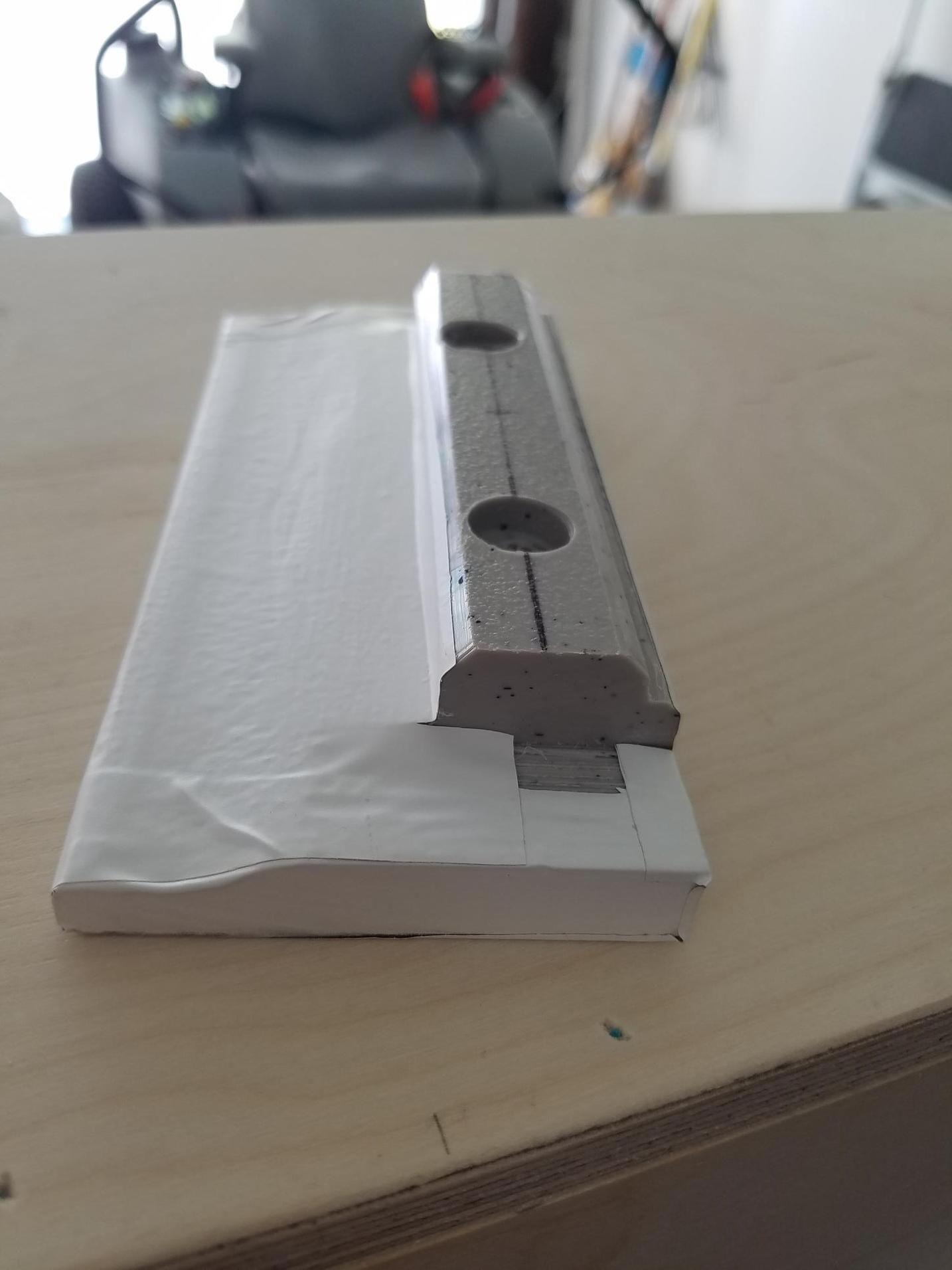

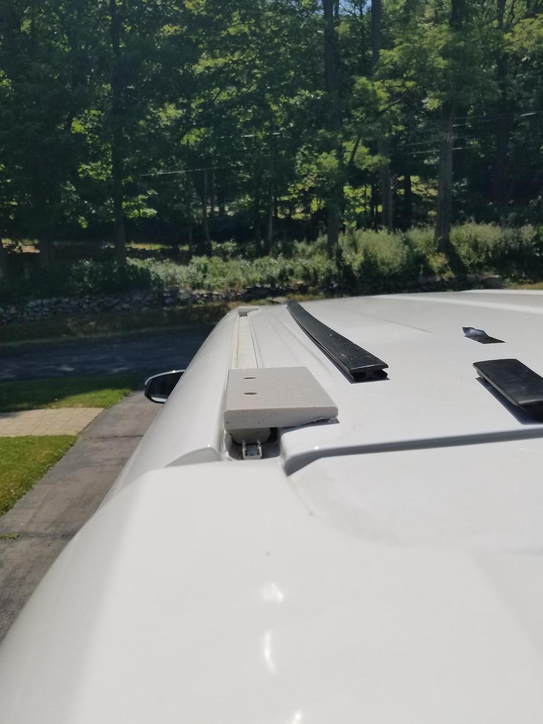

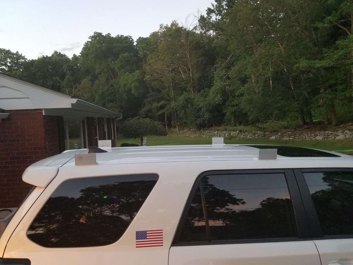

Had a little time, so I started cutting out some blocks of Star-board to act as a "foundation" for the aluminum feet for the new rack.
Once the silicone sets up...I'll start cutting my aluminum 1/4" angle and getting it bolted down.
At that point, once the angles are set (and deemed waterproof)...the slashing and crashing of the rack pieces can begin. Solar panel and awning are waiting patiently in the garage.

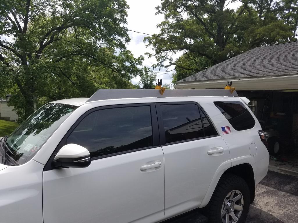

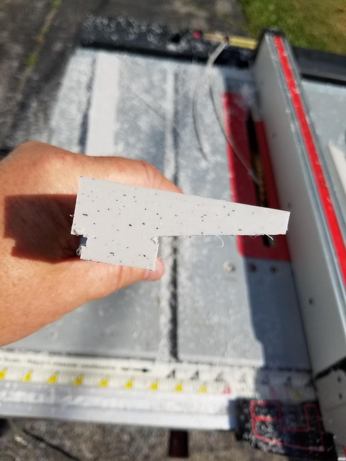

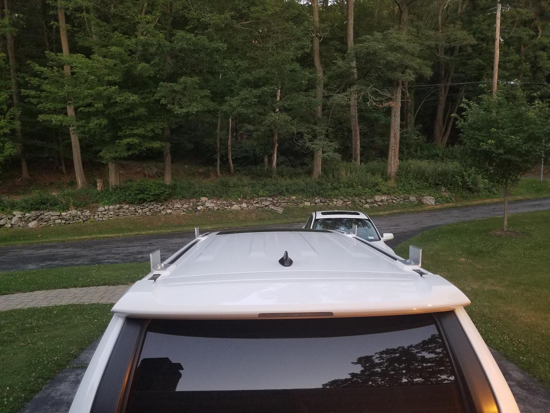

So I started with some scrap, trying to experiment with angles and design criteria, knowing water has to bypass and be able to drain. Another thing that I felt was important was fitting the contours as much as possible, to avoid a scenario that happened to another member, that actually crushed the sheet metal on the roof. The front part of the roof actually has more contour than the rear. A little extra time with a block plane and belt sander helped. Everything was bedded in silicone.
Before setting the blocks ....I wrapped them in white 3M vinyl, just to make them a little nicer looking.

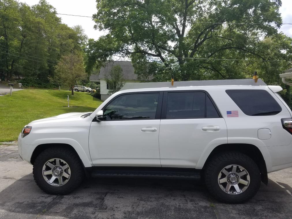

A little more progress..

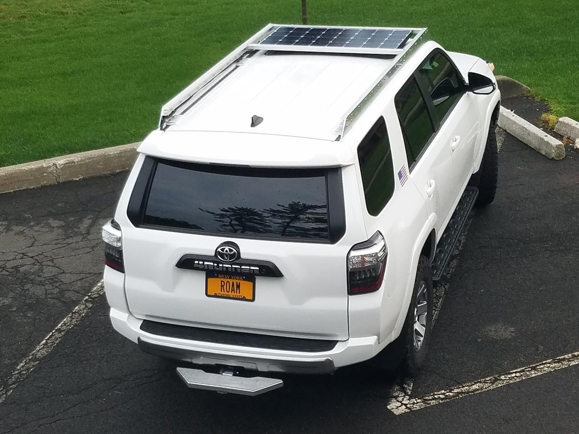

Got the solar panel mounted and hooked up yesterday...hot as balls all day. Also started a foundation for my nephews house, so between running back and forth down the street with the excavator, it was slow going.

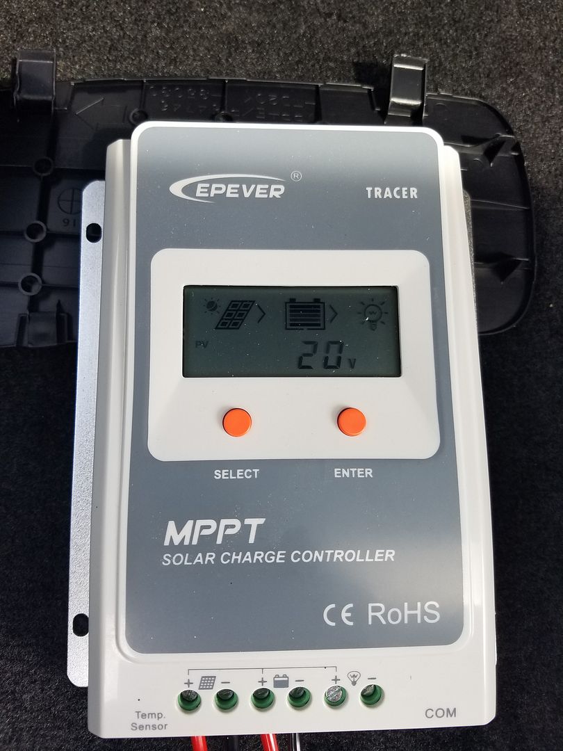

Right now the controller is lying in the back, just to see how it does, and is not wired in. It was putting out 2 continuous amps with clouds and minimal sun...and my battery would usually drop to 12.3 by the end of the day, is now holding at 12.9.(the controller says the battery voltage is at 13.8, so I'll have investigate that further) That's with the windows up, and it's pretty hot in the truck. I'm guessing full sun the panel will put it at well over 5 amps.

I had originally went ahead and used a 5 amp fuse in the solar slot...thinking it would never put out 5 amps, especially just lying flat, and not angled at the sun. Went to check to see what the amps on the controller were when I hoped in the truck at 730..and the controller is reading zip...I was like wtf is going on...crapped out already?
So I checked the fuse and sure enough it was blown. Today is much more direct sun, and the the panel is cranking out 5.5 amps, and they battery was as high as 14.2 V's when I checked....it's finally getting the juice it deserves! I replaced the 5 amp fuse with a 10amp.
