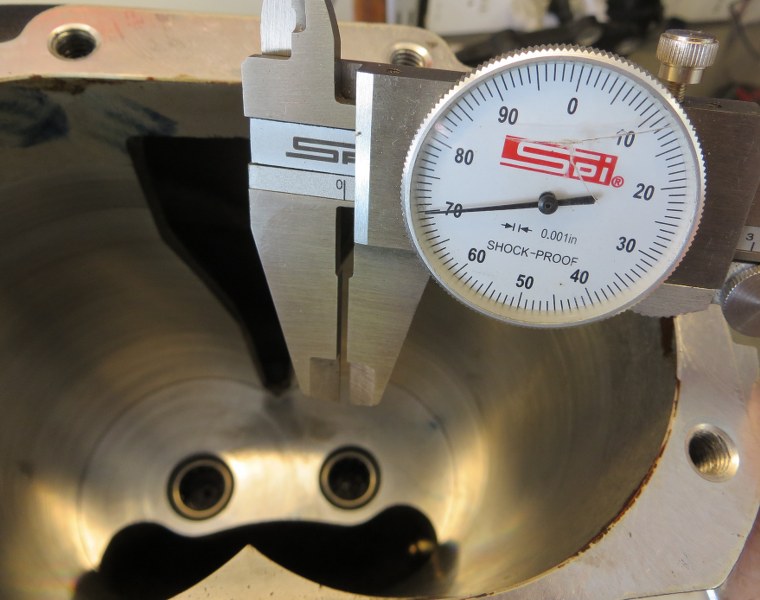

so there wasn't a good way to make sure the new ones were pressed into the correct depth.
For what its worth, I measured mine (2nd/4th gen black): They were .070" below flush.

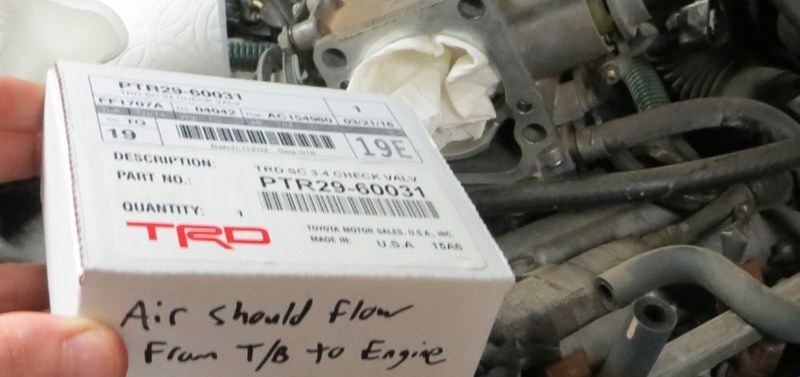

Discovered I don't have the IAC check valve. Can't get one anywhere I've looked. :confused:
This is the solution
For visibility and awareness, here it is again: PTR29-60031
Still available and costs about $8. I run this one on my TRD SC'd 5-speed.
They dont mark the flow direction on this check valve, but its easy to figure out (blow into it). Orient such that air can flow from FROM the throttle body TO the engine.

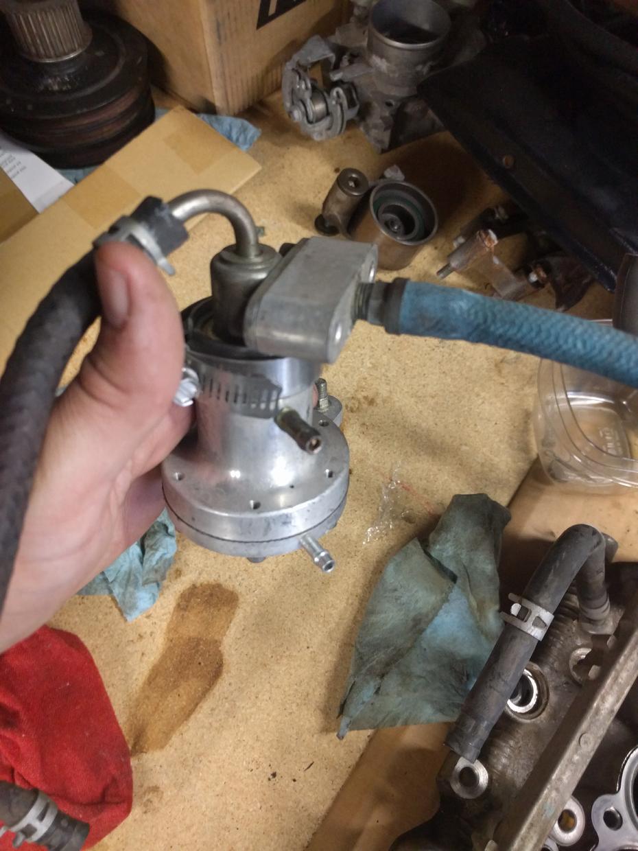

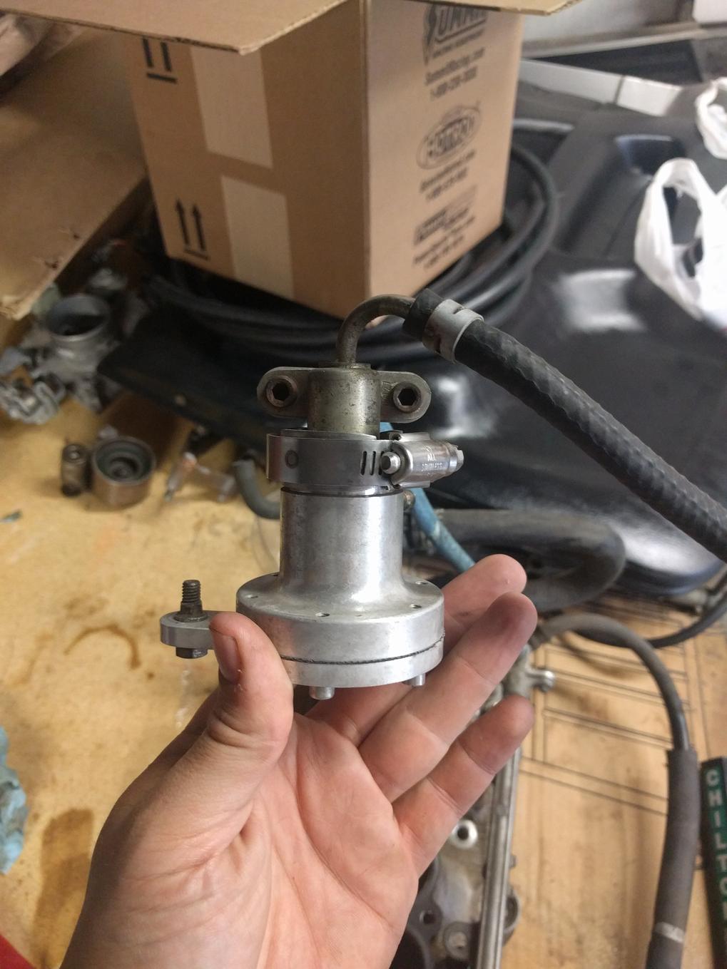

Anyone know where I can find out more information about the TRD vacuum regulator? One of the used 1st gen SC's I bought came with it.
Any ideas how to test if it's still viable? If it's bad, worth rebuilding?
Where should I tap into for my mechanical fuel pressure gauge?

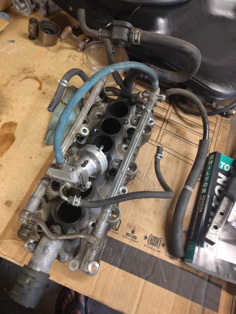

Can't help with testing, but since my sc is off, here's how its mounted & plumbed
What injectors are those?
Thanks for the pic, can you please take one of the lines coming in and out of the side? I'm guessing the bottom is the return, just want to double check. What hose clamps are you using?
Full disclaimer: i bought the truck with the sc installed so I am assuming the proper OD/ID hose was used, etc. The hose clamps appear to be just pinch style hose clamps of the proper size.
The hose coming out of the bottom connects near the driver's side fender. Assuming this is fuel line:
The hose which runs port to starboard from the valve (photo is engine bay facing aft) i have labeled as connecting to the air box (black plastic box between air cleaner and throttle body - not 100% on technical name).
As for the injectors - i recently replaced all 6 with a set of OEM i got off eBay
