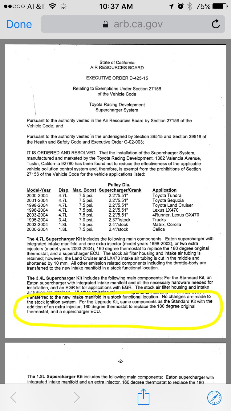

I am so glad I dont live in CA. But here are some ideas for those of you that do:
TRD once made a 7th injector system and it is covered under executive order D-425-15 along with the supercharger. I wouldnt think an emissions tech would know the difference between a TRD and a URD system... You should just need the EO sticker under the hood.
Regarding the flashy red URD pulley. Pulleyboys is an alternative. They are black anodized and look stock. Should fly under the radar unless it is measured.
I got excited for a moment but then realized the PDF you linked is the EO for the supercharger, not the TRD 7th injector :(
No that's the right one! Read the fine print man :)
It says "for the Upgrade Kit, same components as the Standard Kit with the addition of an extra injector.."
