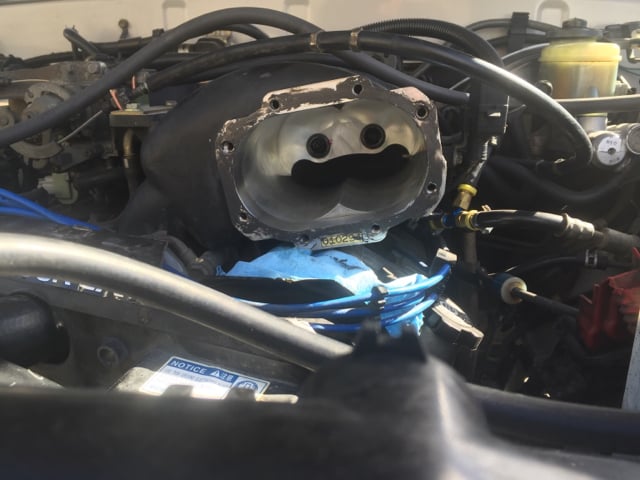

I am trying to determine if my rotor bearings are going bad. I have replaced the snout bearings and the rear needle bearings but still have a slight tinny buzzing sound when under a load. It doesn't always make the noise, mainly makes it when cold. Are the rotor bearings difficult to replace? I haven't seen any posts about this process.
How did you get the rear bearings out?
You might be out of luck... you could always try to put it all together since finding another rotor plate will probably be very expensive. Did you press the bearing out crooked? Only way I could think of it breaking like that is if the pressure wasn't completely centered and it bent and weakened the metal.
Press the new bearings in. Aluminum always shaves off when you press in or out unless you are dead nuts on
This is because the material was intentionally deformed (staked) around the bearing for retention purposes. It is recommended to weld retaining rings back in place.
I thought I had everything as lined up as possible using a 12 ton press. Googling around for a replacement rotor plate, the ones Jon Bond sells appear to have the exact same ring of metal removed. Maybe the factory added this metal as a final step in the assembly process, which is basically what bugman said.

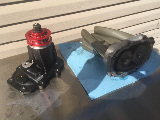

OK, 2 new questions:
1 - I got the new rotor bearings pressed in. The outer brace freely rotates within the mounting slot.
Would a few dabs of Loctite around the outer race be enough to secure it, or does it really need to be held in via the welded retaining rings?
2 - Pressing in one of the rear needle bearings, I noticed a little bit of material accumulated in the red circled area. I'm worried that I pressed that bearing in slightly off-center, just looking for a second opinion.

So i just rebuilt my supercharger.
I got everything sourced from around town besides the coupler and rear bearings. My coupler was 100% perfect and the bearings i just regressed.
I am thinking about selling a rebuild kit if anyone is interested. Ether nose cone or everything (minus rear bearings)
If you guys are interested let me know and ill get together more information and price for bearings/ seals. Ill post pictures in a bit. I only took a couple because there are a bunch of rebuild threads.

No. Forgot that part as well. My supercharger was actually in very good shape. It did not need rebuilding. But my nose cone shaft broke so I replaced it. And the bearings and seal in the nose cone.
I was surprised that my rotors were not scratched or the housing. The coating was still together on all the tips of the rotors. I just put new high temp grease in the rear bearings and put them back in.
Everything went together smoothly. But doing the nose cone was a pain trying to get everything situated and not pressing one bearing out while pressing the shaft in. I'm glad to have my 2.2 pulley back on. The stock is such a slow pig. It just builds boost so slow.
