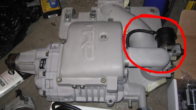

TRD gen 1 SC: Can I get a quick confirmation that the vacuum hose attached to the bypass valve should reconnect at the barb on the elbow? The line circled in the picture
I sent my SC to a rebuild shop, and for whatever reason it came back with the hose connected to the barb on the top rear of the intake body (roughly 10 o'clock in the circle)

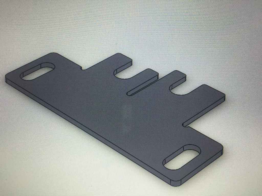

I did the same thing. Just cut the tabs off my factory one and welded them to a plate. You can always go buy a factory bracket if you go back to stock.
I have these fabricated and ready to ship. $15 shipped to the 48.
Bend, Paint and install.

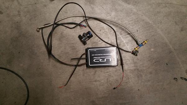

I have good news for you though, I have a 75% complete urd 7th injector kit that I will sell to you relatively cheap, you will have to track down the various little things to make it complete.

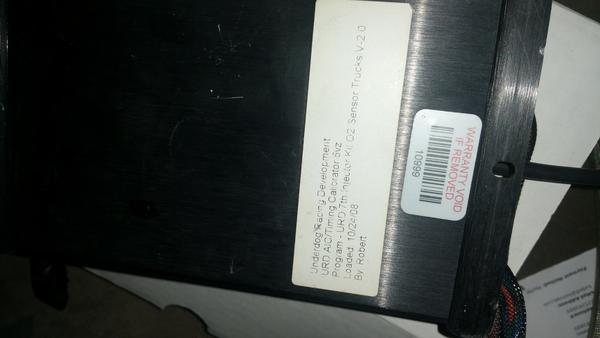

The URD PCM from it has a date from 2008 on it.
7th injector with gasket, mounting bolts, injector harness and fuel line.

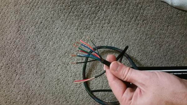

These are the wires coming out of the pcm
I needed to get a separate calibration box to make it work with my 97 5spd, I opted to get a new kit.
make an offer if your interested.

I might be interested, can u take a close up pic of the control box so I can check the part number?
I had no idea some were for 02 trucks and other for afr sensor trucks. Why wouldn't they work on one another. Can they be wired up differently per vehicle.
A afr sensor produces a different amount of voltage compared to a narrow band O2. The split second manipulates the voltage. So u need the right one or it will manipulate the voltage signal incorrectly.
