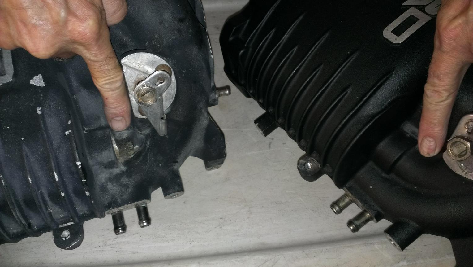

I sent mine (Gen2) to The High Speed Labs, aka Embree Machine. All I needed was the rear rotor bearings replaced as I rebuilt the snout myself. I couldn't get one of the rears out even using my blind bearing puller. On some of the Gen2 castings you can push both of the rear rotor bearings out through the back. On the earlier castings the right hole is a blind hole, meaning the bearing has to be pulled out. Wade and Alicia were great to deal with. They pulled the remains of the bearing and put new bearings in for about $200, but 50 of that was for return shipping. They seem to be busy always but total turnaround on mine was about 2 weeks. Pic is attached of the difference in the castings. Mine is the casing on the right.

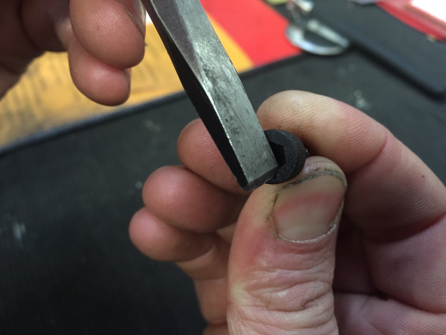

Any ideas for removing a stuck tensioner bolt? (135mm) I stripped it, then stuck a larger socket in it and stripped it again lol :redbrick: I really don't wanna pay $260 for a new kit. The bolt/bracket is the only thing keeping me from moving the s/c to my truck. Thinking of emailing Magnuson, I know it's probably a long shot but worth a try.
Ok yeah now it's time to get creative. If you can get a small chisel in there to bite at 90° and hammer on it that can break it loose. And I imagine you've got penetrating oil on the back side/thread area? (NOT just WD-40 as that doesn't penetrate, it's only Water-Displacment)
You want to try and spin the bolt by hammering it perpendicular. Something like this:
Also wanted to add as a final straw you could just drill the head off the bolt with a 90° air drill
