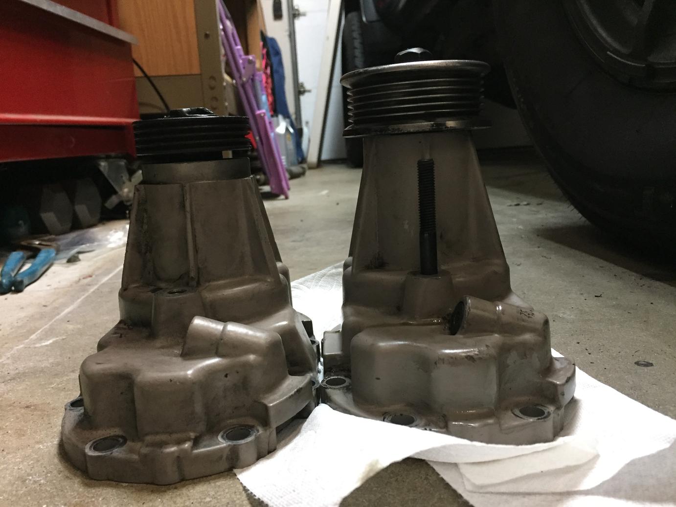

So what is the metal behind my seal? Could it be the old OEM seal or is it part of the Supercharger housing? I bought this unit rebuilt so not sure how the person rebuilt the nose cone. Maybe he accidentally left the old seal in there?
I think the metal in your pic is part of the seal, The stuff you pealed off looks to be the coating. I've never worked on one of these, hopefully someone who has jumps in to help.
My progress so far. Dont know why this is in there so good!
Did you buy a new seal. What's the new one look like. I agree with ^^^ him. Your not through it. Behind that is the bearing. I think you need to drill into that face and pull it out.

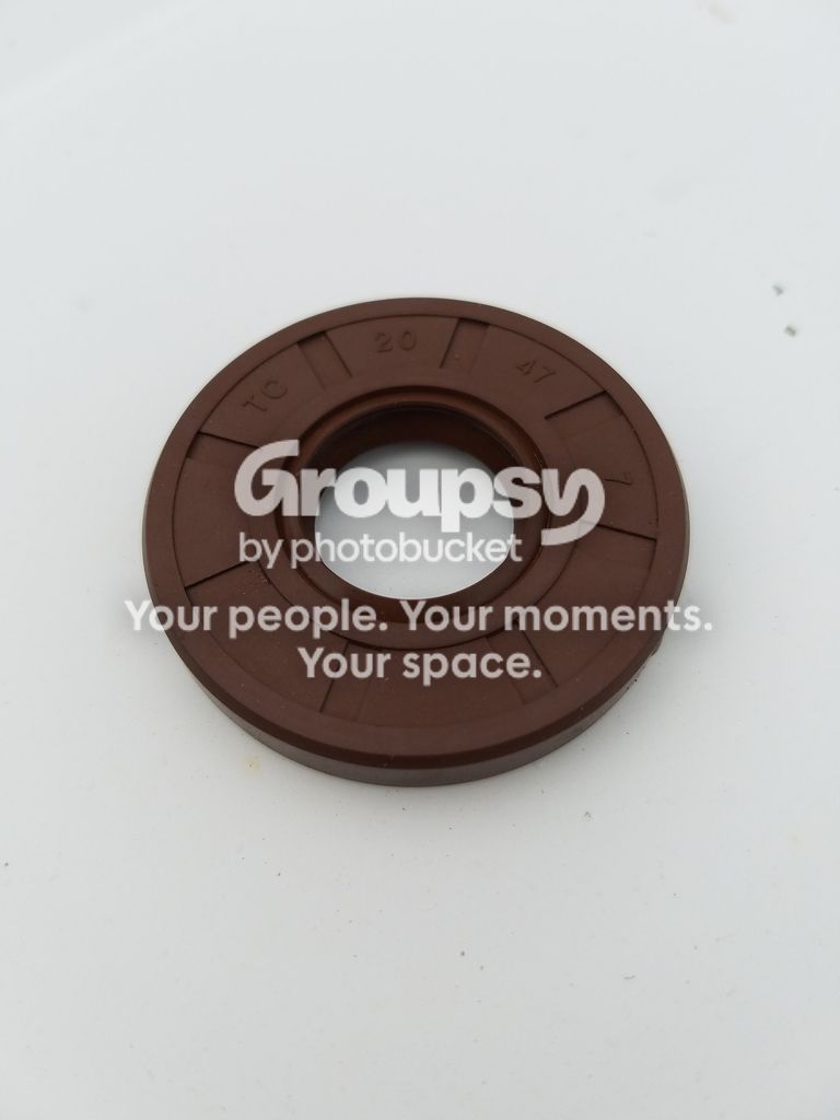

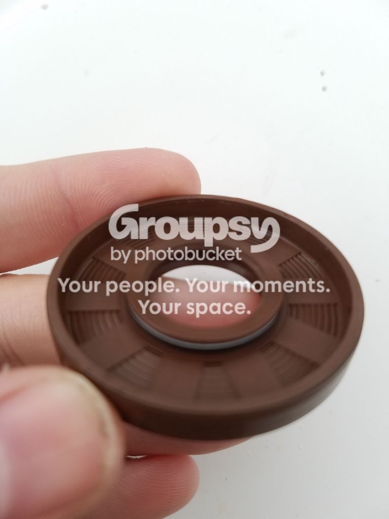

Here is the new seal i ordered from rolling preformance. It looks to be the same seal im removing as the PO rebuilt the super. I sure hope thst metal behind the seal is the original oem seal as this can more along much quicker. Just want to be 100% before i drill holes in a now $700 nose cone. Anyone have a picture of the oem seal removed or on? I cant find it on google.
It's seriously in there good. You'll need to drill a SHALLOW hole (don't drill the bearing behind it) and pull it out. Needlenose pliers did it for me, I literally had one foot on the bumper and was pulling with all of my might. Keep the charger on the vehicle though. Careful not to score the housing though...
P.S. that brown rubber isn't the seal. The aluminum thing behind it is.
The brown rubber part is just the coating. The aluminum layer you're at is the seal. That's what we all are saying :) The stock seal doesn't have the rubber coating, it's just the aluminum seals which is why it leaks sometimes. By the way... the supercharger installation manual says that there's a "break-in" period in which the nose cone often leaks but will stop after about 500-1000 miles on the charger. I replaced the nose cone but the leak never stopped so I had to replace the seal.
I have no photos, but if you remove the seal you'll see about 6 larger ball bearings in a casing, those are the bearings. The supercharger oil flows into the bearings to keep them lubricated.
P.S. the side with the spring goes in the back, I put mine in backwards LOL but it doesn't leak so it's all good.
Thank you for the response [MENTION=115347]gamefreakgc[/MENTION]. A few questions/opservations. First i see the roller bearrings about 1/4-1/2 inch behind the metal seal. The rubber type seal i have been attempting to remove is an exact match to the seal I'm hopping to install. My seal has no metal structure. Only the rubber and a small spring. Should mine have come with the metal? If not how does this seal mount/ stay in place? From my observations it looks as if the metal is the thing this seal mounts to?
Oh, I see what you are saying! The person who "rebuilt" your supercharger did it wrong. Instead of replacing the old stock seal they just put one on top of it! Geez... I hope you didn't pay too much for it.
You need to remove the leaking stock seal still then. Get it out so all you see is the bearings and then put the new on you have in place. Be very careful not to mar the aluminum housing or scratch it since it may not seal completely. If you do just sand it very lightly with very high grit sandpaper to smooth it out as best you can.
Not my photo but the bearings are in the middle of the photo. That's what you should be seeing if you look into the snout with the seal gone.
