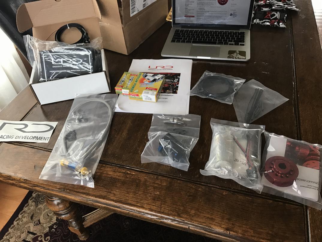

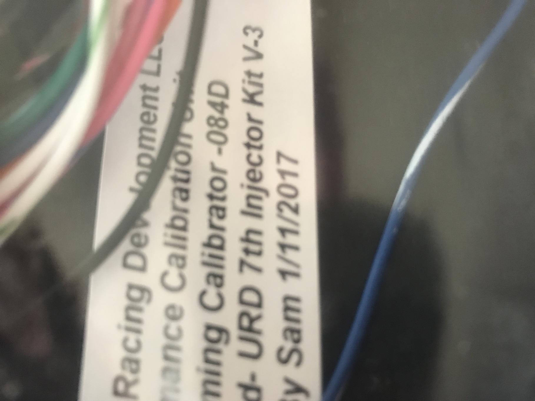

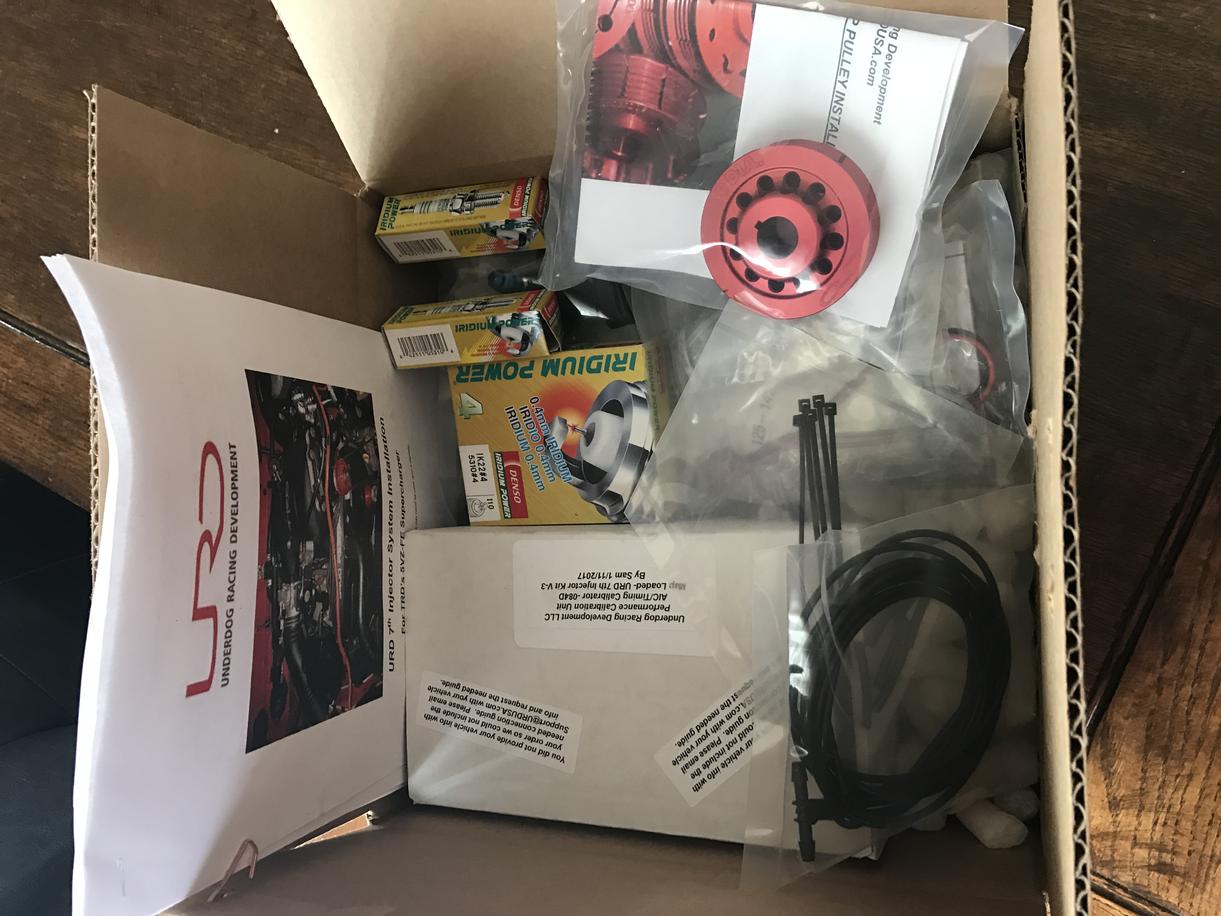

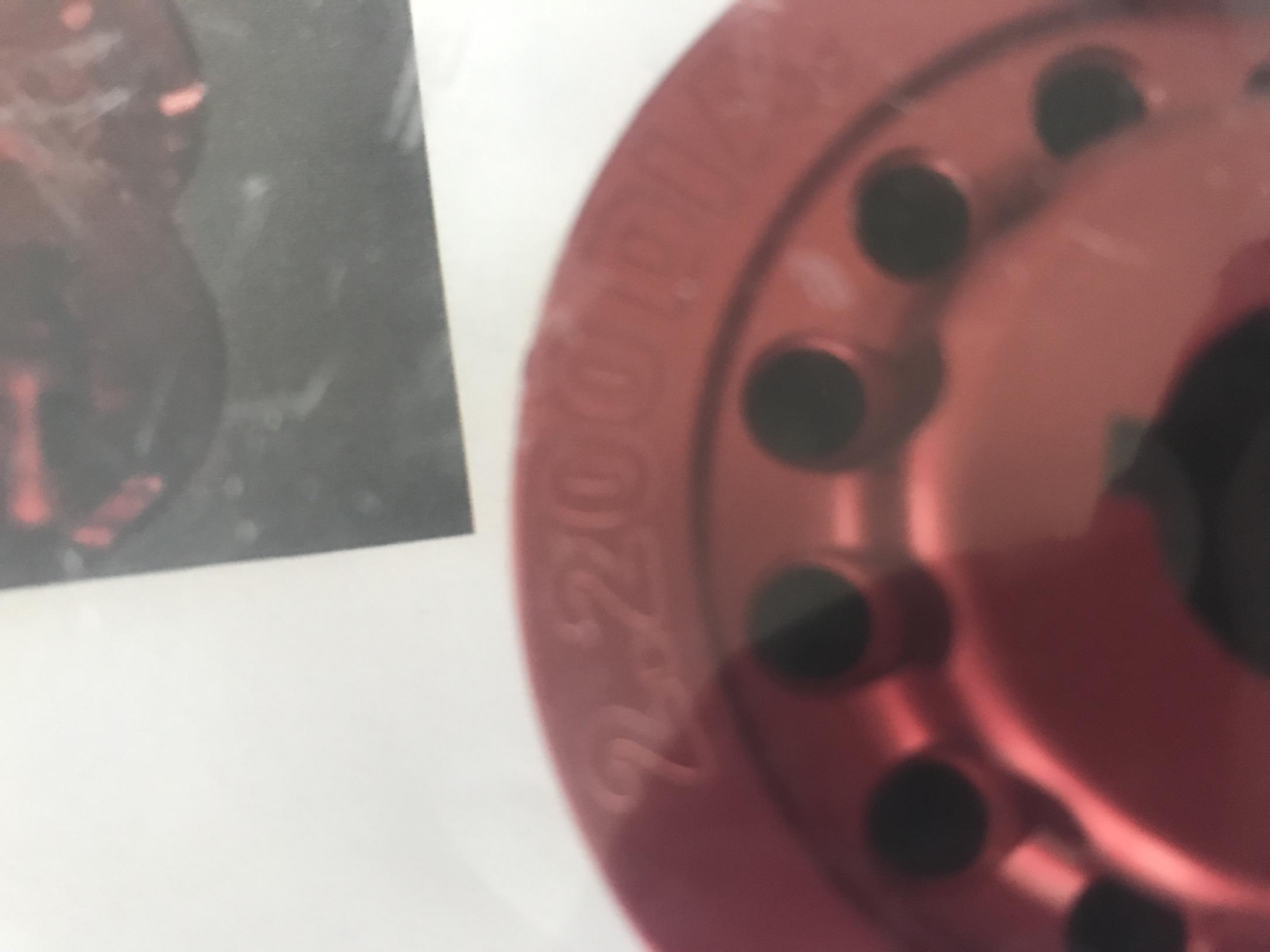

I am selling the 4runner. So I have a BRAND NEW URD 7th injector kit with the upgraded supergroup 2.2 pulley. I paid $1,000 after taxes and shipping, and it took over a month to get it. I am looking for $750 shipped. :tea:
Their are different 7TH injector kits depending on the year of the 3.4 motor. Without telling anyone more specifics they may find themselves with the wrong kit for their motor.
The emails I got from Steve (gadget owner of urd). He says that they are all the same. Just the way the kit gets wired into the ecu is different.
How does the piggyback know how differentiate between a newer 4runner with a air fuel ratio sensor as opposed to a o2 sensor? They send out different voltage signals...
