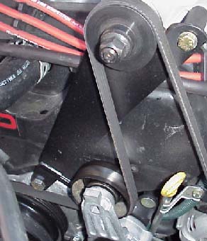

Doing some research on adding a dynamic tensioner to my 1st gen SC.
Looks like I can either order the whole kit, or order the pulley arm, then try to score a bracket from Magnusson, and then round up the hardware from various places online.
I found this page on Gadget's site where he cut down the static tensioner bracket to support the nose cone. Anyone else done this?

You can order the bracket and bolts from Magnuson for $150. The other items are easy to fab/source. I have a sheet with the wire loom and dipstick traced that I need to upload onto here so people can make their own. I just got some thin aluminum and made mine.
Also a TW member (@kigmob) did that to his. Not necessary but doesn't hurt to have it.

I cut my old pulley bracket like that and it worked on my original nose cone fine. I ended up buying a factory new nose cone to refurbish my S/c and the new nose did not have the hole tapped.
