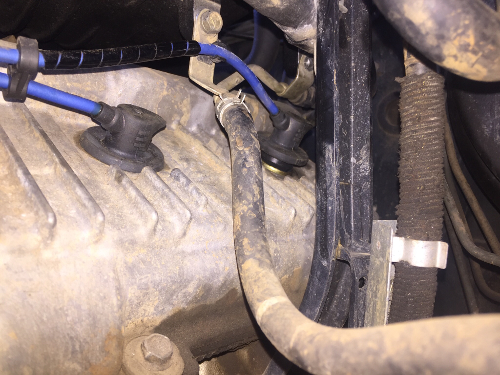

I posted this in the "what did you do today" thread, but figured it wouldn't hurt to put in here. May prevent somebody else from chasing this problem. Make sure you double check your driver's side plug wires have slack after the install. My rearmost plug wire was just snug enough to pull itself free when I bolted up the wire loom to side of s/c.
Spend a couple days chasing my tail trying to solve a violent misfire under load/above ~3k rpm. Good news, simple fix!

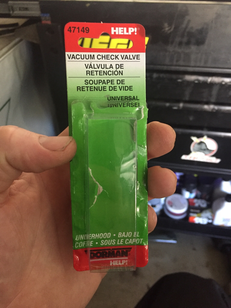

Haven't seen this one listed before but it works for the check valve. Smaller tubing size so you'll need to adapt the hoses down. Not ideal but perfectly functional in a pinch. Dorman Help! #47149 "vacuum check valve"

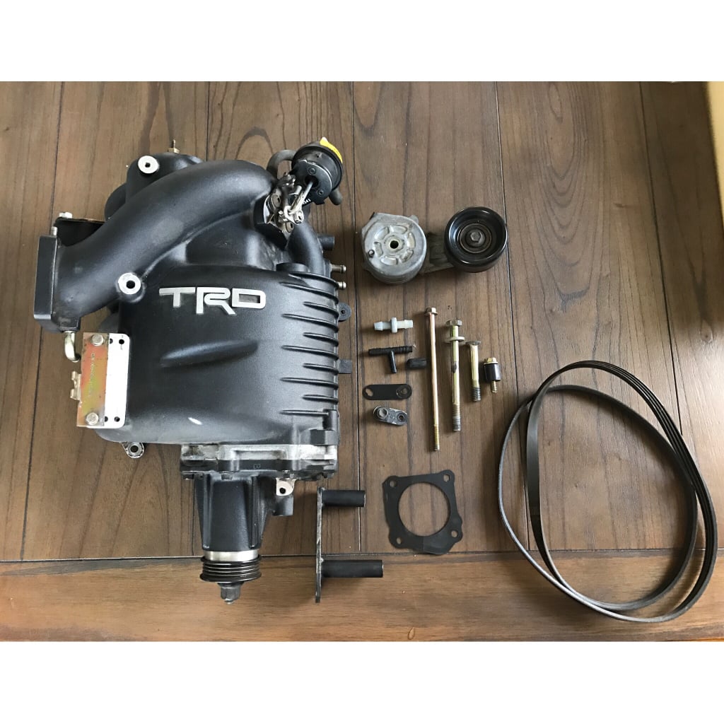

So I have the opportunity to purchase a 2nd gen for 1600. No 7th or supporting fuel mods, just the charger and everything it comes with to bolt it in.
It has 245k miles, says it ran great when pulled, no video of it running before pulling.
Anything I should ask for specifically in regards to checking things out to make sure it's in working order?
If I didn't purchase it, I'd probably do a rebuild on it anyway.
I'd at least ask about the nose cone kit replacement. Those prices are ridiculous right now at like $500-700 or some damn thing. If it hasn't been done in awhile you could weasel down a couple hundred off asking price I bet.

Do it. Rebuild or not that's a good price.
And yeah, see comment above on ordering them from Magnuson. Toyota discontinued the "TRD" replacement parts but they are still manufactured, just not with the logo on it! Get a TRD throttle body gasket too while you are at it. Opens up the intake.

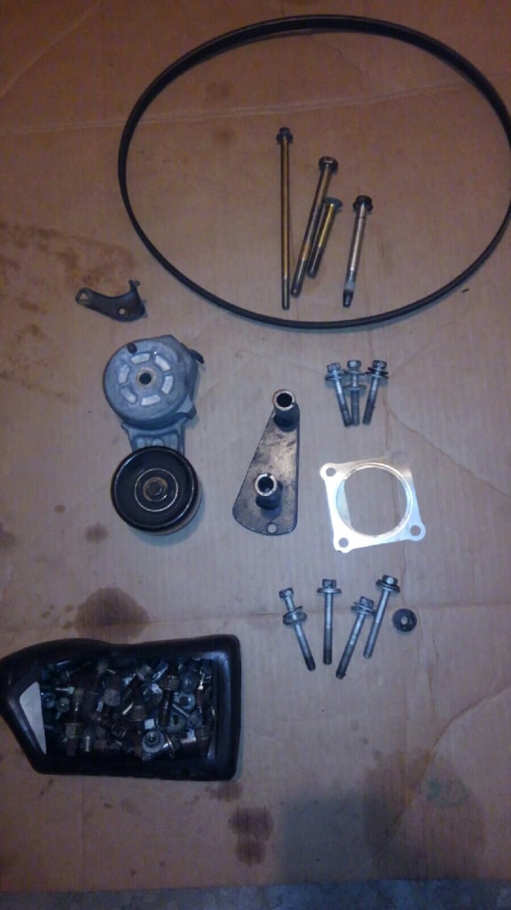

Well I think I have everything I need. These are some pictures the guy sent me. I looked at the pictures in the original post to match everything up. I think it's all there. Anything missing?
Probably should get the proper O shaped throttle body gasket. You have the D shaped one in the pic.
I also don't see the dip stick relocating bracket, various vacuum fittings/lines spark plugs, thermostat, and the radiator cap.
