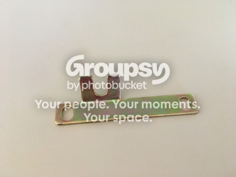

So I just picked up a used SC and I think I've assembled all the parts I need to install, but am missing the correct transmission/throttle bracket for my 2000. I seem to have the 2001+ bracket. Anyone got a spare they'd be willing to part with? I'd rather not buy the whole kit from Toyota...

This is the bracket I have.
IMG_6063_zpspyrlnrye.jpg~original
TRD PN: PTR29-60032
TRD DYNAMIC TENSIONER 3.4 SC PTR29-60032
Has the bracket you need and the hardware.
The tensioner alone does you no good.
