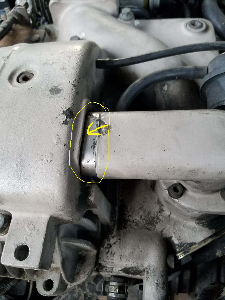

Try this, works very well for finding a leak, just do it when the engine is cold.
Awsome, this worked great. I've heard of the carb cleaner method but I've never wanted to do that because carb cleaner is really rough on paint and parts, I didn't want that sprayed all over my engine bay. I found the leak, it's right on top of the supercharger where that oval tube part feeds back into the upper housing. Is this a normal to have a vacuum leak? This is an older photo btw, it has been cleaned up a lot since this was taken (I removed the s/c and replaced the manifold gasket after cleaning it all up).
No, vacuum leaks are not normal and kill performance. You'll want to reseat that part or put a heat resistant sealant of some sort there.
Sorry, I guess what I meant to ask is if that is a common leak location. How is that part sealed, is there a gasket of some sort inside? I wasn't sure how it all came apart.
There is a o-ring that supposedly seals it. I bought some right stuff gasket maker and sealed mine, no leaks ever again.
