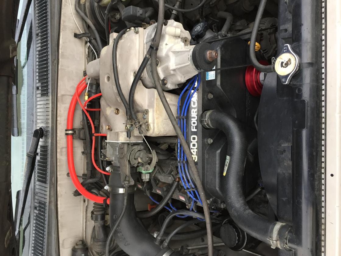

Thought I would post a little something about my experience. I installed my grey supercharger on my 96 limited over 1,000 miles ago. I am happy to report NOT ONE SINGLE ISSUE. When I picked up the supercharger (700$) it was in great shape and most of the hardware. I immediately sent it off to the High Speed Lab to get a full rebuild along with thermal coated rotors. It comes with a year warranty and they were great to work with. Anyway, this whole time for like 2 months straight all I did was read the forums and installation instructions about installing it. I talked with people who have already done it with what goes where. It helped so much to have everything I needed material and knowledge wise. I feel like it paid off. I read a post by someone that said, things are going to go wrong after installing the supercharger, it's natural haha. That scared me about doing it and sacrificing the reliability of my rig. That just doesn't have to be the case all the time. I live in denver and am running no fuel mods( yet) and have zero ping or stutter. I get my bung for wideband welded tomorrow.
