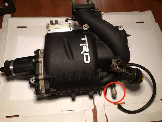

Im pretty sure i have everything i need to be successful except this one little spacer.. bolt size is stated in the instructions as being M8 1.25x35mm .... i can find that no problem at a hardware store, but what i can't find is what length this little spacer is....it's not stated in the instructions. looks to be about an inch??
CAN ANYONE MEASURE THIS FOR ME ON THEIR SC?...

It's hard to measure without taking it off, but it's roughly 7/8" long. I would just stack some washers together and call it a day.

Getting ready for SC install and had it handy!
Looks like 3/4" spacer and the anodizing puts it at exactly 0.7545"
