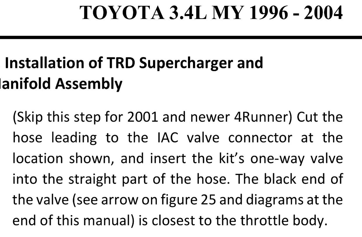

Bigger question:
Do you know where I can get the IAC one way check valve ?
Part number 00602-17620-065
Toyota doesn’t know what in the hell im talking about. After further explanation of what it is, they were quick to say it’s discontinued ...
I’m confused if 2001-2002 even need this step...
I’m not necessarily trying to do anything fancy with my supercharger (yet, like fuel mods later on) but simply run the plugs that other people have had success with.. TRD parts for you has both the IK20 & IKH22 & everyone I’ve read up on has the 22’s... so I guess I’m just curious if the 20’s will run ok for a couple weeks until I get the 22’s...
Bigger question:
Another thread mentions using a PCV valve from a 93-96 Isuzu Rodeo. Just needs to be straight, without bends and allows air to flow only one way. Instead of tracking down exact part, go to Napa Auto or Autozone and have them pull a couple Isuzu PCV valves. Probably like a $5 part. Better than searching for weeks for the right one. Otherwise, maybe eBay?
Idk what engine you’re using in your 2nd gen but if I understand correctly the 2001-2002 4wd drive front diff’s activate electronically... not vacuum actuated like 96-00
My engine is a 98 4Runner.
I think you're correct for the 4wd system, but I don't think that's the purpose of the IAC check valve. The reason why 01 and later models don't necessarily need it is because they have electronic throttle bodies and therefore don't have the IAC valve.
The check valve is to help the "air assist system" which is essentially just a breather "Y" hose at the intake to the IAC/throttle body. Without the check valve, the supercharger "pulses" mess with the intake airflow and give goofy results. I never ran mine without the check valve, but it's pretty important if it's suppose to be on that particular year of engine.

Bigger question:
