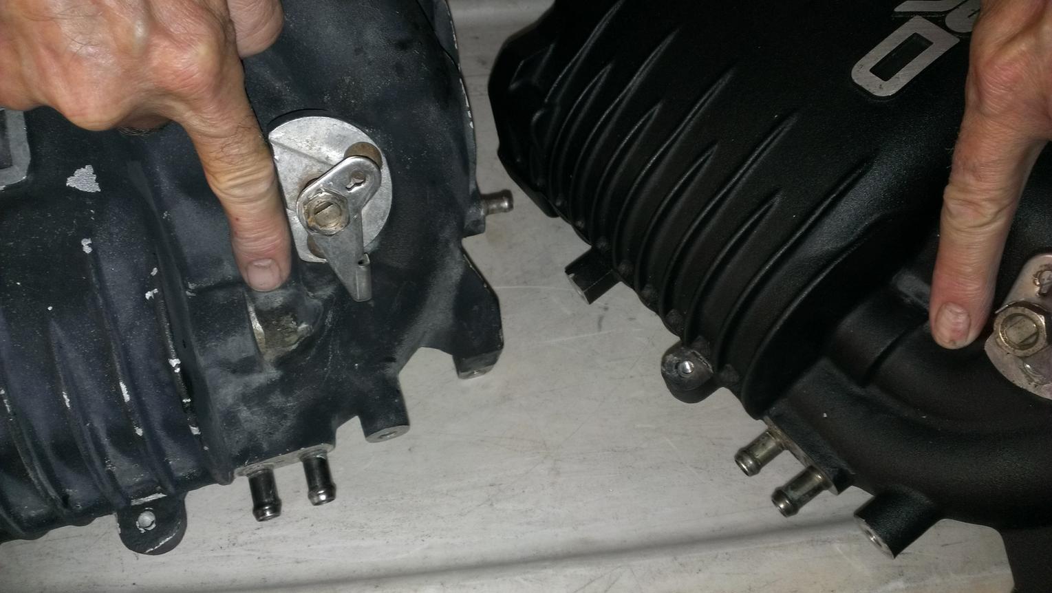

There are two different castings used on the Gen 2 SC. One you can push the needle bearings out the back and the other you have to pull one of the out with a blind bearing puller as the back is not open. I could not get mine out and ended up having it cut out with a die grinder. Was more expensive but not terrible. I have attached a pic of the different castings. Mine is the one on the right.

Thanks man, just what I wanted to know! Now, to tackle them...
Very interesting! I was wondering why some people with the 2nd gen charger were saying they could press our the rear bearings, I thought they were just lying because there's absolutely no way to press mine out.
