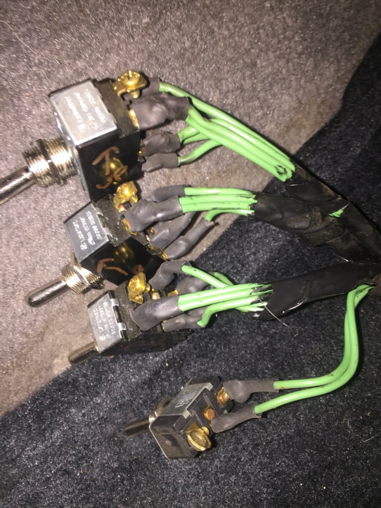

Originally I had hard wired in bypass toggle switches for each sensor used (crank, cam, O2) for the event the URD went haywire or smog became an issue I could switch it all and have it run from sensor to ECU as normal. Haven't used the switches even once in 2 years and it makes dash component removal a PITA.

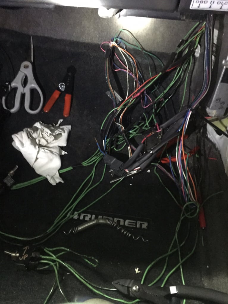

Since I'm installing a CB and removing a fair portion of the dash, figured it was time to reevaluate. I'm removing the switches and instead wiring in matching junkyard aquired male/female connectors for inputs/outputs to the URD. This way, URD goes haywire I can pop a panel and swap plugs and also bypass URD or diag on the trail, whatever. Plus later removal of dash etc is easier since things aren't hard wired.
Note to all: if you're going to do something ridiculous and overly complex like this, don't be a moron and use a single wire color, all unlabeled.
Old bypass switches, using only green wires
Current state

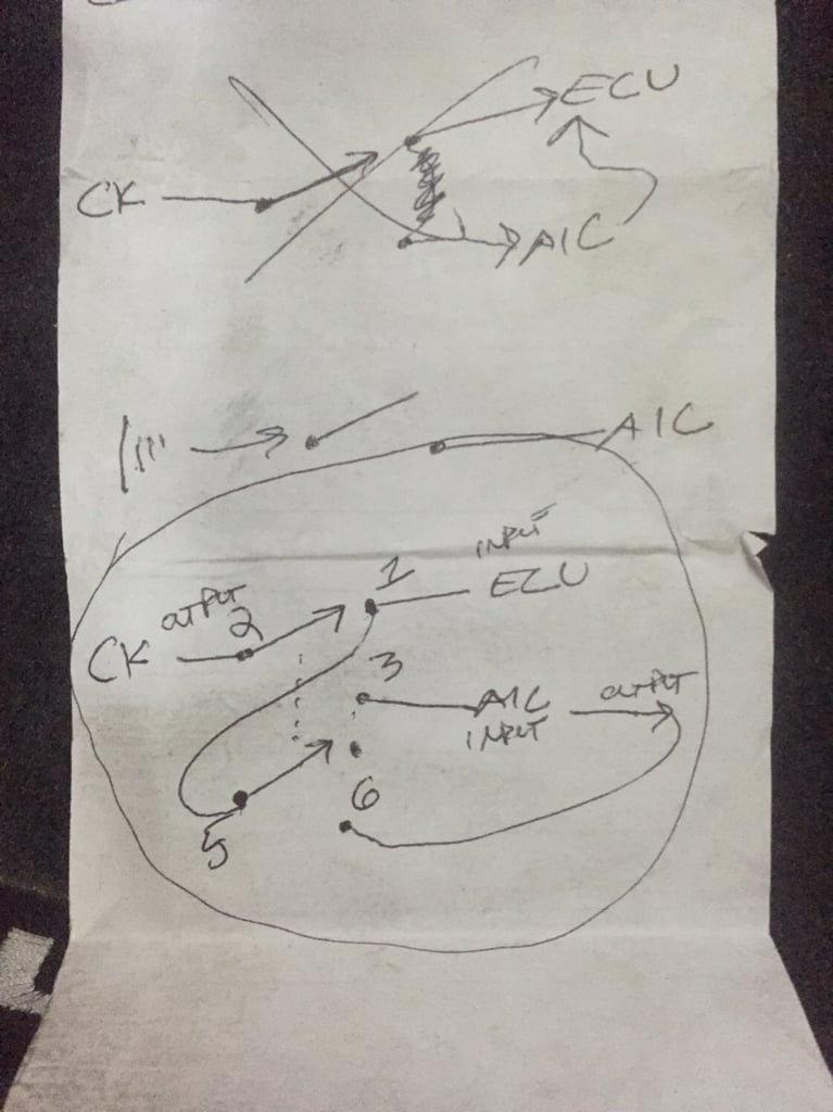

You can see the grey connector in the middle. The matching duplicate connector is blue and I'm going to wire it so it'll go sensors/inputs>male>female>URD>male>female>ECU. This way a bypass is first male to second female and it'll run as if stock.
Totally stupid and complicated but this is the best that this mad scientist can come up with for now. Seems like a great all around solution to my concerns.
Luckily I found my old doodle labeling the pins for the DPDT switches
