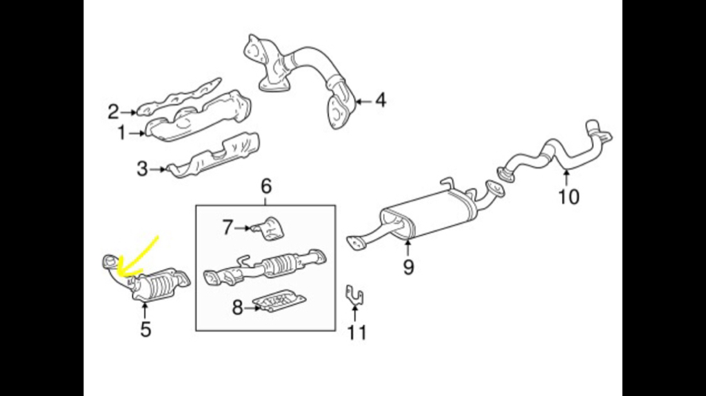

I'm going to be installing a AEM wideband Air/Fuel Ratio Gauge. Can someone please tell me the correct position to have the exhaust shop weld in the bung for the sensor? Like, where exactly would it go in this picture?
I'm assuming between the converter (#5 in the pic) and the catalytic converter (#6 in the pic). Is that correct?
Thanks.
The AEM instructions should tell you distance from collector, but memory tells me it's within 12 or 18" from that flange. That being said, you do NOT want it after a cat. Totally defeats it's purpose. You want a reading that is untainted, directly after the exhaust leaves the engine, sampling all cyclinders.
So in this spot is best in my opinion
k
Thank you so much! I guess I didn't consider the first converter (#5) to be "catalytic", just the second one.
The AEM instructions say this:
"Mount the O2 sensor in the exhaust system at least 18 inches downstream from the exhaust port."
and this:
"For accurate readings, the sensor must be mounted before catalytic converters"
Thanks again.
