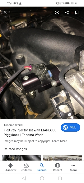

Anyone know where I could find a pigtail for the TRD 7th? Looking to adapt the injector already installed to a URD FTC. Not sure where to find the harness I need.
Sent from my JSN-L23 using Tapatalk
Oh gosh, the mythical TRD 7th injector. I've never seen one in person and the last one I saw for sale online went for over $1500. That's going to be a tough find... Even the install instructions for the TRD supercharger makes no mention of it anywhere. Got any friends or contacts at a Toyota dealership that could do some sleuthing?
Haha, the injector setup itself is great, but the computer they came with is leagues behind the URD setup, that's expected being 20 year old tech. No help on the Toyota end, it doesn't appear to be a denso style sensor like any OE Toyota of the same Era, I'll be messaging around injector specialists to try and I.D. the type of injector used.
Closest looking I could find is a Bosch EV1 style, fairly common aftermarket injector so for 4 bucks I went ahead and got a pigtail coming.

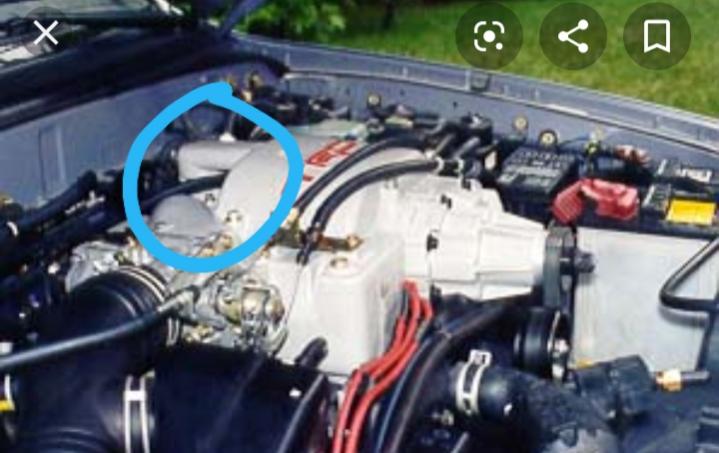

What is this part guys?
Hey guys so I believe this sounds it leaking air out of the side. What is the part circled in blue?
That's the bypass valve tube. At light throttle it bypasses the supercharger rotors and directs the air straight into the intake for better mileage. The first gens are pretty notorious for leaking there
