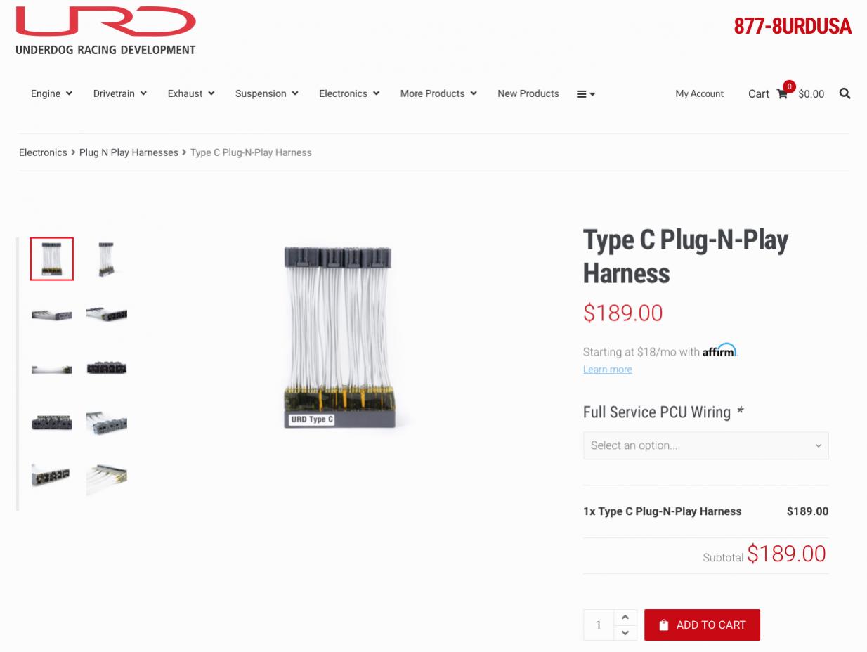

Which letter URD harness kit did you guys use??...
Type "C"???

Depends on what year truck you have. There are two types of ecus in these trucks, some use 4 plugs others use 5 I think depending on the year. That will determine which letter harness you need from urd
I have a 2002. Just wondering what harnesses you or that other guy got.
For mine I chose to hardwire my piggyback into the ecu harness so no plug and play harness. I did this for cost and simplicity sake. I also dont see myself having the need to remove the piggyback anytime soon and if I did Id just solder the wires back together.
Being an 02 yours should have the 5 plug ecu which would need the type e harness from urd if Im not mistaken. Id double check that and maybe shoot urd an email they should be able to confirm that.
