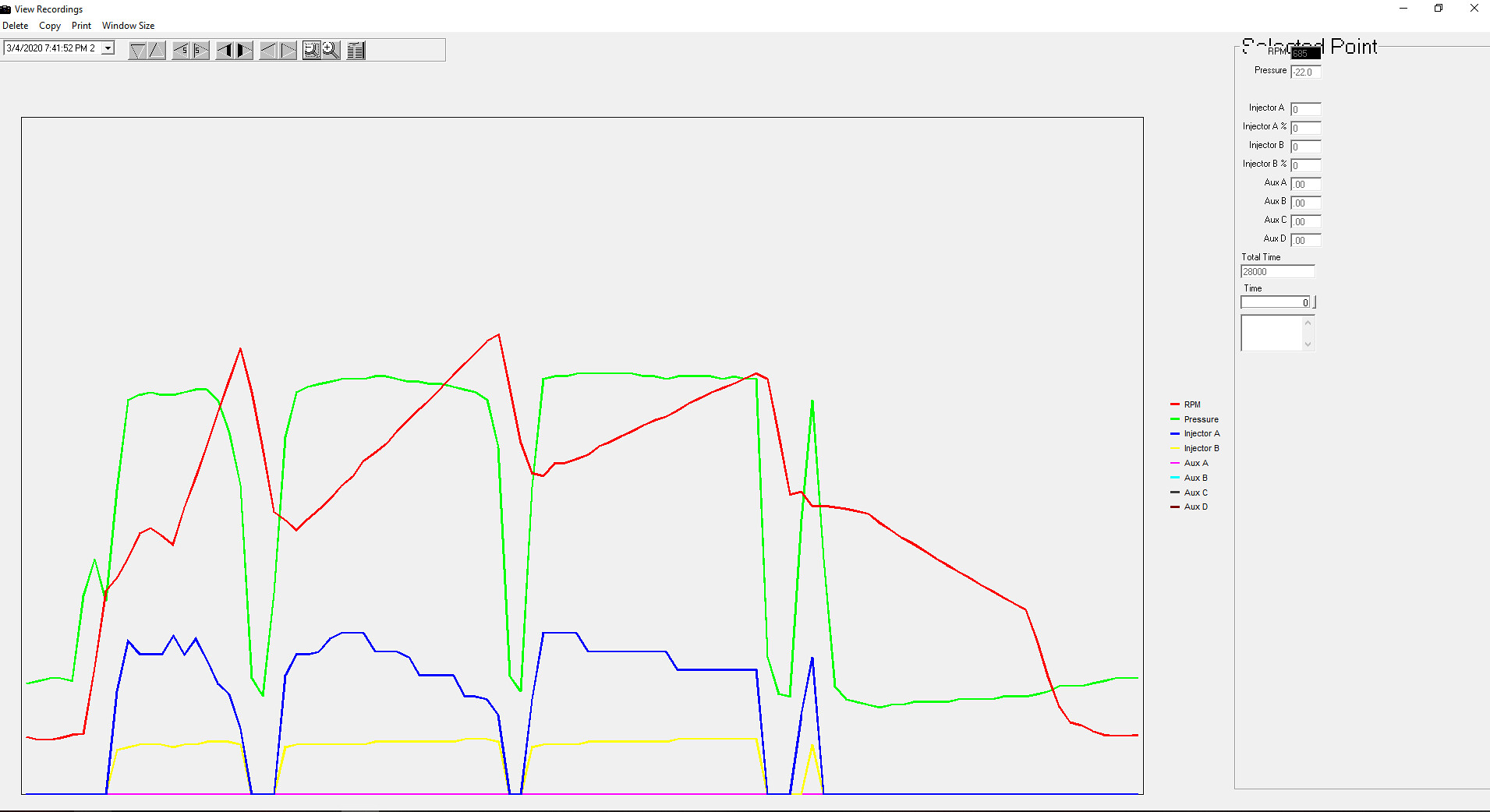

Hey guys! I have the Magnuson SC, URD 7th Injector and 2.2" pulley installed on my 2000 5-speed. I have been playing around with my tuning maps a bit and I am getting good results. I grabbed some data on the R4 software last night and I have some questions on some of the results...
The URD AIC is seeing max MAP pressure of 7.2 psi (I'm at 2880' in the miserable city of Midland). My boost gauge is showing closer to 9-10 psi. Is this similar to what you all are seeing with this pulley size? and why might there be this discrepancy in pressure readings?
Does anyone know what Injector B is referring to? Injector A should be the 7th injector, I believe...
Injector A showed max duty cycle of around 54% during my 1st-3rd gear pull. Is this the actual duty cycle or do I need to multiply it x2 like in the fuel map? I'm assuming that this is the actual value since I'd be shocked to be maxing out the extra injector...
Below is a data log from the pull.
1-3 gear pull safe map Midland by https://www.flickr.com/photos/140393666@N08/, on Flickr
I think the pressure differences have to do with the display settings for either the URD software or the boost gauge depending on if yours is digital or not. "Absolute" pressure is different than relative pressure and rule of thumb is 1 psi per 1,000 feet so at your elevation that would explain the couple PSI difference. There's a display function on the URD software to change it so that might help.
As far as duty cycle it would appear that yes you are maxing out the injector. You have it set up at "3 cylinder 2 stroke" engine in the settings right?

Boost gauges are notorious for being inaccurate. The MAP sensor on the URD is much more reliable. That sound about right for being near 3000 ft up with the 2.2" pulley.
Not sure what injector B is on that map, but A is definitely the 7th injector. You're not maxing out the 7th injector at 7.2 PSI, it can handle fuel needs of up to 11 PSI, that's true duty cycle you are seeing at 54%. The URD AIC unit cannot read the injector duty cycles of the stock injectors. To do that you'd have to have cut and splice all 6 injector wires, which I'm positive you didn't.

Makes sense with the absolute vs. relative pressure. Yes, I am set up as "3 cylinder, 2 stroke".
Yeah it's definitely not wired to see stock injectors. I'll try to reach out to Gadget and report back with the findings on Injector B. Thanks!

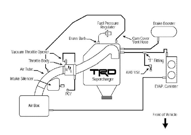

1996 vacuum lines - where do they go now?
so I am having some trouble with the vacuum lines now that the supercharger is installed.
my hoses are dry as hell and Ill need to get some new ones. But my real struggle is going from a non supercharged vacuum hose set up, to a supercharged vacuum hose set up.
I have not been able to find a decent picture or walk through of where they need to go. And its different for each model year (I think) the papers I have read cover late model 3rd gens......(not what I need)
can anyone help? would like to have it up and running before work on Monday...
Here's the '96-'00 4WD version. I didn't see a 2WD version in the pdf

this hose is coming from the bottom of the steering pump. there is a second hose next to it that goes to the intake tube. but Im not sure where this one goes circled in red.
and these two I think go where the yellow circle is?
OK, I have solved the vacuum hoses.

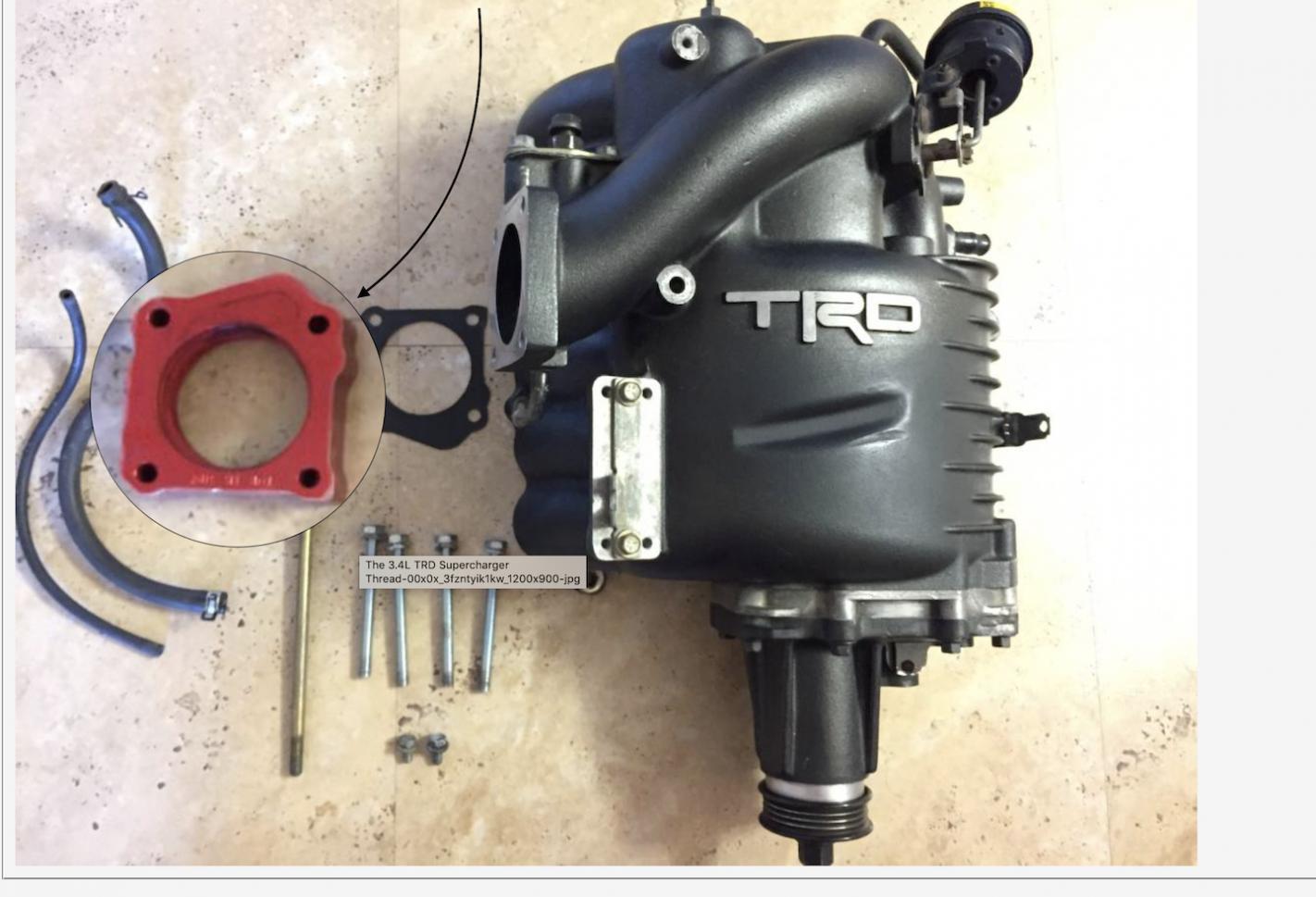

where can you buy this throttle body spacer?... is this a URD product?

LCE sells them Throttle Body Spacer Kit - 5VZ
AirAid sells them 510-502 AIRAID Throttle Body Spacer
aFE Power sells them Silver Bullet Throttle Body Spacer | aFe POWER.
But to be honest, the majority of the supposed dyno gain that LCE claims is from replacing the throttle body gasket to the "O" type from the restrictive "D" type. If you want a bigger bang for your buck, get the "O" gasket and get aFe's drop in dry or oiled filter Magnum FLOW Pro 5R Air Filter | aFe POWER or get a ported throttle body from maxbore.com Maxbore.com throttle body boring service and repair.
I gained a peak gain of +9 HP and +9 TQ with the aFe oiled filter alone.
