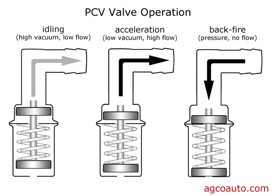

Here is what I found on the net: It seems when supercharged, the pressure is reversed!!!!!
Any pressure in the intake causes flow in the opposite direction. This could occur during an engine backfire or if the engine is turbo-charged. The PCV valve can act as a check-valve in these situations. By closing the PCV valve, any positive pressure or fuel vapor is prevented from entering the crankcase. Even a very small amount of positive pressure can force oil passed gaskets and seals and blow gaskets out of place. Failure of the valve to seal positive pressure may damage the engine.

Wow, really? I'm trying to wrap my mind around this one but doesn't make much sense. Intake and plenum work under a vacuum (less than atmospheric pressure) so maybe some of the pressure will leak out? Or maybe the blow-by gases escape after you let off the throttle creating the surge of oily air from the crank case.
Either way, sounds like your PCV valve isn't sealing like it should. You don't want to be pulling water and methanol into your crank case. If it's getting in your catch can it's getting in your engine too, which is REALLY bad.
If the PCV valve is working properly, it should prevent fluid from getting into the crank case because it works like a check valve. In my case instead of being blocked by the PCV valve its going to my catch can.
If i remove the catch can, the meth would just sit in the PCV hose until pressure is reversed where it ends up in my throttle body.
If the PCV is truly sealing though, there should be no air flow going into the PCV in the first place. Unless the water is just collecting at the opening and entering at a very slow drip? But then again once the PCV is blowing air again it should purge the line.
Is you catch can installed in a way that the fittings on the can are the lowest point in the hose? Min hoses are at a slight curve so any water/meth that would come in would not enter the catch can (would be trapped at the middle of the hose) unless the PCV isn't sealing and allowing flow.
