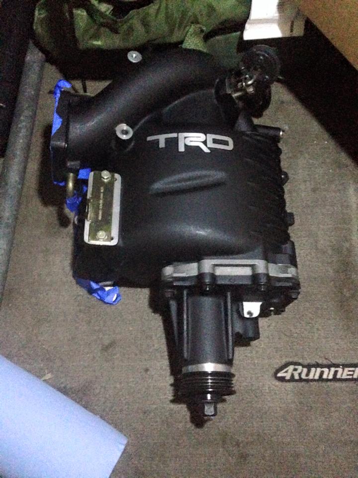

That one looks good. 7k miles is basically new. I can't remember the full kit of the top of my head, but that looks to be pretty much complete.
