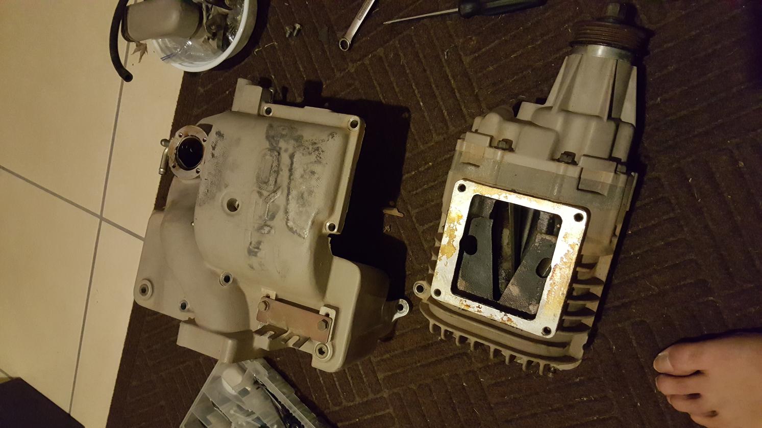

My first supercharger, getting her ready to be shipped out for a complete rebuild.
