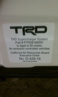

Not sure this has been posted here, but since I kept failing my smog test in CA due to a mismatching E.O. sticker for my 2002 4Runner, I thought I would mention it:
The E.O. sticker for a 2001-2002 4Runner with a super charger IS different than the E.O. sticker for the earlier 3rd gen models.
The correct E.O. for the later 3rd gen models is D-425-15, which must be listed on the sticker, and the part number for the sticker itself is MDC# 00602-89020.
Some posters have said you can print off a document and show it to the shop for approval, I tried and it has never worked, but best of luck. The sticker was $1.09 at my dealership after tax.

Thanks for the info. I live in CA also and have to get my truck refereed due to installing a 5 speed in my 02. I also have a supercharger with 7th injector. What size pulley do you have on your supercharger? Curious if that was noticed as I have the 2.2" - non stock.
So this sticker can be purchase at any dealer or is it something that has to be ordered at the dealer?
Can you provide a photo of what your sticker looks like?
Might be a little bit on the picture, my roommate took my truck out for something. But this is what I found via a google search -- I'll confirm if the part number in this pic is the same, but it reads and looks exactly like this: https://lh3.googleusercontent.com/-2Zcb3XW8W0s/TrBWTywfPUI/AAAAAAAAGDg/mxhRb1Suonk/s400/IMAG0794.jpg
The supercharger is completely stock, no 7th injector (I wish), and a stock pulley. The tech literally told me that everything checked out, but he couldn't pass me solely because of the sticker being mismatched.
I went to a referee too to maybe get a decision that trumped the other tech's call, but the referee said the exact same thing. So I finally got my hands on a sticker from TRD.
