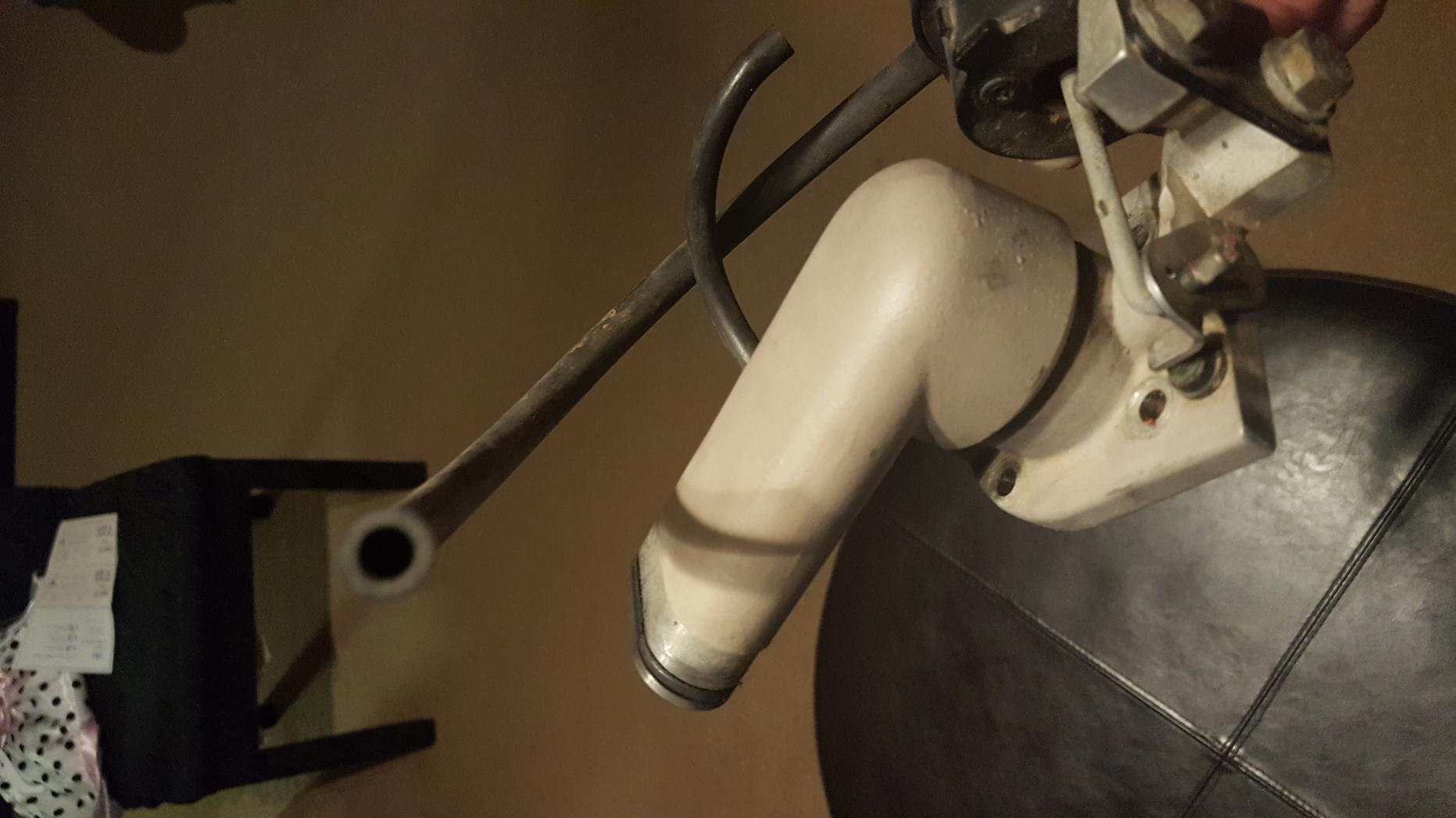

Is there gaskets to replace in this elbow prior to putting it back together. Part numbers for gaskets?

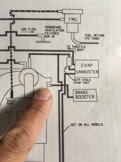

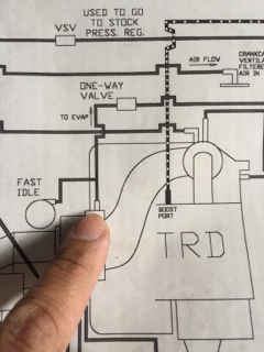

So i need a little help. I took my 1st gen SC of my 98 4Runner and im in the process of installing it on my 2001 4runner. The 2001 does not have some of the vacuum hoses that my 98 does. For one is the vacuum hose from the brake booster. Can I just cap off the ports on the SC that aren't being used?
Yes you can
