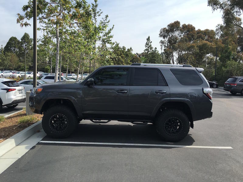

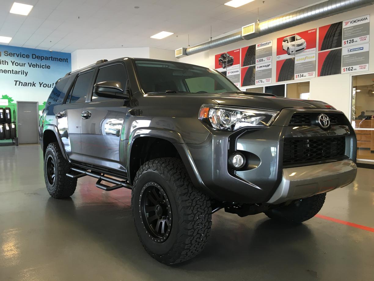

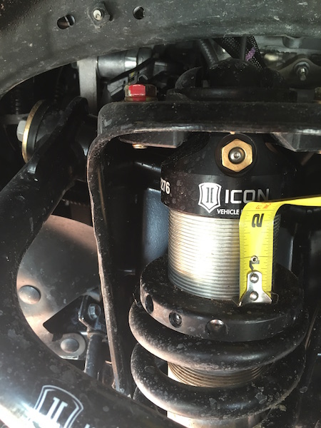

That looks like way too much preload for stock weight
Please explain. I'll be taking it back in for mandatory adjustments at the 1k miles or 30 day mark. Should I take it in before then?
The lift was installed by the dealership, who outsources the lift installs to 4x4 Parts. I'd like to think they know what they are doing, but you never know.
The coilover shock has a threaded adjuster for preload of the spring, which directly affects ride height. We are already way, way, way beyond the expertise, competence, and abilities of any 4x4parts store. You're lucky they didn't manage to set it on fire or crash it between the half assed installing your parts and driving it to/from the incompetent firestone for mis-alignment
... We are already way, way, way beyond the expertise, competence, and abilities of any 4x4parts store. You're lucky they didn't manage to set it on fire or crash it between the half assed installing your parts and driving it to/from the incompetent firestone for mis-alignment
And that expertise is why I love this site. Can you give me some advice or ammo I can use to get the dealer to correct it? Perhaps I can get Icon support to chime in, or take it to a reputable 4x4 shop?
Thanks
I can't really tell from the pictures... but how level is your truck sitting... Is the front a little lower than the rear? It will also need a little time to settle in the rear....
If the pre-load and ride height up front are too high (much beyond 3" of lift), the CV boots will wear out quickly... and will cause a big mess and expensive repair.
If you post up the distance between that black adjustment collar and the black top cap of the shock (basically the exposed aluminum threads), we can tell you if it is too much. Mine measures about 1.9" and I feel it is about as high as it can go without causing CV boot issues. Again, the key is around 3" of lift above stock ride height. By looking at your picture carefully I think I can see how much they adjusted it from the ICON 2.5" setting. It looks like they went with a little bit too much. Back it down a few threads and you should be fine.

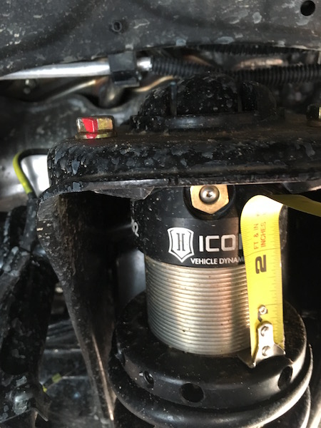

Alrighty. I snapped these pics this morning. It looks like there is about 2" of exposed thread. Should I still back it down a bit? The ride seems pretty level, I've tried eyeballing whether it's higher or lower in the front, but my brain starts playing tricks on me.
I'm pretty sure this lift was the first Icon lift the dealership had ever been exposed to. The salesman couldn't wrap his head around why I wanted Icon stage 2 instead of the $400 revtech spacer lift he tried to sell me.
The ride does feel a little off. Sometimes I need to tug on the steering wheel a little extra to straighten out from small turns. And the truck will pull a little to the left or right occasionally. :mmph:

Truck looks great. I'd almost guarantee the reason you say the ride feels "a little off" is because they have your caster improperly adjusted. I'd take it back and tell them to adjust the caster as close to 4 as they can get it, but definitely higher than 3.
This. Wandering and not returning to center is always a caster issue (assuming your steering parts are good).

It looks a tad high, but probably nothing to really worry about. If you are worried.. Spend 5 minutes and adjust it (maybe 1 or two turns looser - so the collar rises ). It is super easy to do. You just need to loosen the allen key that locks the collar and then turn it with a special spanner wrench that you can get from ICON for ~$30. It also helps to have the tires off the ground when doing this to relieve some tension.
Besides that, I bet the alignment is not that good. They key to a good ride with a lift like that is about 4.5* of positive caster. The truck simply might not allow that much, but have them set the caster as high as possible without throwing off the camber. The factory specs for caster are just not high enough for a lifted truck.
Thank you! I'll contact the dealer to ask them about the caster. When I get home I'm going to check if they gave me any alignment related paperwork.
I didn't know it was that easy to adjust. I'll be ordering that spanner wrench ASAP. I'll be taking the truck in to get the caster adjusted soon. Probably be a good idea to catch up on the alignment threads I've stumbled upon here on T4R.
Check out my build thread for details on measuring truck height (you hopefully took "before" measurements) and for alignment numbers with the lift installed. My truck has the stage 6 with all billet parts, but it should get you to a better place and give you some numbers to shoot for / compare against.
