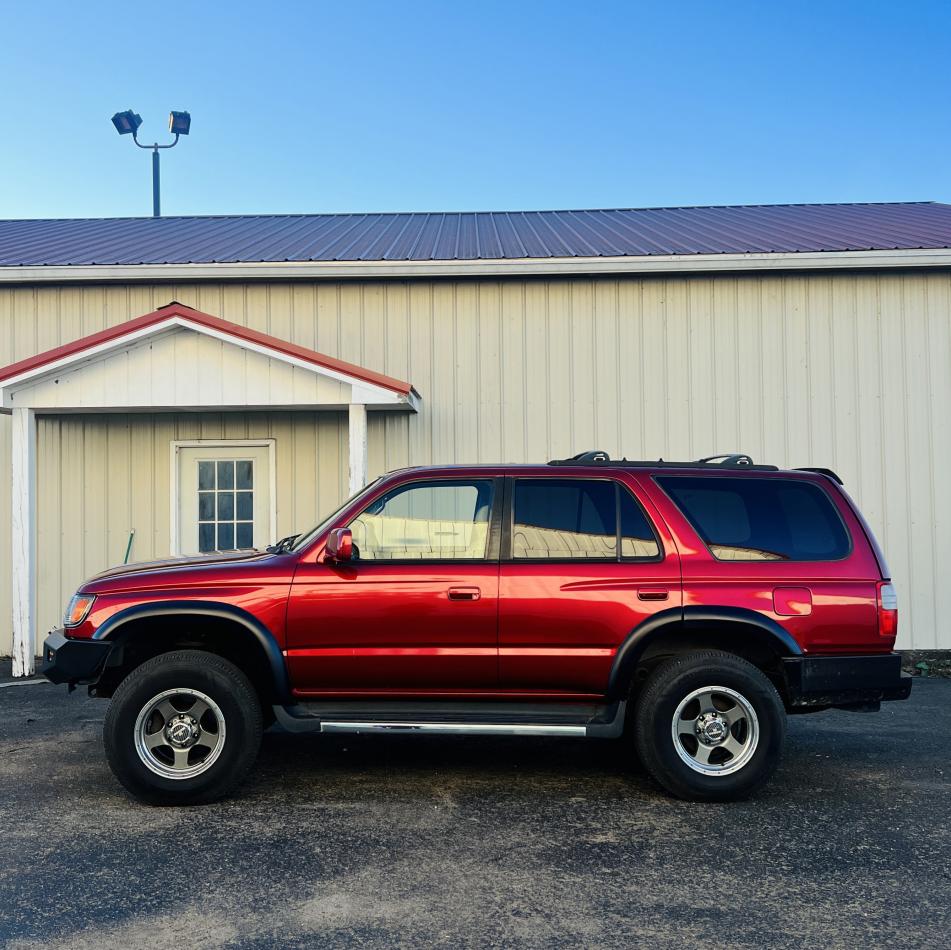

Getting a new radio antenna installed without having the old one??
Hey all,
I am a brand new member of the 3rd gen 4runner club, bought my 1999 4Runner SR5 a few weeks ago (see pic!).
The previous owner said he threw away the old antenna (along with the antenna power motor) because it was broken. There is just an empty hole there now, and no way to listen to the radio.
I would like to have a black "stubby" static antenna installed, but I am a bit stumped on exactly what i need to purchase since i dont have any of the old antenna parts.
Any help/direction GREATLY appreciated. Thank you!
-Courtney
Hey all,
-Courtney
Congrats and welcome! 99-00 are the best years, IMO.
Look up taco whip antenna mod. You'll need a standard, non-motorized antenna base and then the antenna of your choice.
What front and rear bumpers are those?
