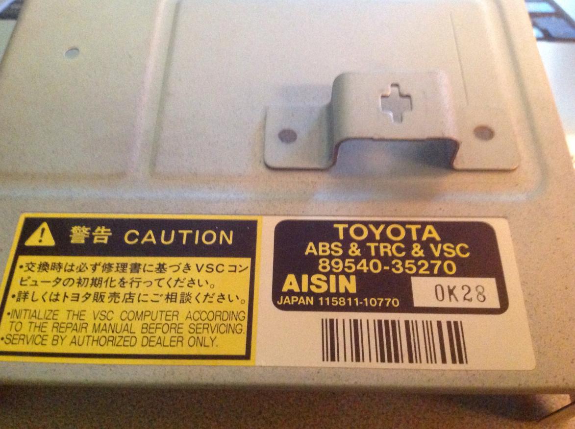

Purchased 01 with bad VSC module, There's a reason (don't know why) 15" 16" makes a difference or the effects.
Use module your VIN specifies for OE wheel size.
You may have lucked out with a mix up, all I can think of, Good Luck.
Mines an 02 and I ended up getting the same part number as the original one. #89540-35270. Just don't know what to do anymore for it.

I ended up doing Andy MOD 2.0 which fixes the VSC problem of killing my engine power, but my abs still kicks in when i brake every time. Do you know where the ABS computer is located or is it the same part that i replaced?

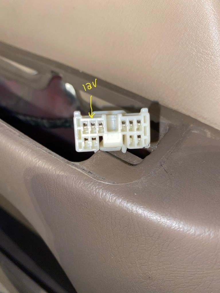

My side mirrors will not move anymore from the controls.. I have checked the fuses. They're all good. I replaced the controller on the drivers door still no luck. For some odd reason there is no power going to the controller..

Where the wiring runs out of the body and into the door is a known failure point on these cars. That would be the first thing I would check. I'm not sure if a broken wire in one door would affect both mirrors though.
This video is for the rear hatch, but covers the same issue of broken wires and how to repair them if needed.
Edit: Just reread that you don't have power going to the the controller, have you actually checked to see if you have power at the connector that plugs in to the switch panel?

No there is no power going to the connector at all. (the pins show no power when I use a multimeter)
I just took apart the door panel, and all the wires look perfect. No cracks or exposed wires..
EDIT:
I actually do have power..
Only on this one pin though..
EDIT EDIT:
I have power on all pins once I press a button on the switch. Do you think possibly a bad ground could cause this? And does anyone know where the ground is for this switch [emoji23]
Not sure what to do now damn it..

What year is your 4runner? I only have electrical diagrams for my 2000, and I know that year to year there are differences, if you make the request someone else may have the diagrams for your year.
Based on the diagram for my 2000 (Attached) that is pin 9 which is the only pin which should have power. Pin 10 which is the pin to the left of the pin with power in the photo you attached should always have continuity with ground. The rest of the pins are used to distribute power based on the switches being pressed. Assuming you have a 2000 or at least the same mirror wiring as a 2000, and you have 12v pin 9 to ground and continuity pin 10 to ground, then you have power and it is either both mirror switches you have tried, or it is a problem with wiring running from the switches to the mirror motors.
Thoughts if the black module on the brake master cylinder could be causing the ABS to go off while i brake every time (with ABS1 fuse in).
Not being able to get the ZP Cal to complete I think is the problem.
The MC is working, it's just confused. The sensors you replaced tell orientation of vehicle to module, module telling MC to do it's thing.
3 relays for system on right inner fender could be a problem, I doubt it because system is kicking in, worth checking I'd say.
Troubleshooting Info is limited in FSM brake section, net not much help either. Toyota used last two years of 3rd gen to get it right for 4th gen.
Ah i see. I replaced one of those relays back in Feb. Which fixed a code problem. The other ones seem to be alright. I just don't not know what else to do to try and get to ZP cal.
