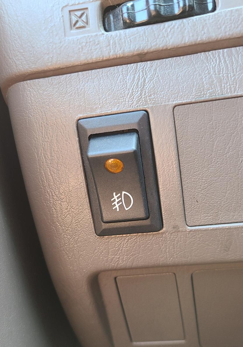

Anybody know how to get these little buggers (00 Camry fog light switch) to illuminate when turned on? I assumed it would by default but apparently not. Presumably it needs to be tapped to a 12V circuit in the dash? Im currently using it for an LED bar wired right to the battery on its own circuit

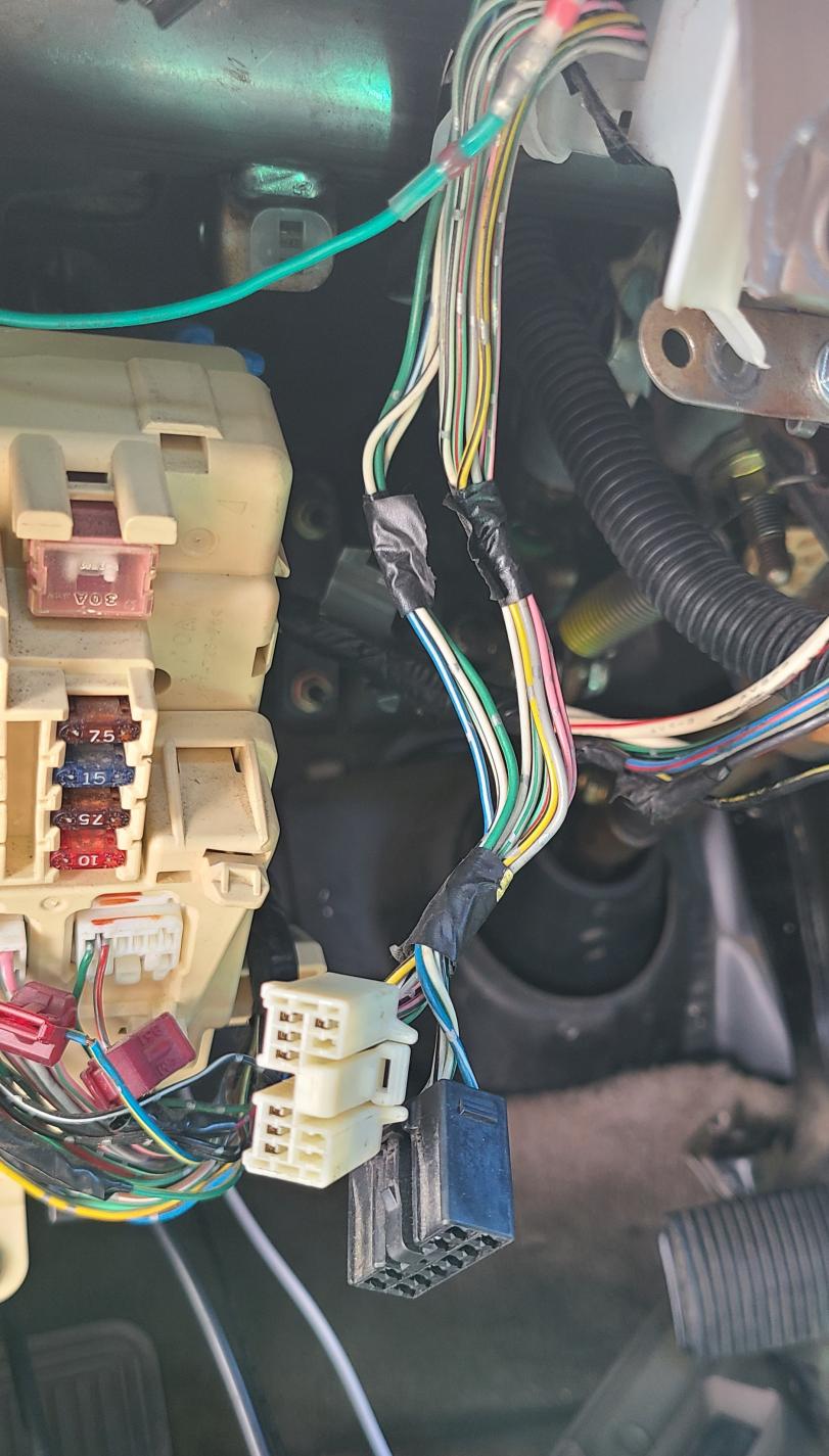

Anybody know what these mystery plugs might go to? Found them tucked behind the dash when I was removing the aftermarket remote start the PO had installed. Can't seem to find a spot for them anywhere so I'm assuming it's for some option with Limited trims?

locker écu plug and diff lock switch plug
