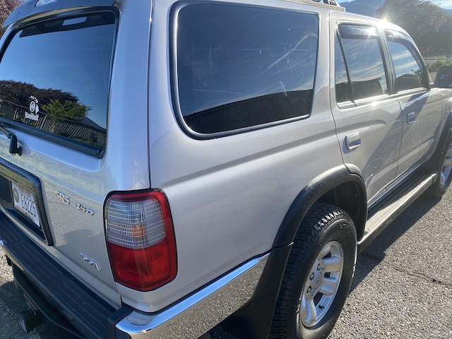

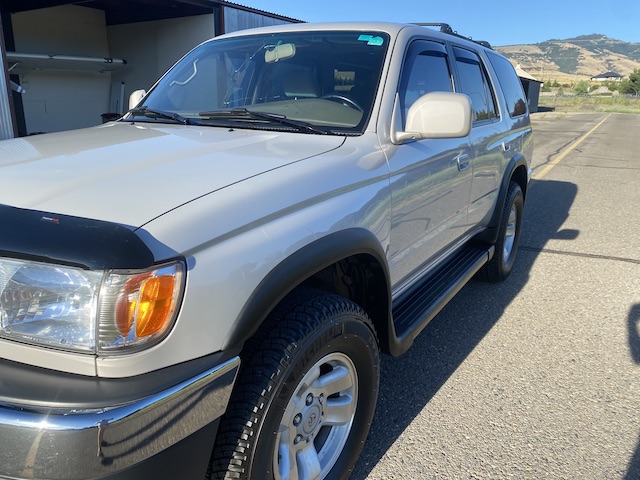

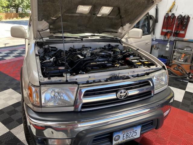

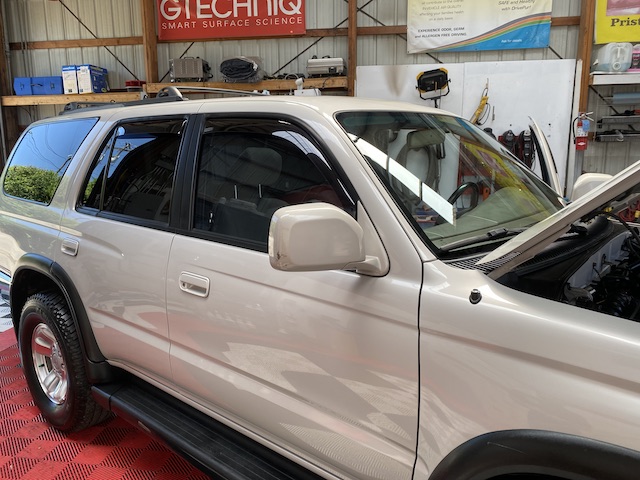

Hello everyone, I just got my 2000 4runner completely tuned, all fluids changed and completely detailed inside and out. (See pictures) Essentially this truck is bone stock, everything functioning, all parts installed. I had it completely detailed inside and out and had all the door dings and minor dents pulled. I have a laundry list of items I’m doing or considering doing. I plan to be able to use this rig on tough trails, no rock crawling. I’d like help and advice from the community who are better tuners than me. I’ll post some pictures soon.
1. Right now I’m changing out all dash lights with LEDs. After trial and error and watching a few YouTube videos, I’ve found the right part to upgrade the instrument cluster. Amazon.com: DODOFUN White T5 37 74 LED Bulb with Twist Lock Socket PC74 PC37 Dashboard Instrument Panel Gauge Cluster Light Pack of 10 : Automotive I recommend these LEDs as the best option. In the cluster there are 2 types of bulbs. There are small bulbs (black twist sockets) in the twist sockets that light all the D, R, N and other engine related lights. There are the 2 slightly larger bulbs for the cluster backlight (green twist sockets) both with the green rubber boots. (see picture) I’m completely doing a white light refresh. I used the same LED as above for both lights and seems to work fine. I also used these LEDs for the climate control, gear shifter, key ring light. I also found a complete refresh for other interior lights LED kit on Amazon. Amazon.com: DODOFUN Interior LED Light Kit Compatible with 1996-2002 Toyota 4Runner ( 13-pc Bulb 6000k ) : Automotive Great kit for the price.
2. After market cabin air filter. Is there any modification I can add to the intake cabin air which would allow me to install a filter box? If such an animal exists I’d love to know, order the parts and get it installed. Love to not have dirty dusty air coming in when I’m on the trails.
3. New programable fob. I tried buying an aftermarket fob on Amazon. it didn’t work. Even had a Toyota factory mechanic try. Didn’t work at all. Are there any good aftermarket fobs without having to spend $$$ at the dealer?
4. USB cigarette lighter upgrade. I want to upgrade and replace the cigarette with a USB port that will fit in the receptacle, preferably using the existing connections. Any suggestions?
5. Ashtray modification. Is there something else I can install to make better use of this space? I don’t smoke and wouldn’t in my freshly cleaned 4runner.
6. Keysets. I have a new ignition switch, original one is beginning to wear out. What is the best way to match the ignition key to match the existing door-locks so I have only one key? Can a locksmith do this easily?
7. Fluid change schedule. As I already mentioned I’ve changed every fluid during this last service. Is there a better reference for fluid changes? I want to stay on top of fluid changes because I understand it’s the best way to preserve the life of your 4runner.
8. Roof-rack. I there a more robust aftermarket roof rack out there? Should I bother dropping the headliner and upgrading to something stronger than the original?
9. Moonroof service. I found a local body shop that I know owner who has done sunroof work on a highlander and sequoia. Quoted me about $600-800 assuming nothing breaks. Still working right now, but becoming physically sticky. He will lubricate and clean all the tracking and remove any debris from the rear. I think it’s worth doing.
10. Left side oak seat post cover. I’m missing a plastic seat post cover. These pieces are becoming harder to find. Spoke with the dealer and learned Toyota is ending much parts support for 2004 is disappearing. You cannot specify the color of these pieces anymore unless there is stock remaining.
11. Seat covers. My original seats are in excellent condition. No rips, tears stains or failing materials. I want to keep them that way. I’d like to get a quality custom fit set. Any recommendations?
12. Rear center brake light. Is there an aftermarket LED replacement? Seems to be the only thing I can’t find in LED.
13. Running boards. I want to remove the running boards and replace with bumper steps to improve ground clearance. What would you guys suggest?
14. Radio. I still have the stock radio! It works but LED panel is failing. I want to put in a new iPhone compatible touchscreen unit. Then replace all the speakers and probably rewire. will be a project.
15. Finally want replace stock bumpers. ARB bumpers or equivalent is what I’m thinking. Would also like to put an integrated winch on the front. What are the other options.
I’m sure there are other threads on these topics, so just post me a link if you see one you are familiar with. Sorry for the long post and thanks for the help ahead of time.
Cheers
