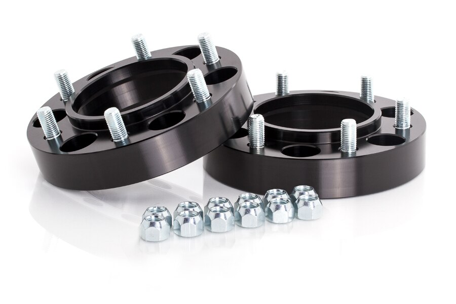

Are extended lug nuts necessary with 1.25" wheel spacers? I am running 267/70/17s with 0 offset and 4.5 backspace.
If so, please provide some examples of what I would need. They would have to be aftermarket, of course, right?
No, the spacers come with new studs already installed in them. You attach the spacer to the truck using the existing studs and the nuts they provide, then attach the wheel to the spacer using the studs in the spacer and the lugnuts.
