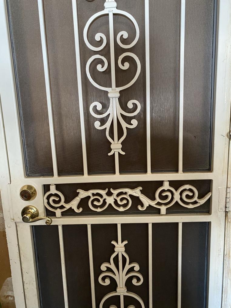

You gave me a super idea for protecting the rear hatch on my 08 4Runner, it will need a little scaling down but i feel it will be a big winner.
Thanks for giving me a idea my fellow forum member and 4Runner owner.:rockon:
