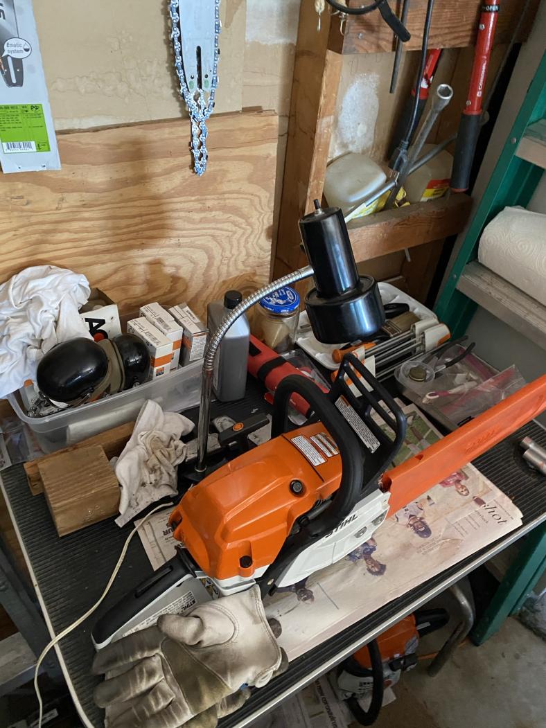

My sweet STIHL Chainsaws say hello.:horn:

Yeah i gotta way of doing this.:playball:
Are they good for cutting out of ice and all? 2-strokes easy to start in 0° weather? Electric start propane / natural gas gennys are a blast though. That, a gas furnace, and I can watch TV and surf the net and wait out pretty much any deep freeze.

One under the bench is a non easy start Stihl cm211 W 16" bar one on table has a De-Comp valve it's a cm261c-m Micro Processor fuel/air adjust has a 18" bar. Both have started in close to zero weather.
Nothing like bucking firewood in the cold if needed.
I have Nat. Gas also a Blaze King President wood stove it has a Cat. I also have a nice big Honda Generator if power go's off.
