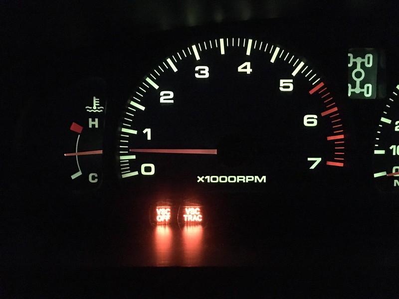

Description:
These modifications will allow you to turn VSC OFF and ON in any driving mode (2WD, 4WD, etc.) with a
flip of a switch. When you have VSC enabled, the factory function is fully restored so that entering 4WD
and locking the center diff will automatically disable the VSC.
The second part of these modifications will allow you to disable VSC and TRAC with the flip of a switch.
Unfortunately, you need to turn the key off‐on again to re‐enable them if you do this one.
The third thing you could do is the ANDY MOD, which disables VSC, TRAC and ABS. It also needs a key
off‐on to re‐enable them. I won’t cover the ANDY mod here.

I just did this on my 2001 as I think VSC can be intrusive.

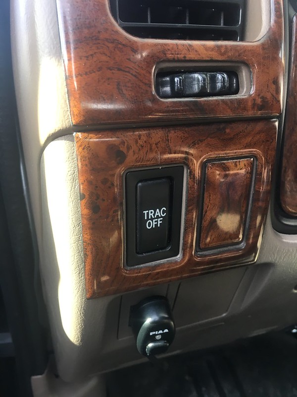

So I was a touch confused how this worked as Relays K1-K4 activate with both switches. Pay attention to K4 and that the ECM is getting 12V when activated with the VSC/TRAC OFF switch.
Reason for wanting to understand, I want to use an arduino with a Toyota Factory Trac off momentary switch such that short click VSC On or Off, Long Press VSC/Trac Off, as nothing else in that area of the 4 runner has a multi position On-Off-On switch.
