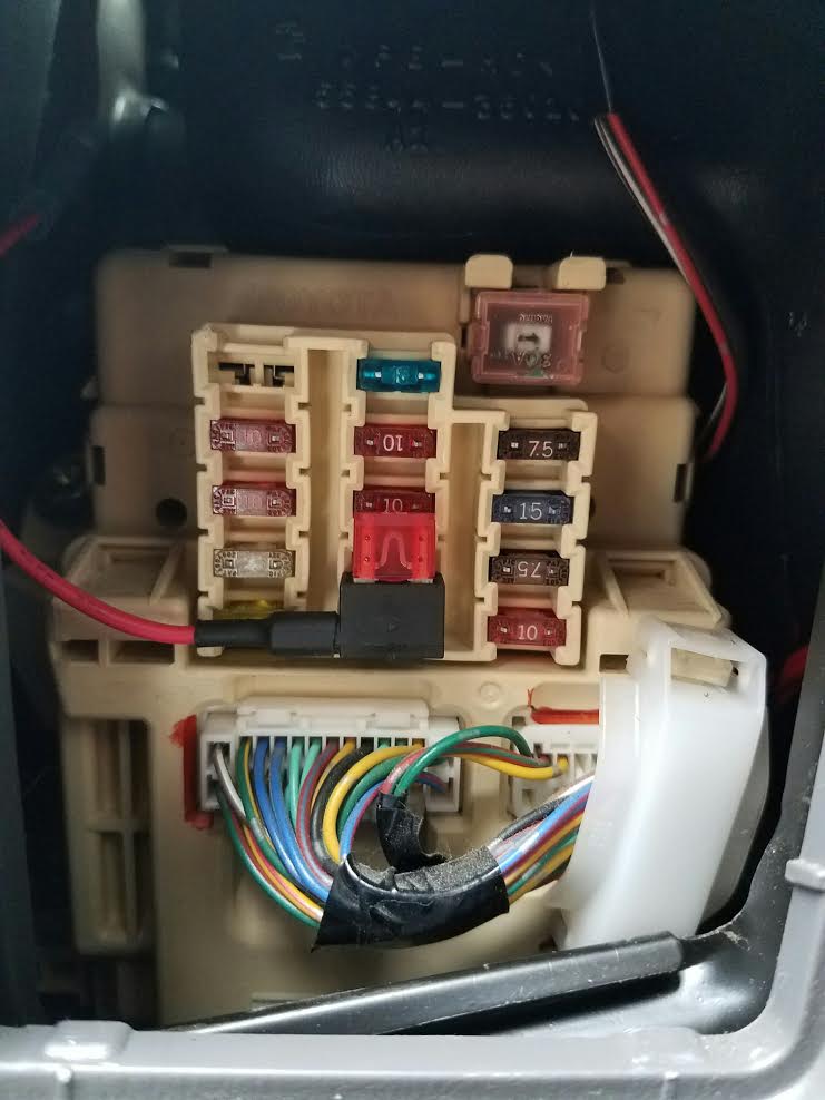

Hey guys, noobie with a first post here! i just followed and did this mod step by step but it didnt work for me. I thought maybe it was a faulty relay from autozone or maybe a bad trac switch from ebay so i got the multimeter to test things out. Come to find out i only have .3 volts coming out of the fuse slot that you used. I had to flip the add a fuse over and use the slot under that one. now it works great! thought this might help in case it didnt work for someone else. Thanks guys this site is awesome with endless information

From here I used 86 as my power and 85 as my ground. My power is coming from an open spot on the fuse block under the dash on the drivers side. With the ground being directly below (picture shows it halfway cut off).
I have the main power from the fuse box running into the TRAC Off switch, and out to the relay (86). You can see the four wires all hooked up here.

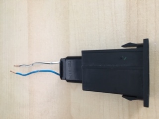

I'm about to attempt the Andy MOD 2.0 on my 02 this weekend. Just got my TRAC OFF switch from [MENTION=102606]infamousRNR[/MENTION] (thanks for that!)
A couple of questions from a complete noob on electrical mods.
1. Does it matter which pigtail on the back of the TRAC switch goes to 86 on the relay and which one goes to the add-a-fuse. On my switch there is a white wire with black tracer and blue wire.
2. What amp fuse should I use in the add-a-fuse. The one I bought says not designed for more than 10amps..

[MENTION=98153]MStudt[/MENTION] can you help me out at all with the above?
I won't matter which way you wire the switch on this particular one.
