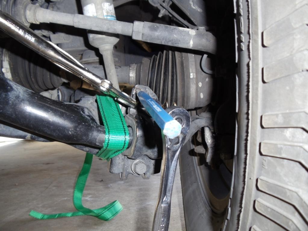

What [MENTION=78273]Jeremy556[/MENTION] said. Here's a pic from the last time I had the front swaybar detached. Took a large punch, ratchet strap, floor jack (not pictured), and vise grips to hold the bracket while I tightened the bolt.

This is exactly what we ended up doing. Ratchet strap ended up being the savior. We almost had it multiple times without it but couldn't quite get it right. Felt like it was about to cross thread.

Yep, trick is to get the bottom bolt started since it is easier. Start tightening the bottom bolt and keep the top bolt hole in line with a punch. When you have the bottom bolt snugged up enough, the top bolt should go right in.
