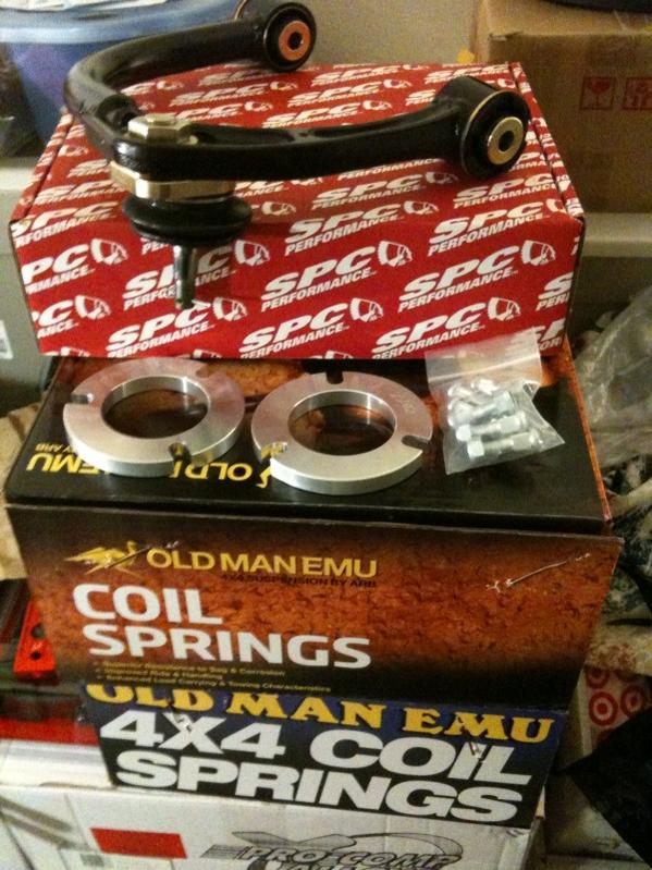

The factory springs are settled! I only got an 1.5" lift in the front with the daystar 2.5/1.5, so its coming out!:dancin: I ordered OME 884/895 springs with the Toytec top plate, and while I`m in there a set of Light Racing UCA`s are getting put in with an Overland Warehouse rear brake line relocation bracket for a little peace of mind!

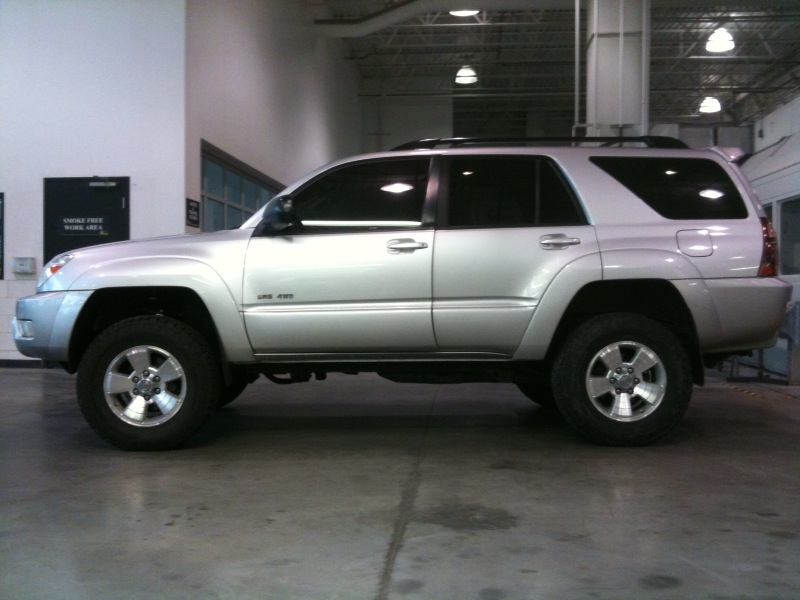

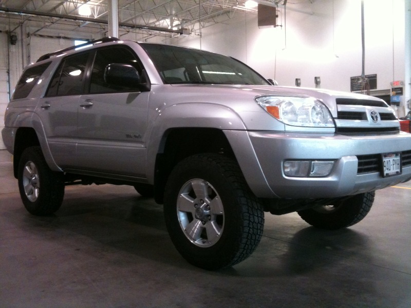

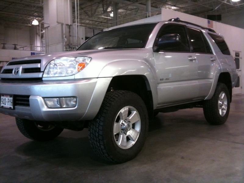

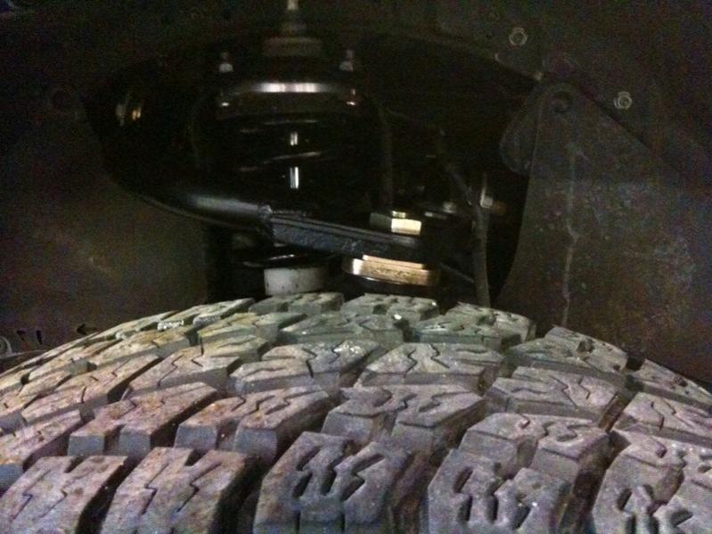

I installed the OME springs and LR UCA`s today! It took 4 hours to install everything.
For those interested, the ride is very smooth and controlled! It seems like there is less body roll in turns and No nose dive during fast stops. The ride is stiffer than with the daystar, but is not harsh or teeth rattling its still comfortable for a daily driver. IMHO the Pro comp es9000 shcoks and es6000 struts do a very good job at controling the OME springs.
The Pro comp es6000 fj struts spec out on paper the same as the OME n140s struts, we`ll see how the Pro comps hold up!
