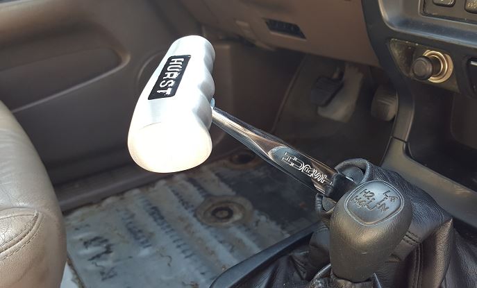

My shift handle doesn't have a shift pattern printed on it, maybe they'll reach for the T-case knob.
I just went to get an inspection sticker the other day, drove up to the bay. The inspection guy in his 20's went to jump in to drive it inside, he jumps back out, he said "Can you drive it in for me?"
