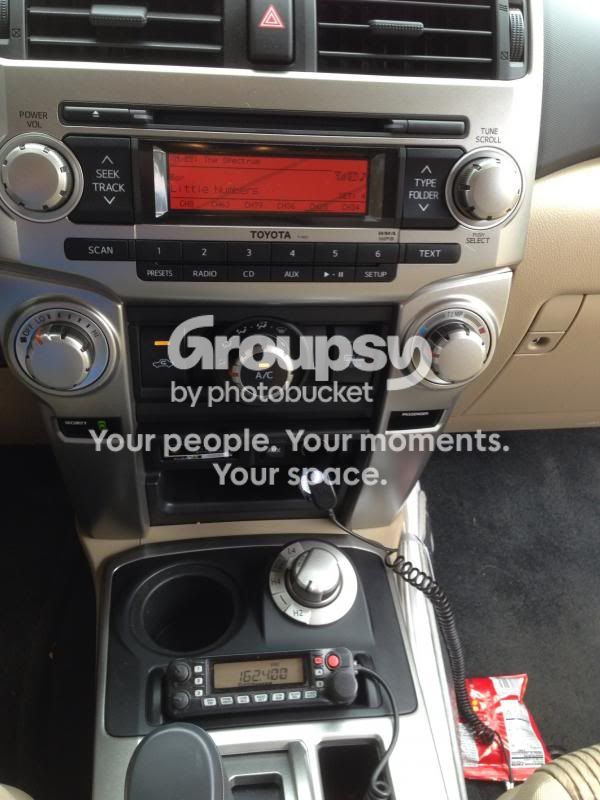

Next up I needed my ham radio and 12v fridge installed. The radio was the easy part. After setting in the runner for an hour or so I finially found the perfect place for the remote head of my ft7900r dual band radio.

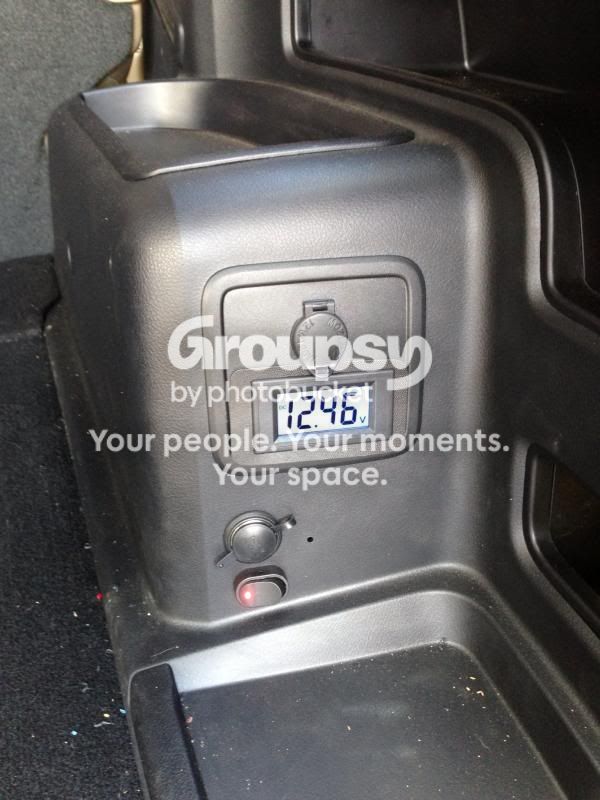

With the remote head mounted I placed a small radio shack speaker under the front seat. Then I focused on the rear for the 12v fridge. With no real option for a 12vconstant on the 5th gen I wired an aux 12 v plug straight to the battery with a fuse and 10g wire. One thing I wanted however was the ability to moniter my battery life while setting around camp. Without a dual battery I worry I may be left stranded. So after some thought I wired in this...
Since the plug is 12v constant I ran a switch to the volt meter so I can switch it off. The meter itself uses about 1 amp and I only need it when checking on the status of the battery.

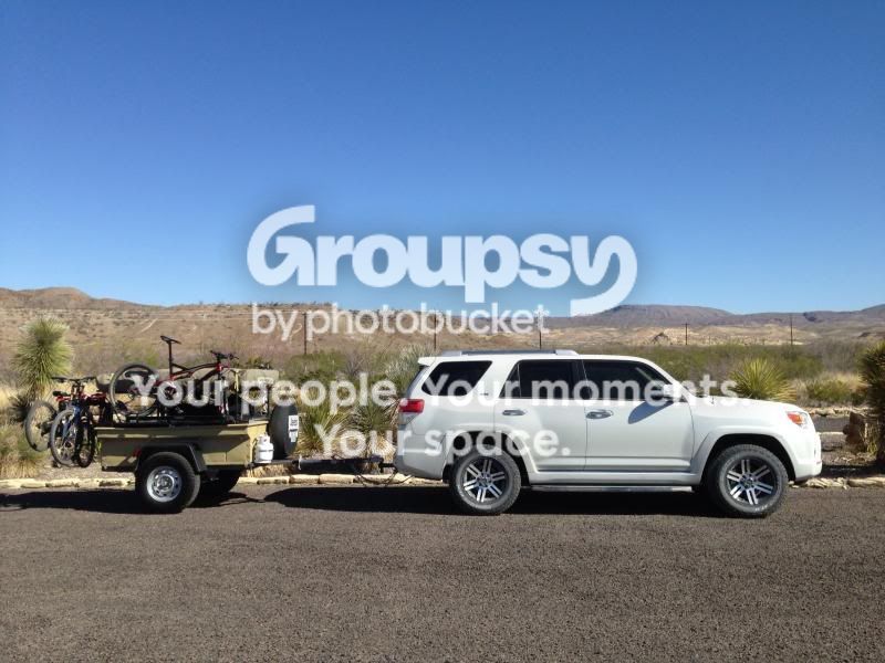

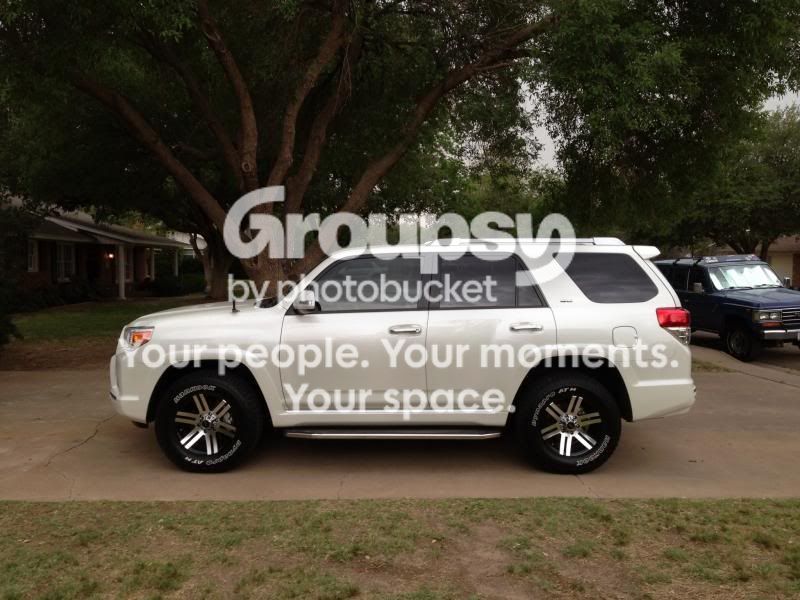

This year I decided it was time to build a better truck to pull it with. Having built several landcruisers I knew I wanted a toyota. So I purchased a shiny new 2013 4runner. Next the fun started. With less than 100miles on the ticker drove it straight to the tire store for new rims and some 265 Hancook AT tires. Here she is with the new tires and wheels..
Then I left for a 600 mile off road trip to BiG Bend to see how she did.

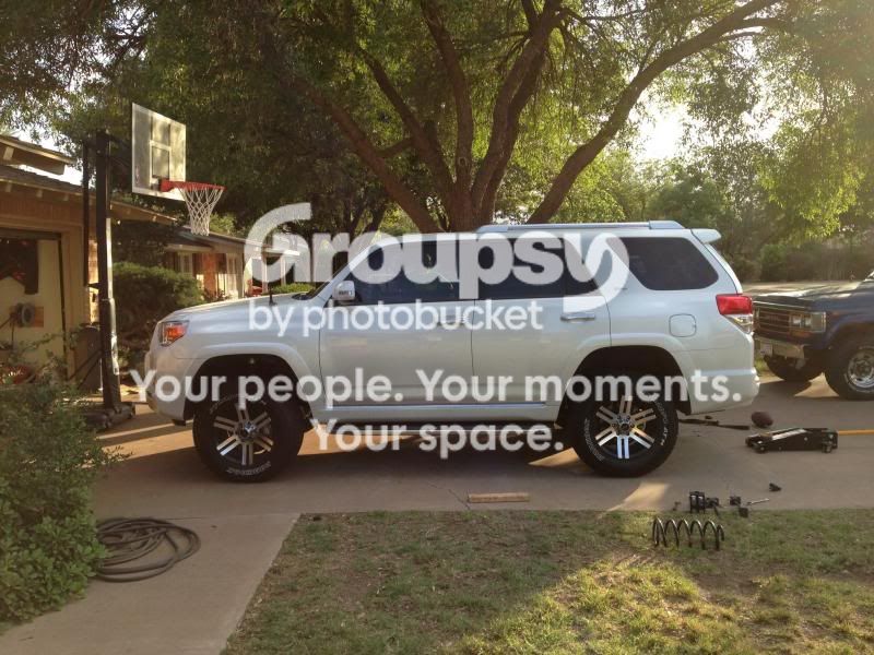

After I got home the 4runner was 1 week old and had 750 miles on her (500 of which was off road miles). After the trip I realized I really need a lift. So I called up toytec and ordered a 2" lift. Here she is with the lift on..
Ahhhh much better.

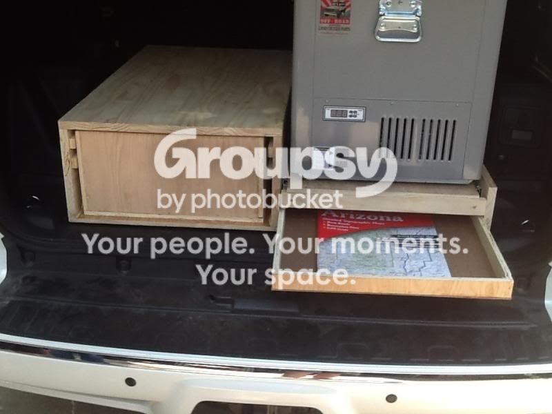

Next I needed a fridge slide and drawer for my junk. Even though I got the toytec mid/heavy springs I wanted to keep it light and functional. My requirements for a drawer system were:
1. Kind of light weight
2. Fridge slide
3. Safe ( I worry about having a high speed wreck and it coming apart)
4. Uses space wisely
5. Has a special place for maps
After countless hours drawing, thinking and redrawing, I came up with this (pictures are before I put the front drawer plate and the finishing hardware and touches on it)
