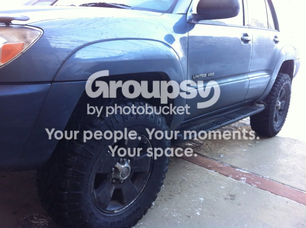

Looks good!! any pics with the 285's and All-pro spacers installed?
Also curious about the custom skid plates you have listed.
Thanks Darkie! Your build is an inspiration for mine. Pics with the all pros and the 285s coming soon, Either tomorrow or the next day, I didn't get the right amount of extended lugs from all pro for some reason, whether it was my mistake or theirs, so depending on when I get those, I'll have the pics up as soon as possible!
Also, for the skids, my buddy works at a fab shop, and with some left over metal from another project of his, we fashioned a front, and middle skid. We're still ironing out the kinks in the skid, because we had a few problems the first time we put them on, so they arn't on at the present, but they are coming in the near future as well.
Just thought I'd add a few things I have done to get where I am. Still anxiously awaiting the 285 and spacer installation!!

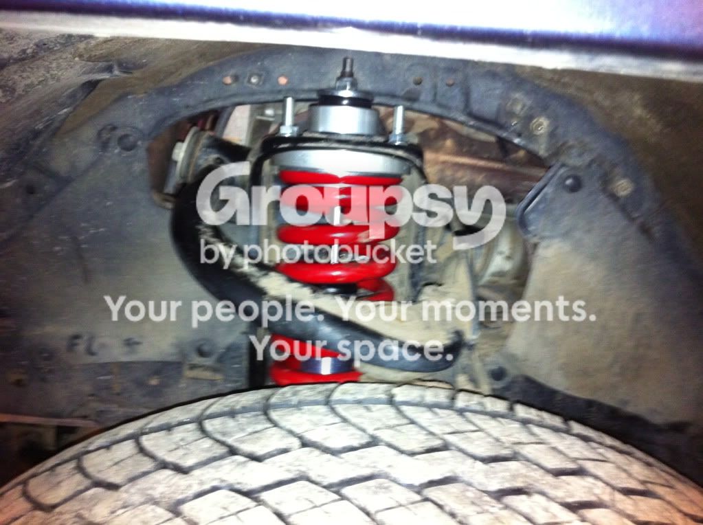

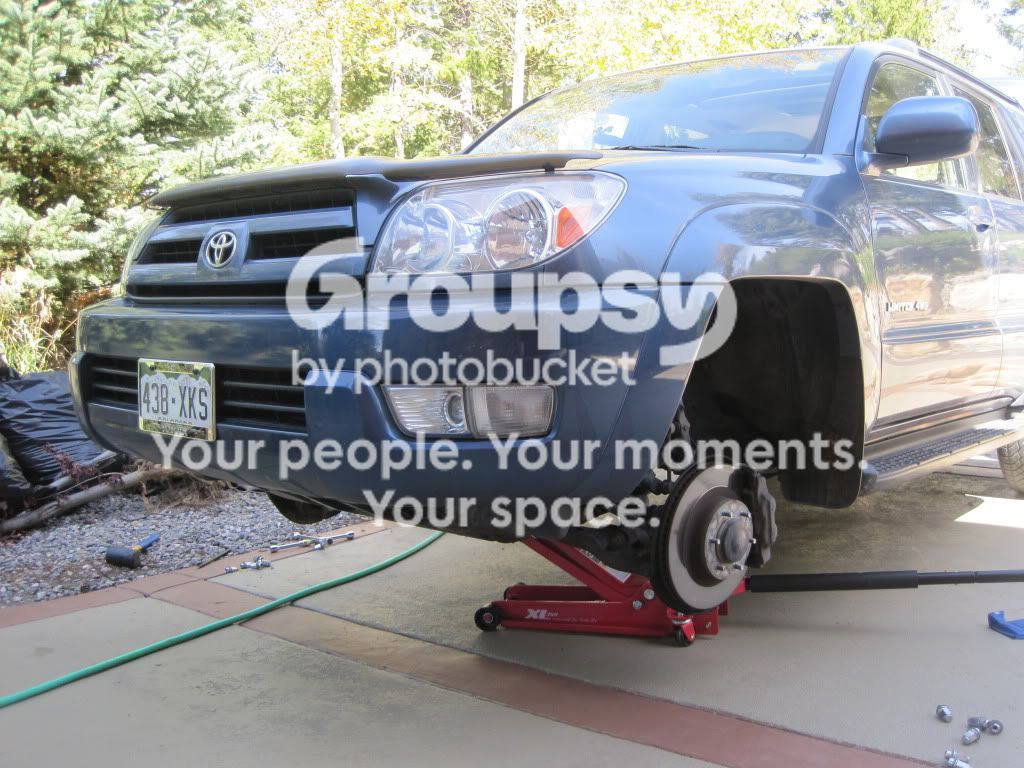

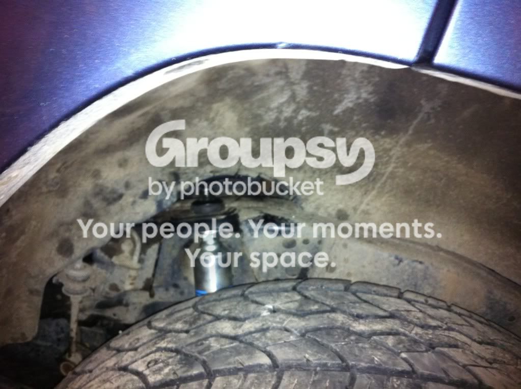

Next, the Toytec Ultimate LIFT! I set out doing this lift with little experience, but boy am I glad I did it myself, Its great to know everything about your car, and I'll tell you, I know a hell of alot about 4runner suspensions now. (also tip from experience, don't unscrew the bolt on the shocks that connect to the XREAS, just saying)
I started outside, with the front because it is the most time consuming, and jacked up the car, removed the wheels, and placed jackstands under the frame.
IMG_6410.jpg~original

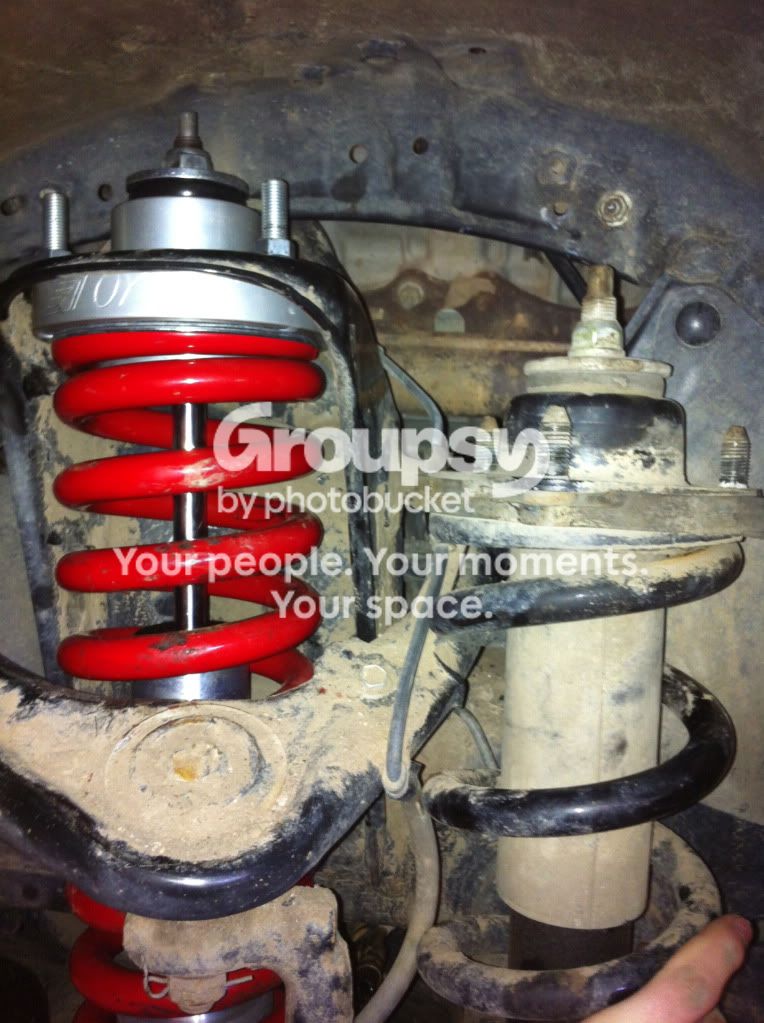

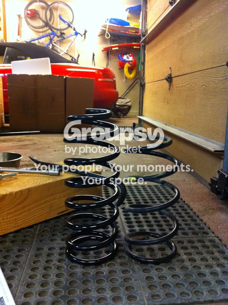

Comparison of the front coilover I removed, and the toytec one
IMG_1006.jpg~original

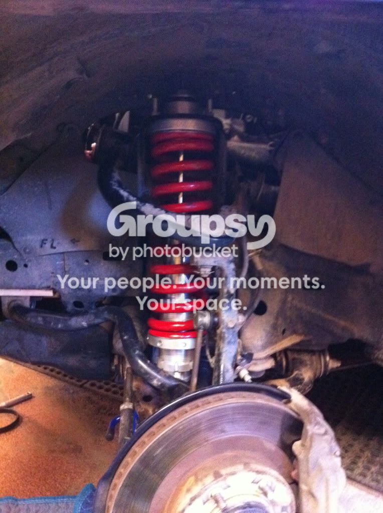

Coilover finally installed on both sides, after the impact wrench broke, and the torque wrench.
IMG_1005.jpg~original

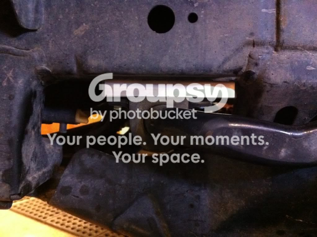

Sway bar relocate
IMG_1004.jpg~original

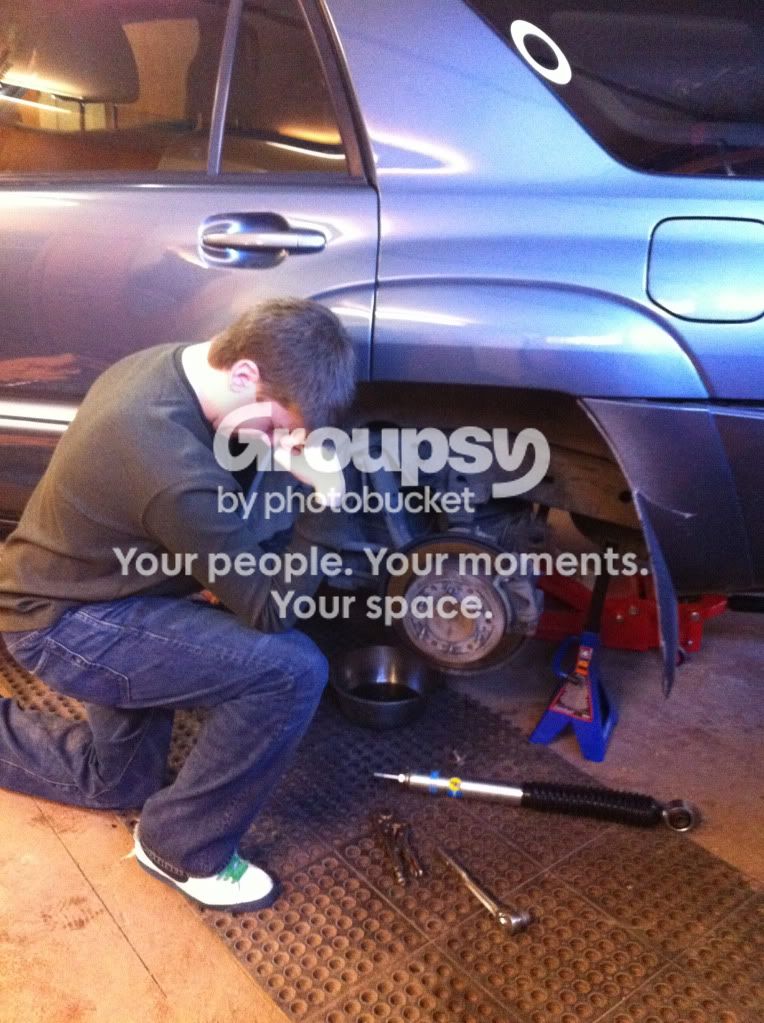

Had to do some banding to reach the nut on the top of the rear shock

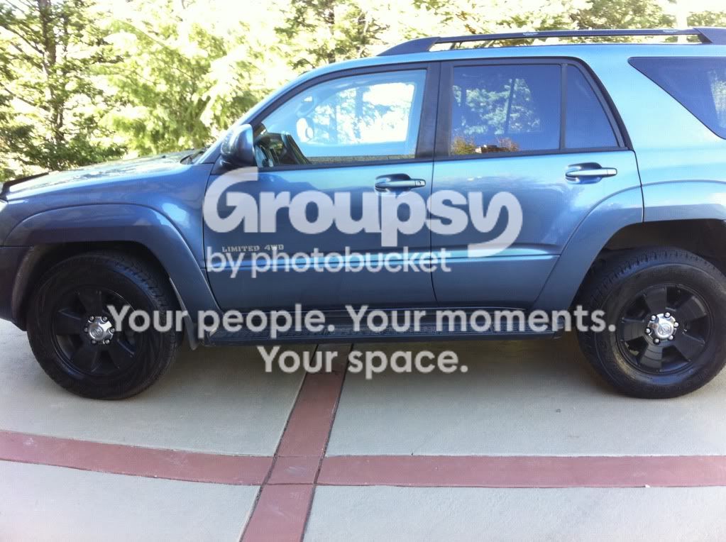

Now shes lifted

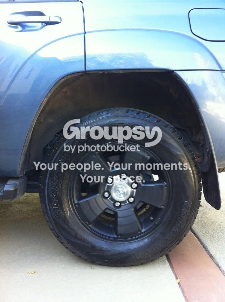

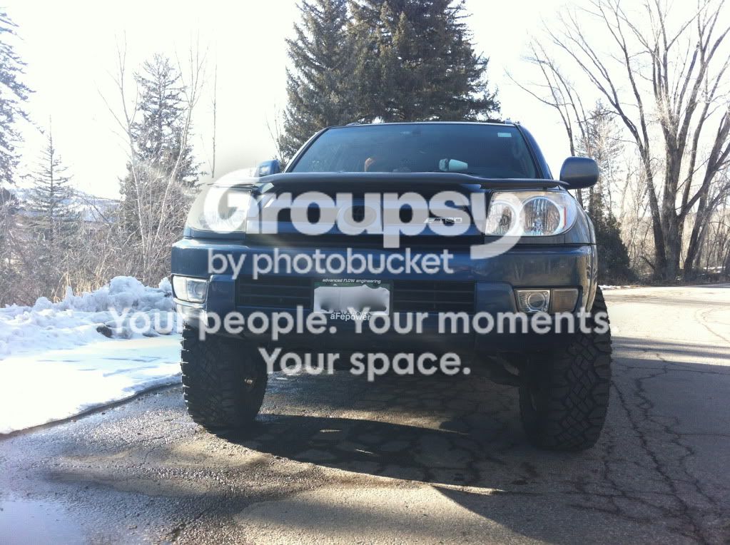

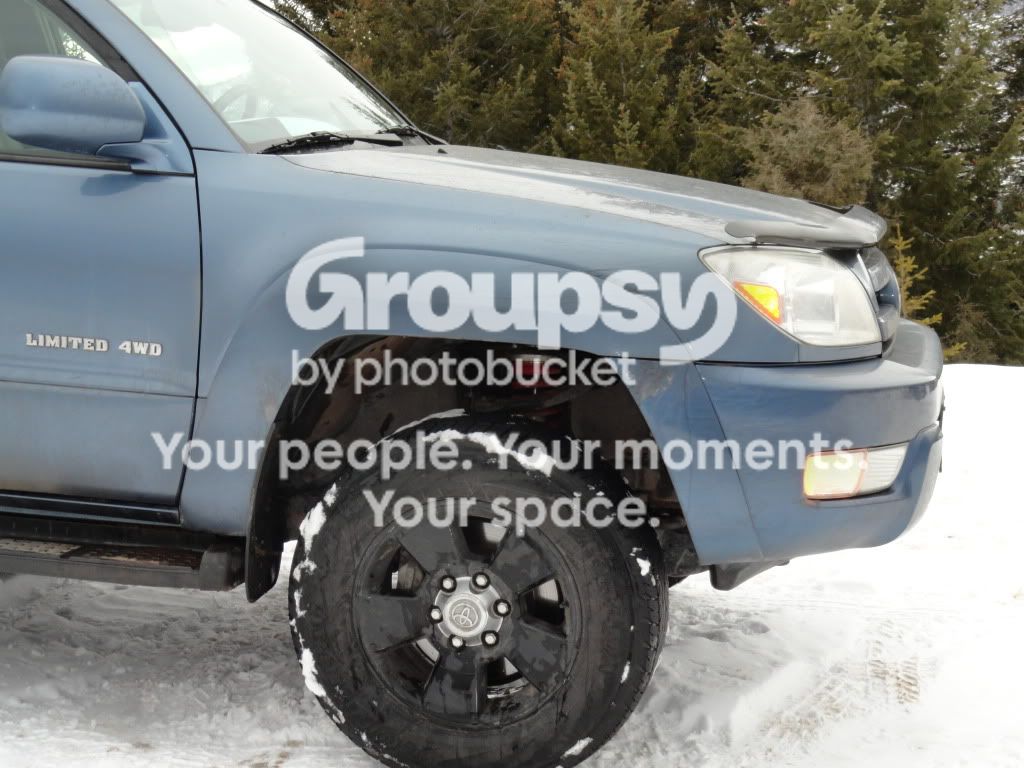

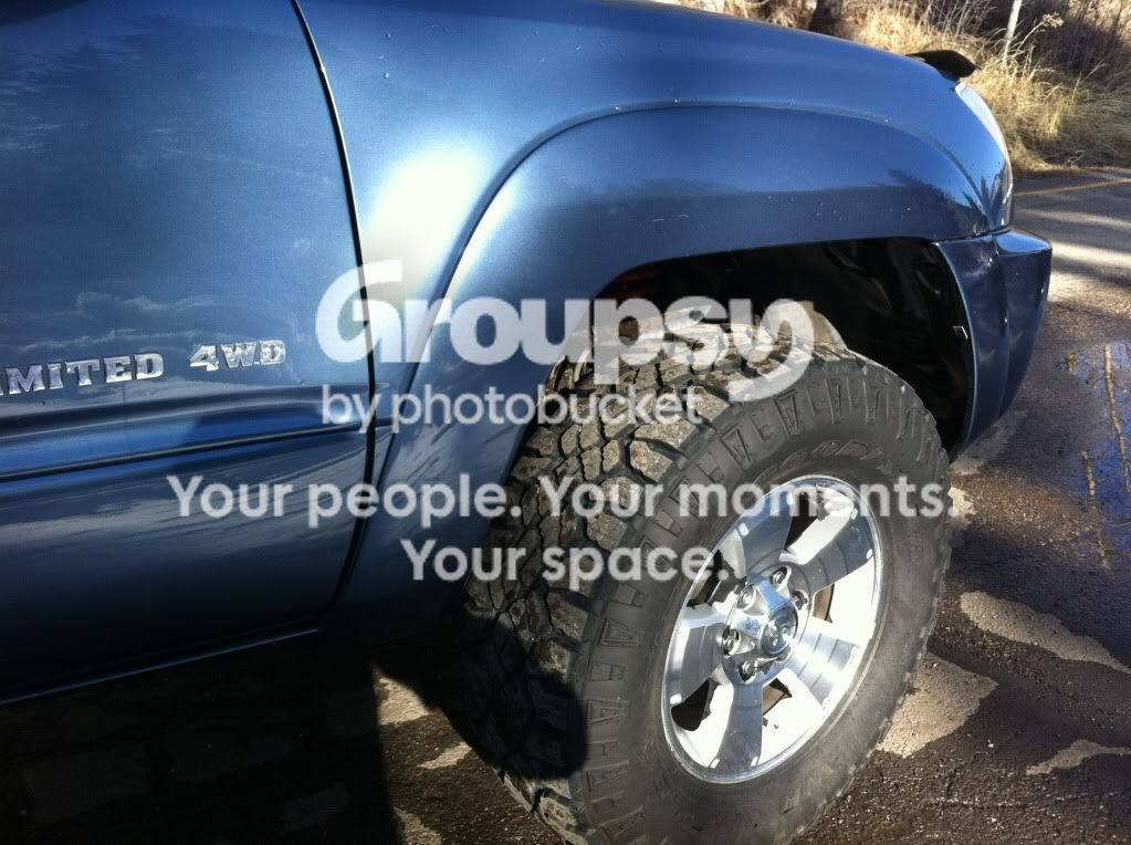

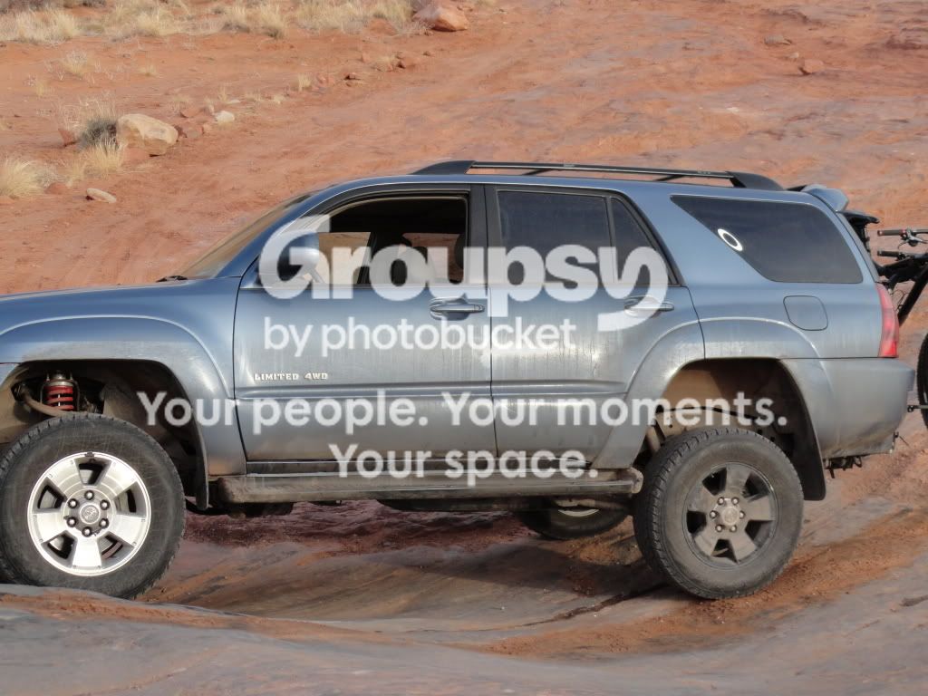

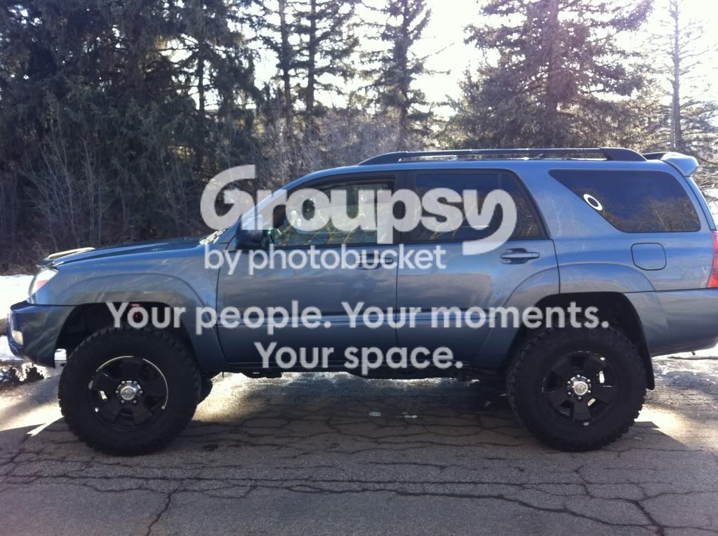

Totally forgot to update this thread when I put my new tires and spacers on. So here it is, I'll snap a few cleaner pics tomorrow as well.
IMG_1094.jpg~original
IMG_1110.jpg~original
IMG_1109-1.jpg~original
IMG_1107.jpg~original
