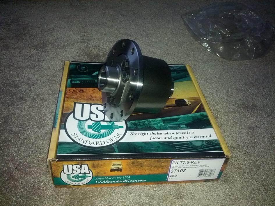

-Detroit TrueTrac front

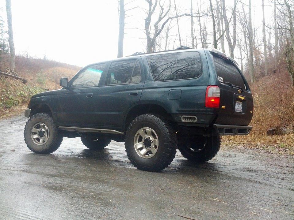

How it sits now

Detroit TrueTrac will be going in the front hopefully in the next 2 weeks!!! along with; LCA bushings, struts, upper BJ's, Lower BJ's, Front brake lines and new CV's

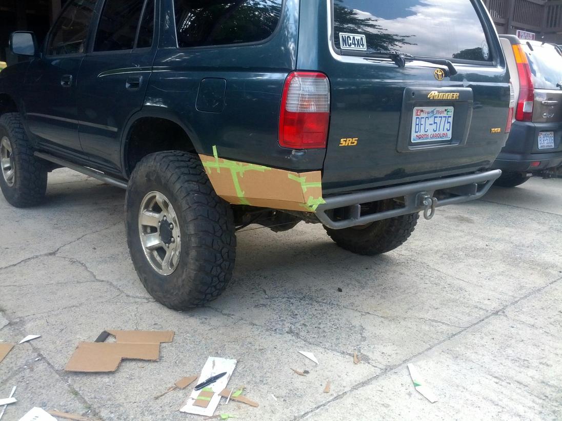

Made templates and sent measurements off to lazer cutting to finish up my rear bumper.

luckily i get pretty good deals on steel from my work, but I'd say you wouldn't be more than $100 in materials for a set of sliders and a bumper.
I used .188 HREW for the sliders and bumper, that will save you a lot of money over DOM.

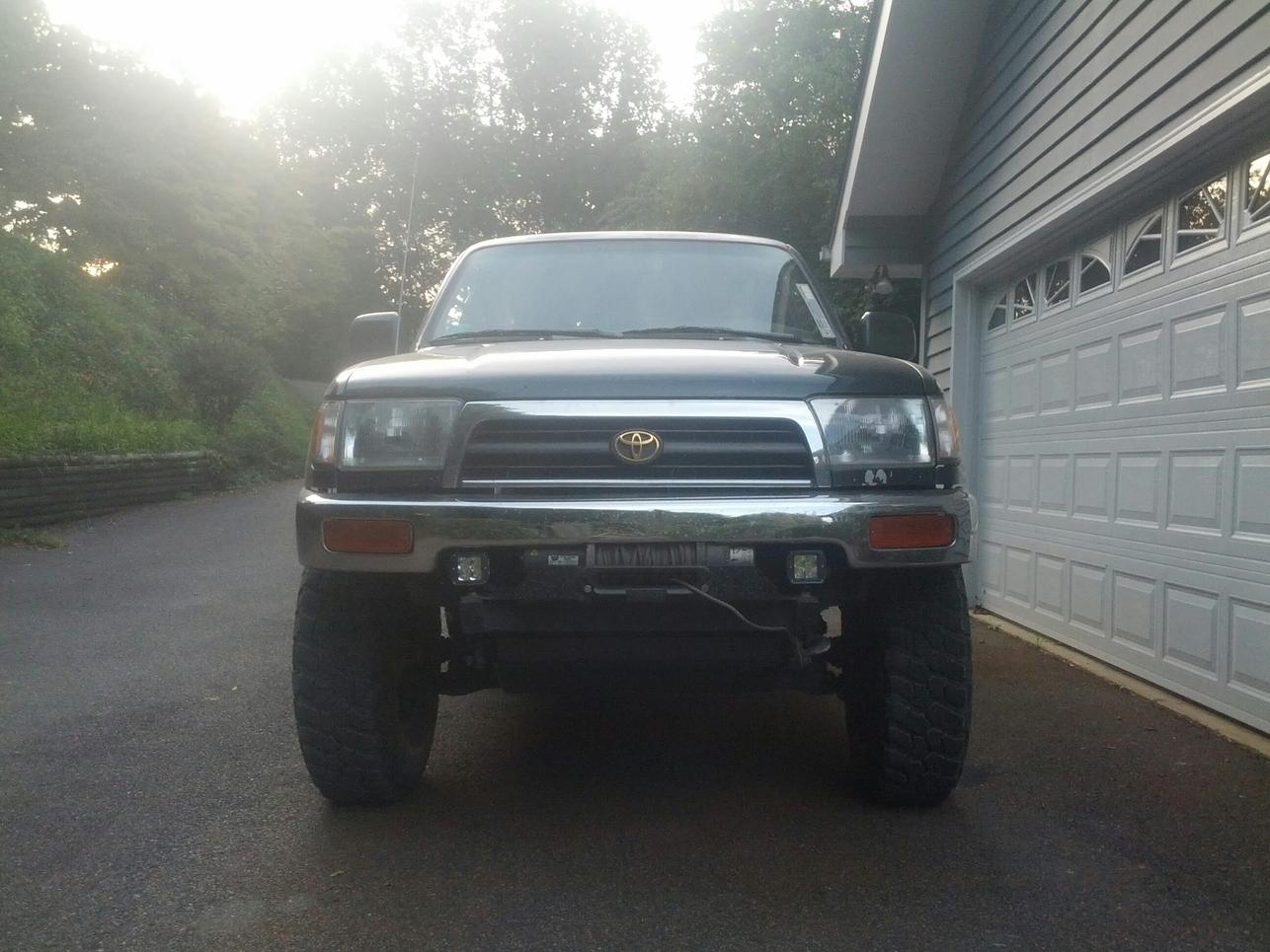

here's some work from last weekend
got my pod lights mounted up
My roller fairlead was all busted up and I found a steel hawse fairlead in town for $10 so that was a nobrainer.

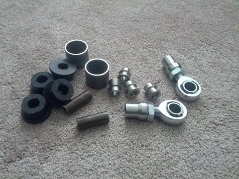

Also ordered some bushings and 3/4 heim kits from ruffstuff to start building my upper links!

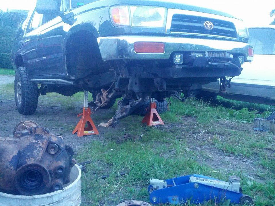

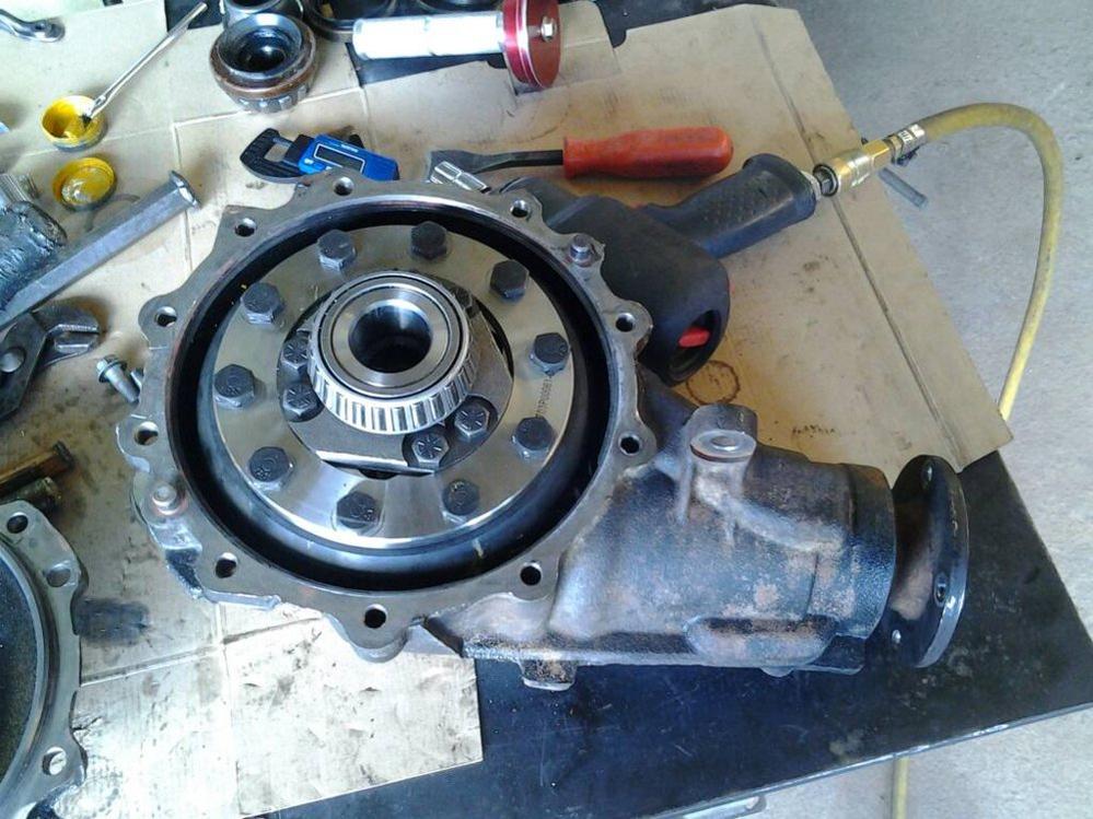

Well got the front diff out and sent off. ill be picking that up thursday.
Now to start replacing my bushings and ball joints. yay.
anyone have any tips on how to get the LCA bushings out?
we put a bottle jack between the arm and tried to push them out and they dident budge a bit!

USPS delivered some presents today! :)

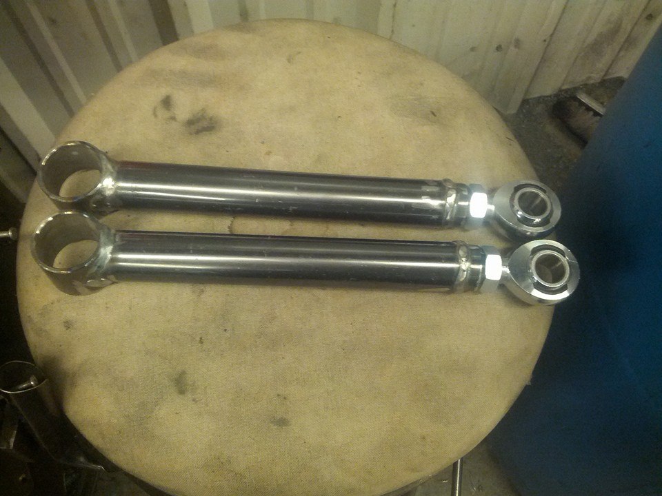

Got my control arms done and ready for some paint.
