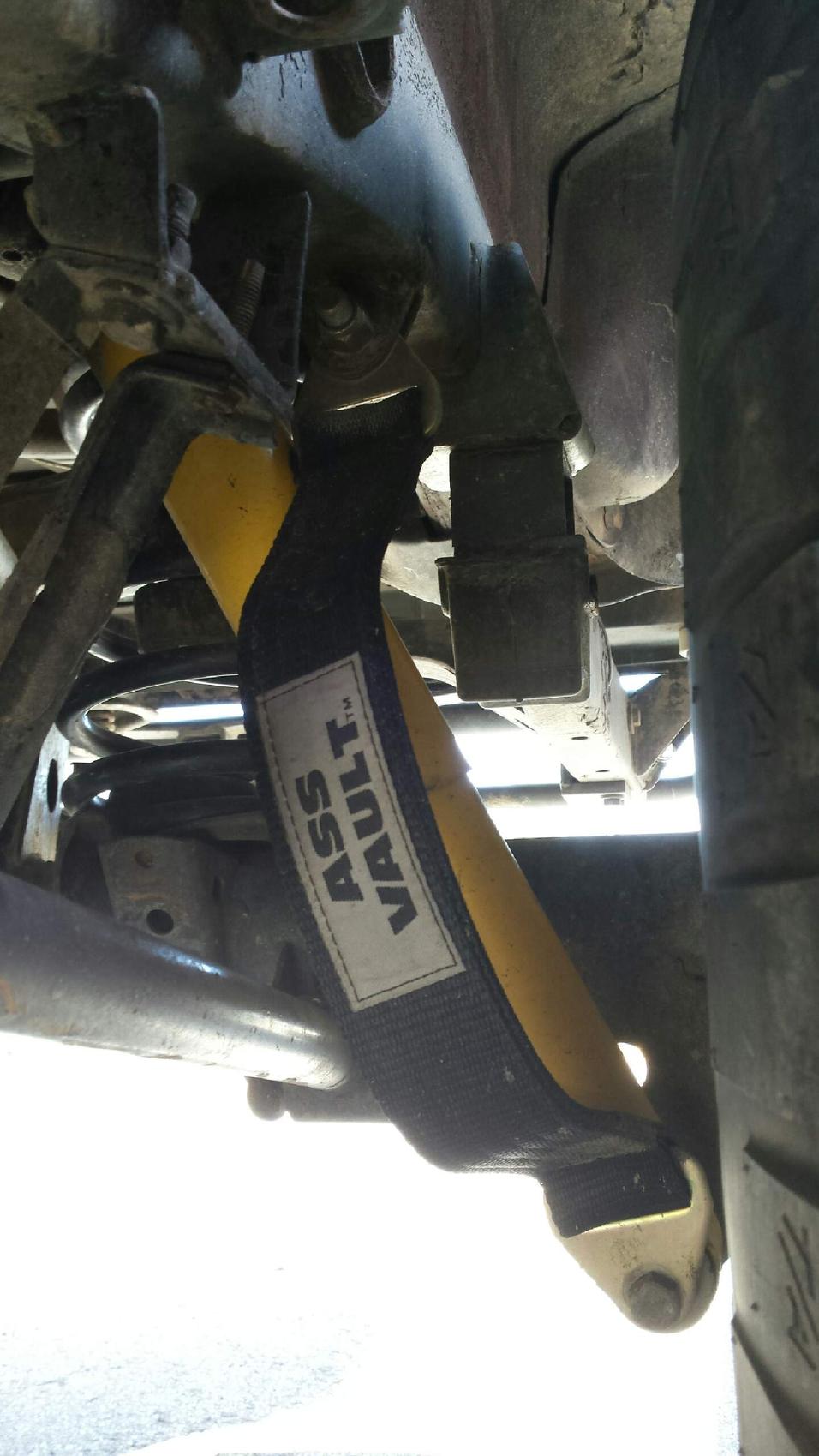

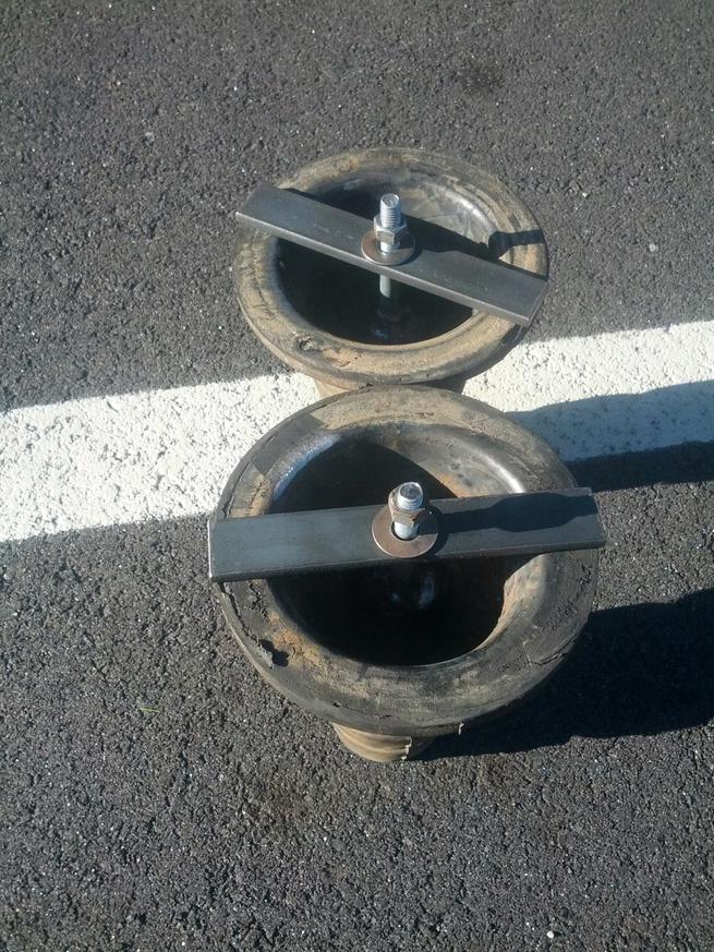

Modified my rear "in-coil" bumpstops to bolt up to the frame so i dont cringe every time my rear springs re-seat.

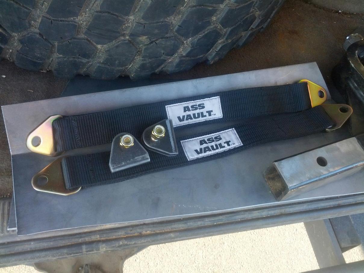

And more goodies from Ruffstuff. Some 20'' "ass vault" limiting straps to keep my rear shocks happy.

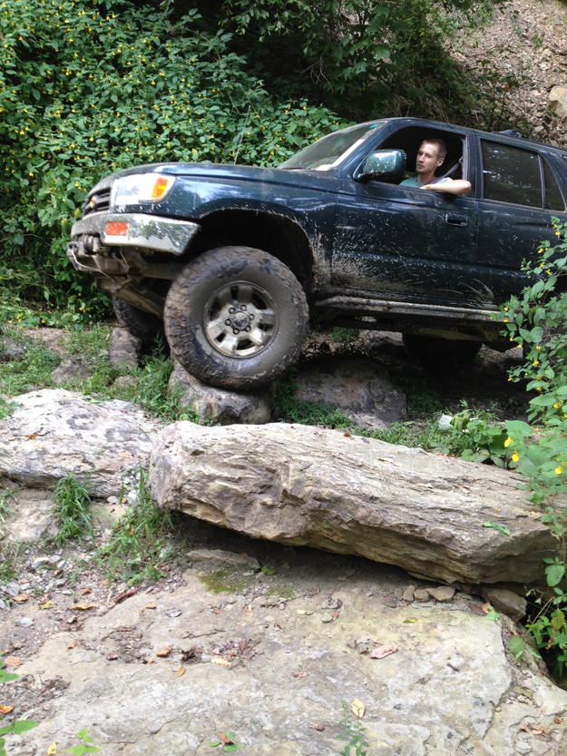

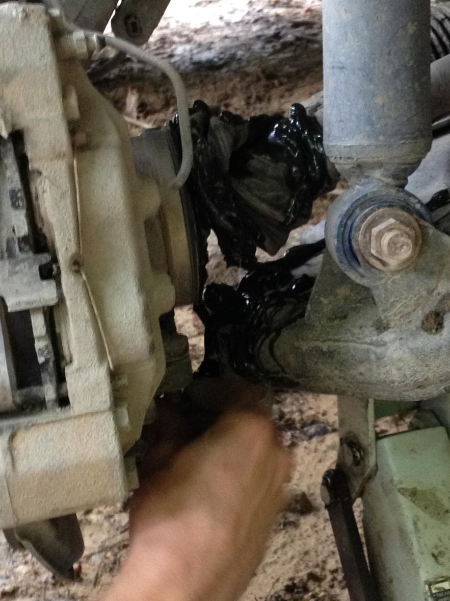

Well made it back from my first trip to Harlan. We had a great time and met some good people. I wish we had more than the day and a half to ride, I feel like i didn't even get to see half the park.

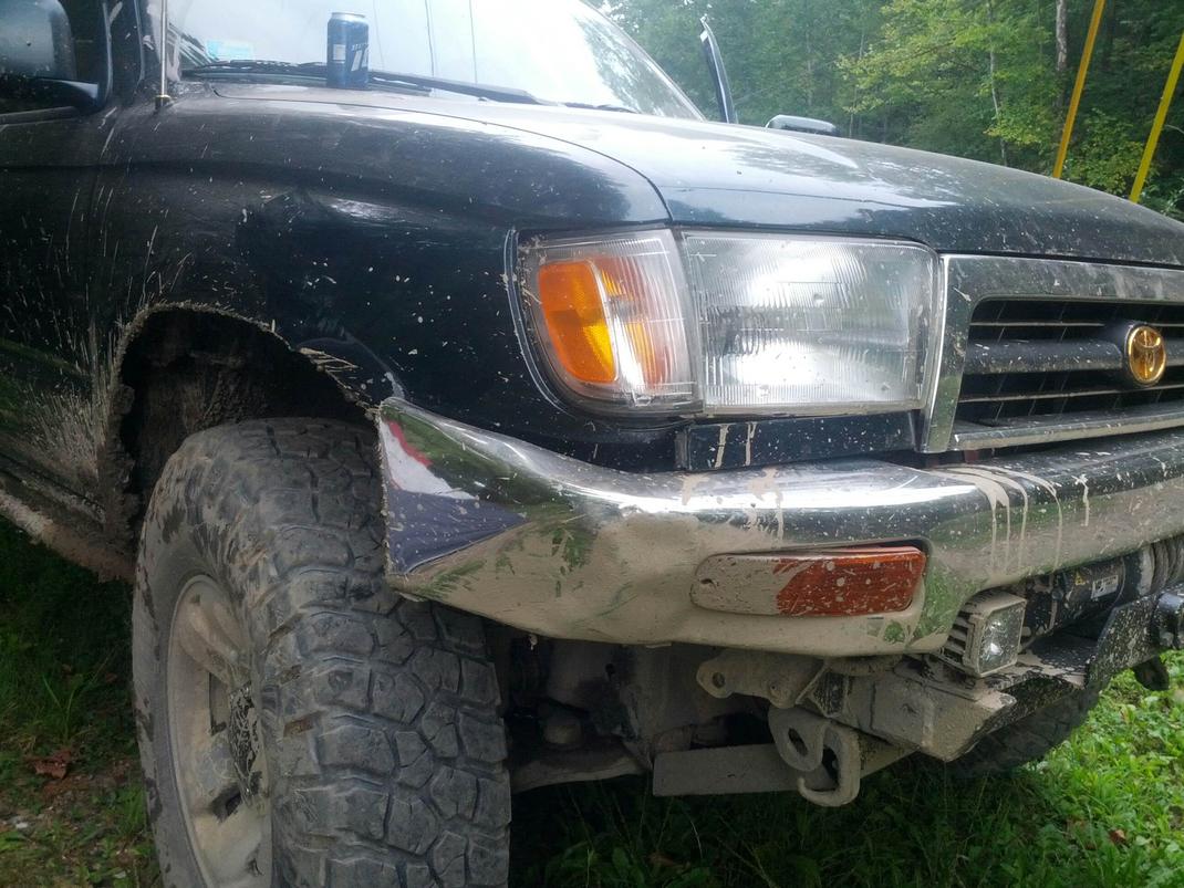

Got a nice little scratch on my front bumper and fender in the lower rock garden within the first 30min of being on the trails. The second day i broke a pass side CV on the ledge on the trail that leads to lions den and flattened out my alignment cam tabs.

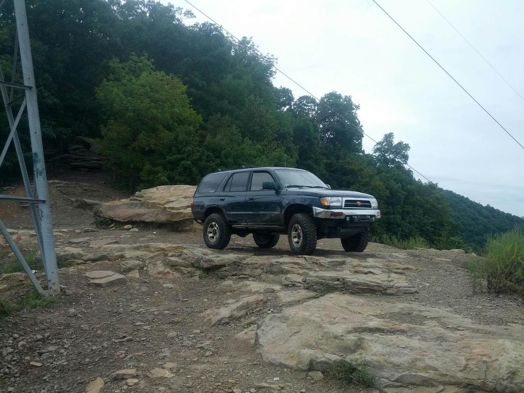

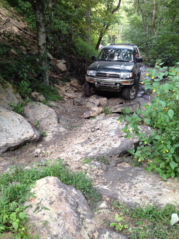

And now with some wheeling pics.

After my front bumper incident at Harlan plans to make a front tube bumper are in the works and should start coming together within the next couple of weeks. So far I'm drawing blanks on decent ways to mount the bumper with my modified front frame and winch mount.

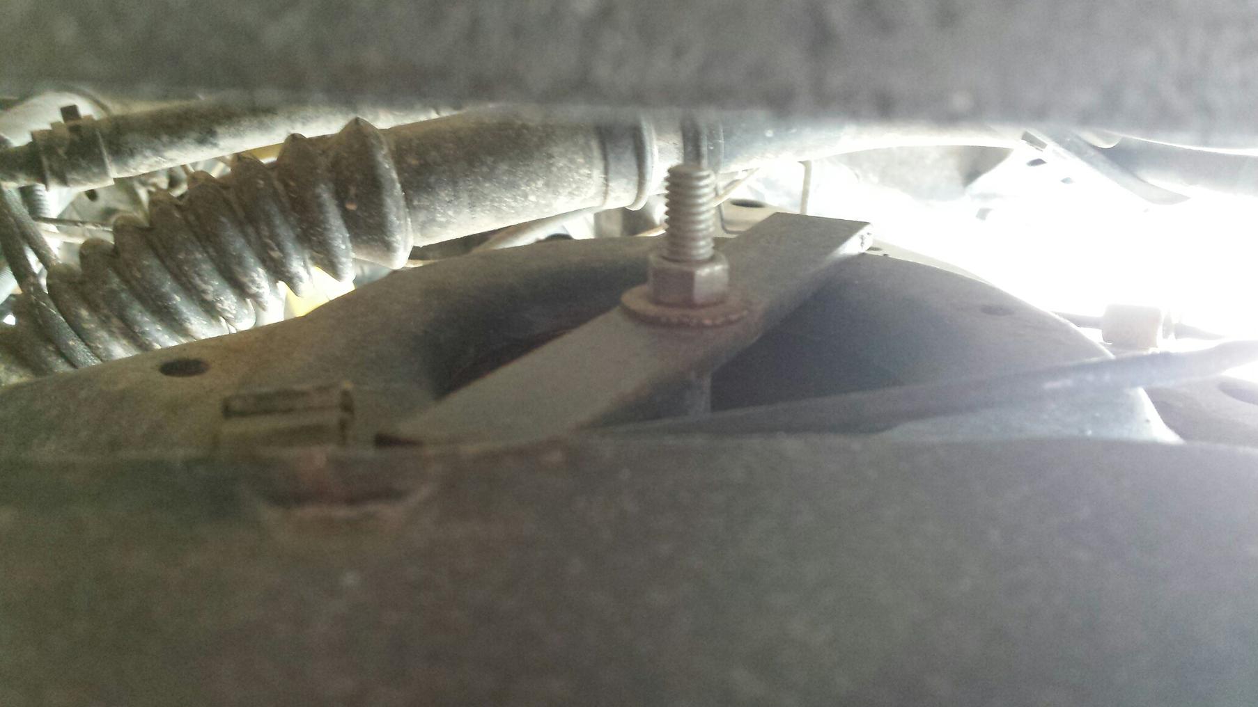

Could you explain your rear spring retainer setup and show your limit strap setup also? Interested in doing both things.
Sure. For the bumpstops I welded a 3/8"x3'' bolt to the inside of the factory bumpstop, using a piece of 1/4"x1"x3"with the hole drilled in the center to sit on top of the rear upper coil bucket allowing the bumpstop to bolt to. I also have a small piece bolted to the bottom coil bucket to keep the bottom of the spring seated.
The limiting straps are a copy of a few others here on the forum. The upper mount welded to the frame rail and the bottom mount bolted to the stock lower shock mount using a longer bolt.
I will get pics of both put up sometime tomorrow.
Here's a pic of how the upper bumpstop mounts up and my limiting strap set-up.
You'll have to put a couple washers between the shock and the strap mount on the bottom to keep them from interfering.
Sorry for the crappy cell pics
