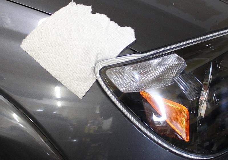

This squeak had me going for a while.
Edge of headlights rubbing on fender.
Bit of sandpaper fixed it.
