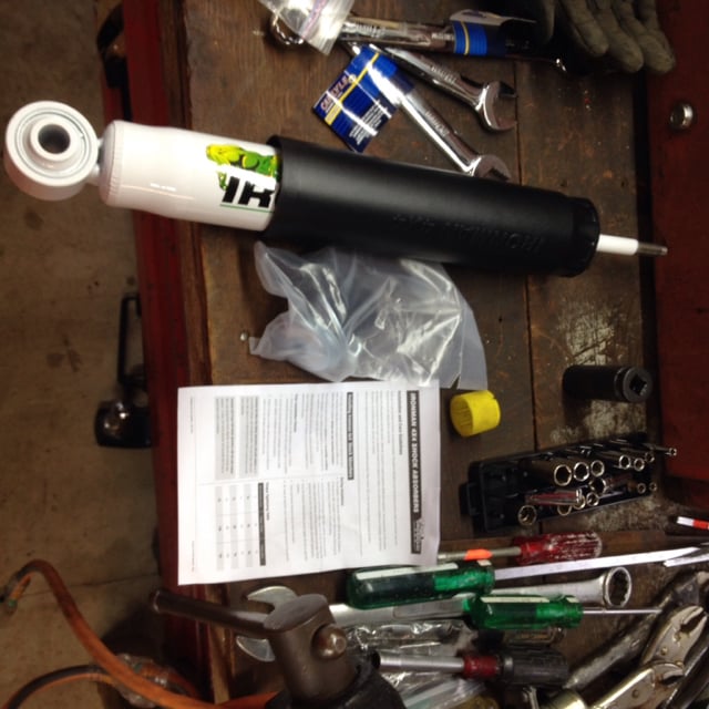

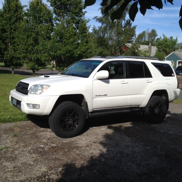

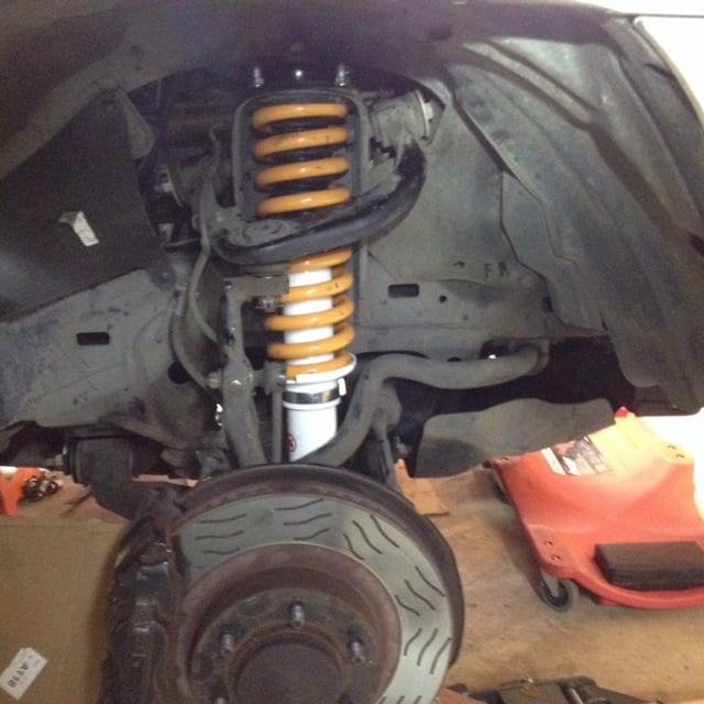

Ok update. Got my lift kit installed and I love it! The struts and shocks are dual valves so you get shock absorption both on the down and up movements! This kit came with great diagrams on the strut assembly! I went from a 36" in the front to a 38" in the front! The rear fenders sit
at 39" because I chose the heavier duty springs to account for extra weight I may as! I would recommend this kit to anyone looking for a good budget lift .

Yes I really like them! When I was putting the struts together I forgot about this and was having trouble compressing the spring since they ship them compressed. I forgot I had to extend the strut. One I figured it out, everything went quick!
