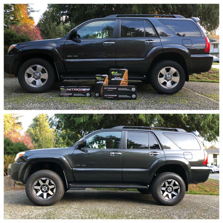

16 SR5.. I run the NITRO GAS 2" SUSPENSION KIT PERFORMANCE LOAD (0-660LBS) PART NUMBER: TOY065BKG.. gives a 2.5 lift in the front 3 in the rear. The green springs and red JBA UCA look great.. (I will get some picks soon!)
great ride, built solid no complaints

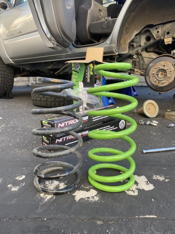

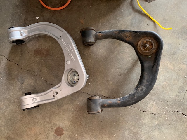

So, I too did the Ironman Nitro Gas 2" Comfort or Stock load setup with front and back shocks and coils. I'm super happy with the look and the ride. I got at least 3" out of them, but I think that's because I was still on the original shocks/coils. I also put new 2018 T4R wheels on which had a slightly taller than stock tire.
The only drawbacks, or heads-up, I'd put out there is that you might have to replace your CV axles if they're still original and you may want to look at upgrading your UCAs. I replaced one CV axle right away since it started oozing goop during the suspension install. I'll probably replace the other soon. I mention the UCAs because I've noticed that it doesn't drive as straight as it used to. I'm still on the OEM UCAs and yes, I got it aligned right after the suspension install, but they couldn't get the caster into normal spec. They said it's still safe and fine to drive, but won't feel the same. They're right, it doesn't feel the same. Feels like it wants to drift at freeway speeds. From what I'm reading, aftermarket UCAs will fix this. I'm considering the Ironman4x4 UCAs, but that's gonna be after I save a few bucks. Before/after pic attached.

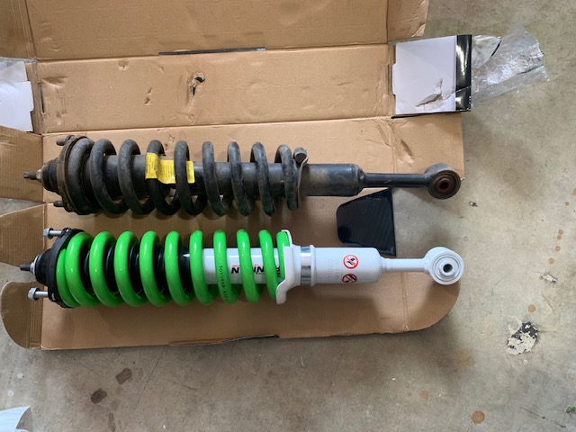

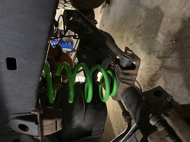

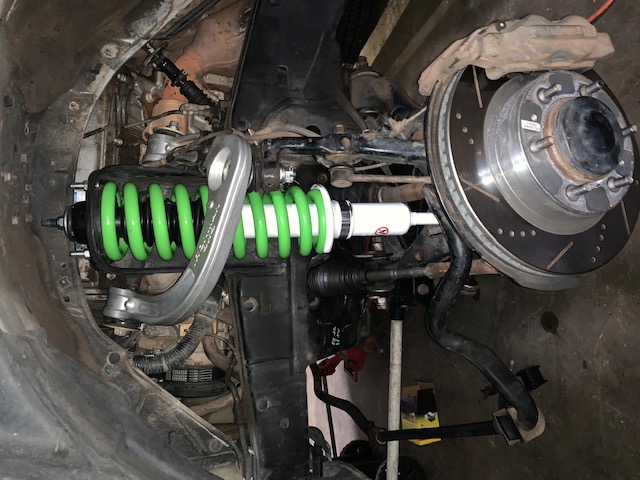

Here are more photos of the install ... If you're not going to install a metal bumper and winch, I suggest you go with the softer spring. The 0-660lbs spring is too stiff for a stock setup in the front.
I thought the 0-660lbs is the softer set up, the constant load is 660-and up isn't it?

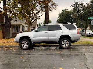

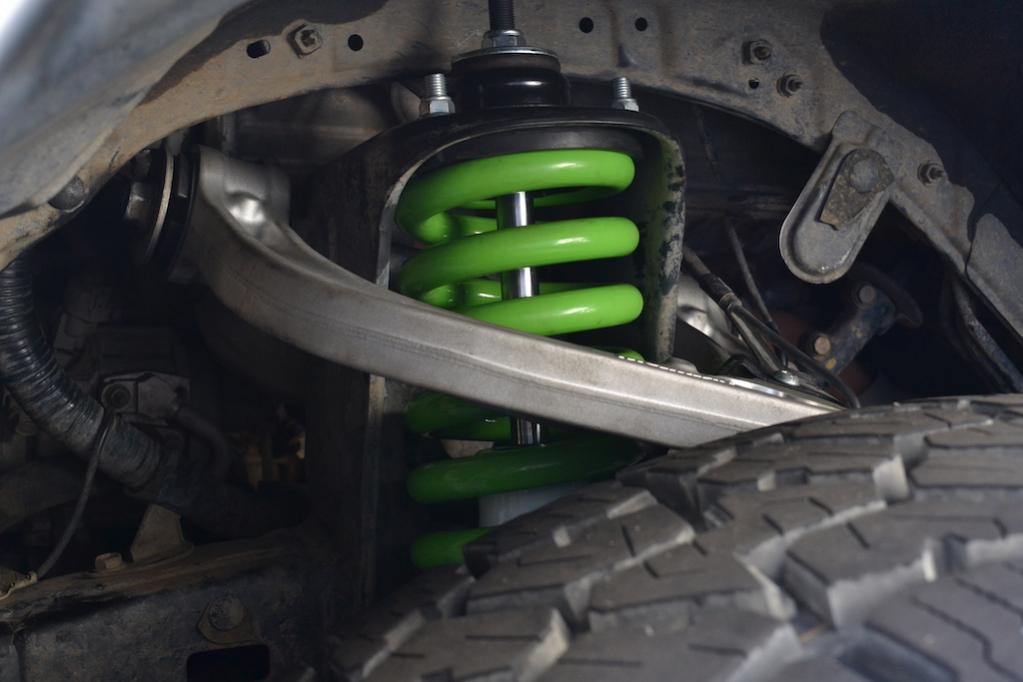

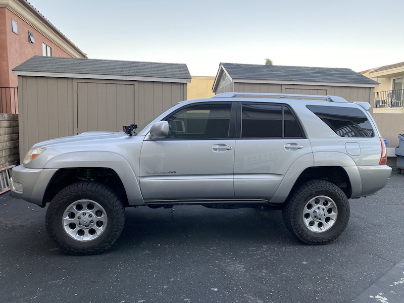

As the title states, I recently got the Ironman 4x4 Nitro Shocks, Performance lift springs (2.5 in front, 2 in rear) to level my '04 V8. Been on the truck for a few weeks and so far LOVING the ride. I have the forged UCAs too, and what a difference from the stock UCAs!
I had Bilstein 4600s for about 6 months with some soft rear springs and 1.5 inch spacers on the spring perches in the rear. This setup is much stiffer, yet rides like a cloud. I drive a windy (twists and turns, not air windy haha) road to work and back everyday. The new springs and shocks have improved the ride around turns so significantly that I am actually getting better fuel economy on the drive since I don't have to brake so much through corners and floor it back up hill.
As far as off-roading goes, the ride is so much softer (even than the Bilsteins, which I though rode really well already). The new UCAs allow better down-travel and articulation in the front - something I was suffering with on the old arms. I have a rutted out hill that I go watch sunset with the girlfriend on. With the stock UCAs, I was having all sorts of ATRAC input and ABS kicking goin up that hill. Now, the correct ball joint angle allows the front wheels to articulate down enough to completely eliminate the ATRAC kicks!
Happy to answer any questions! So far super pleased with the ride quality on and off-road.
