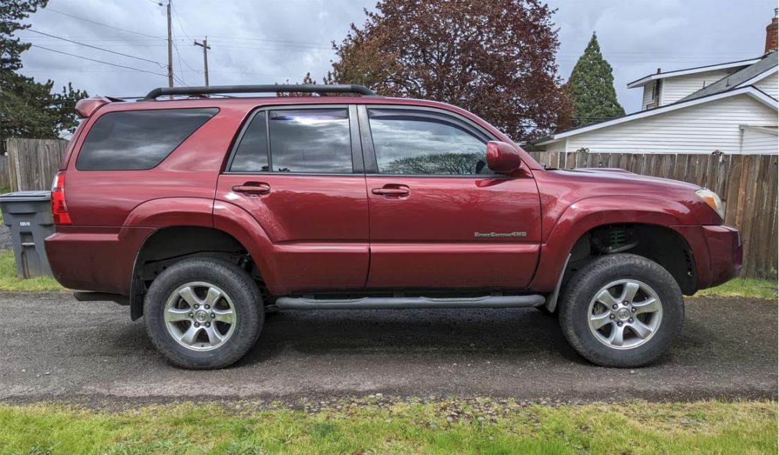

Just finished installing my stage 2 FCP kit. That wasn't too bad for this first timer. A second pair of hands is certainly helpful for this installation. I'm glad my son was available, especially for working on the front end components. Ironman has a great installation video using a GX460. It's very close, but left me with some questions that the folks at Ironman were able to walk me through with a phone call.
This is the 2.5/2 lift. I like the look, but definitely needs bigger tires now.

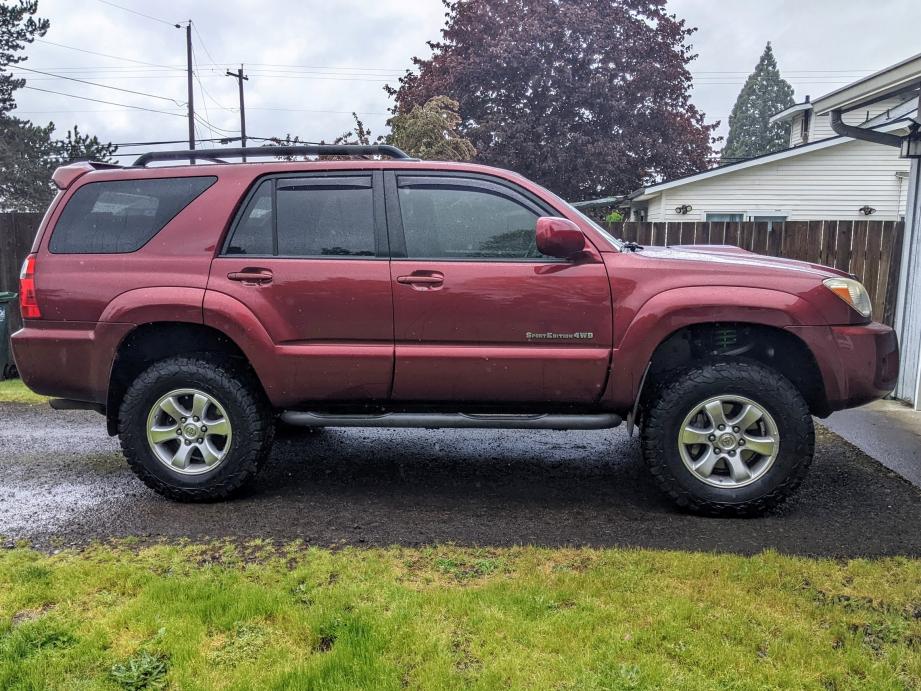

Decided on 275-70-17 KO2s. I was hoping to get away with stock wheels with no spacers, but I'm just touching the left UCA at full lock, so that's not going to work as is.
So far, I'm really liking the Ironman ride. The FCPs and comfort springs are very similar to the X-REAS for washboard roads, cornering, and stops, which is exactly what I wanted.
