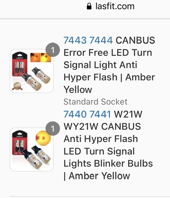

Installed the bulbs this afternoon. Turn the turn signal on to test and the worked great. Buttoned everything up and then turned the truck on and realized these dont turn on as side markers. They only operate as turn signals? In the PNW we have a lot of rainy days and so I normally drive with my DRL and Side Markers on.
Anyone know if this is just an issue for me, is this common knowledge that Im missing?
I've contacted Lasfit but we'll see what they say.

On my 2018 the LASFIT front turn signal bulbs are also ON as running lights. I also have the LASFIT side market bulbs.
You have a 2017?
What part numbers did you order?

Those look like the bulbs for the rear turn signals.

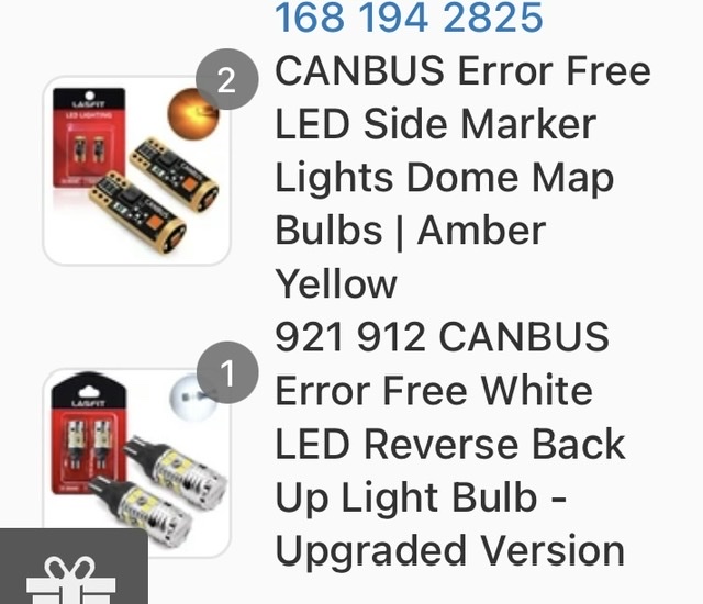

Here’s what I got. The turn signals are amber, (not flashback white/amber). Photos in order, front turns (7443A), rear turns (7440A), front side markers, rear backup.
