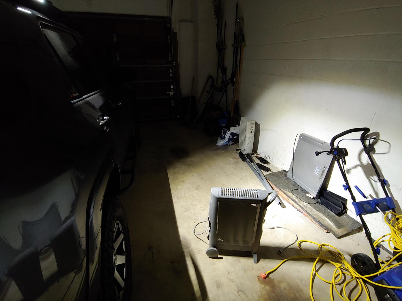

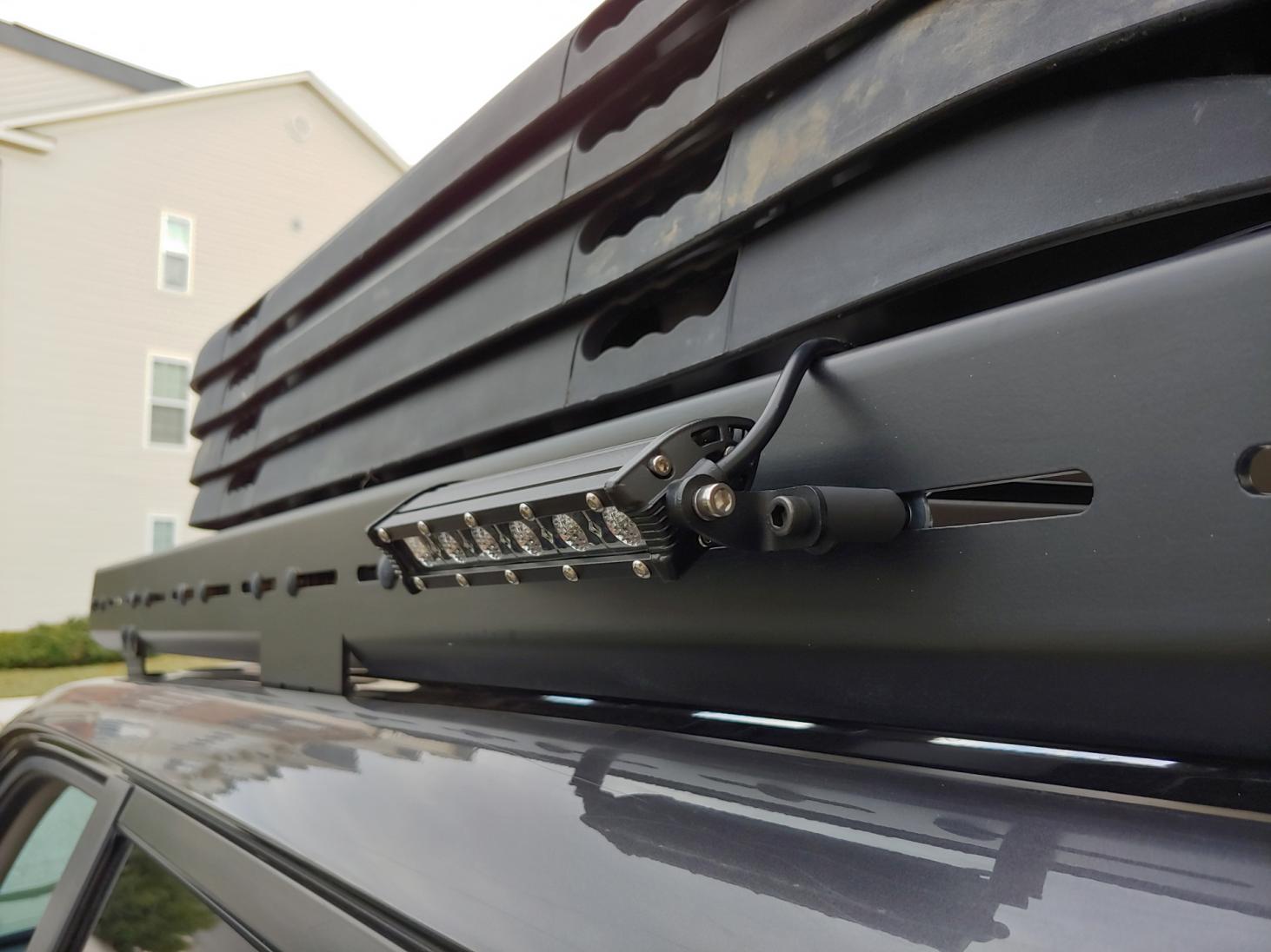

I got the side scene lights installed and wired up last night...

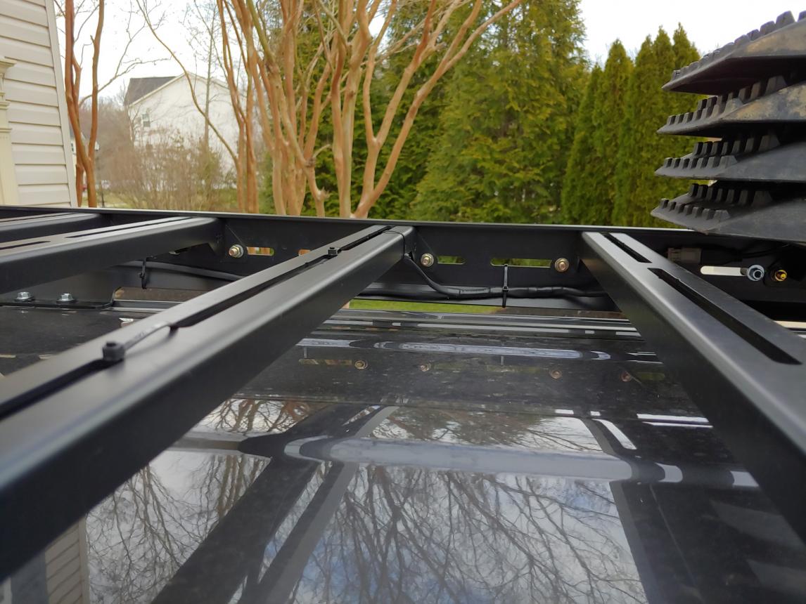

The lights are SuperBrightLED's 7" Slim light bars, flood optic. They are moved off the side of the rack via a 1" plastic spacer found at Lowes, and held to the rack by 1/4-20x1.5" bolts with a washer/lock washer/nut combo on the backside.

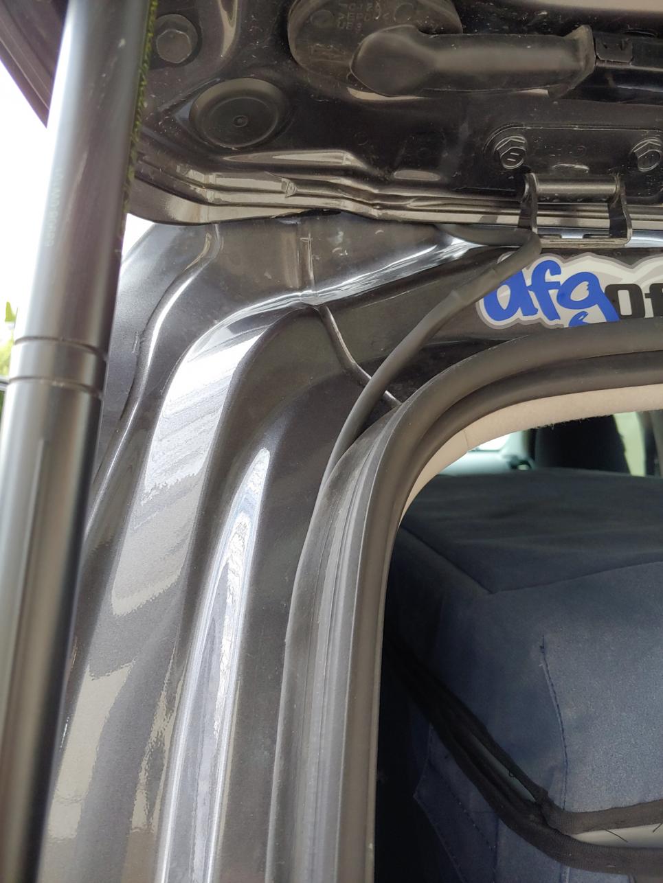

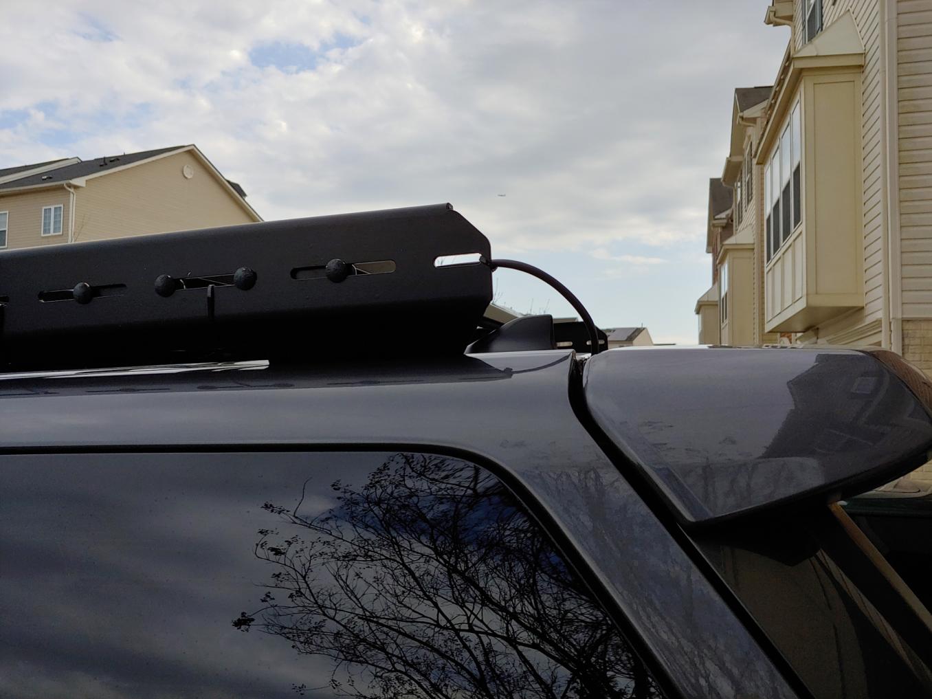

All wiring exposed to the outside world is wrapped in heatshrink, the Deutsch connectors are secured to the rack by 3M VHB and then the wiring is secured via zipties. Because these only draw about 1.7A combined, wiring consists of 18/2 from the switch to the connector pigtail on the drivers side, where it joins the wiring over the passenger side light. Wiring then follows the side rail to the back, through the gap under the spoiler and then down the drivers side of the weatherstripping for the hatch. Instead of poking a hole through the factory grommet I ran the wires down and utilized one of the taillight openings to pass the (flat) 18/2 wiring pair through. The foam that backs the taillights leaves plenty of room for this, and if I don't like the lights (or more realistically, add more and upgrade to 16/6 or 16/8 wiring), I haven't created an unnecessary hole in a water-prone location (the upper grommet).
Excuse the mess in the last photo, was utilizing my parents garage for this as the 4Runner doesn't come close to fitting in our garage
OH! I almost forgot, no additional noise at all.
