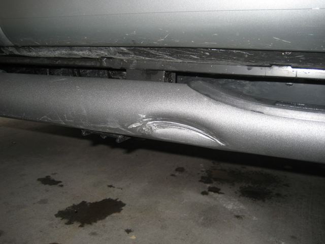

You might want to rethink tubular nerf bars if you plan to off-road. Mine didn't hold up well to a small rock last weekend. I'm going to get a set of shrockworks rock sliders one of these days.
wow that ball joint puller looks awesome, i had the fork looking one and after looking at my boots today, they are ****ED up. im so mad. where can i get replacements besides the stealer??? i dont plan on doing any offroading till i get them, so hopefully they will be okay in the mean time *crossed fingers*
